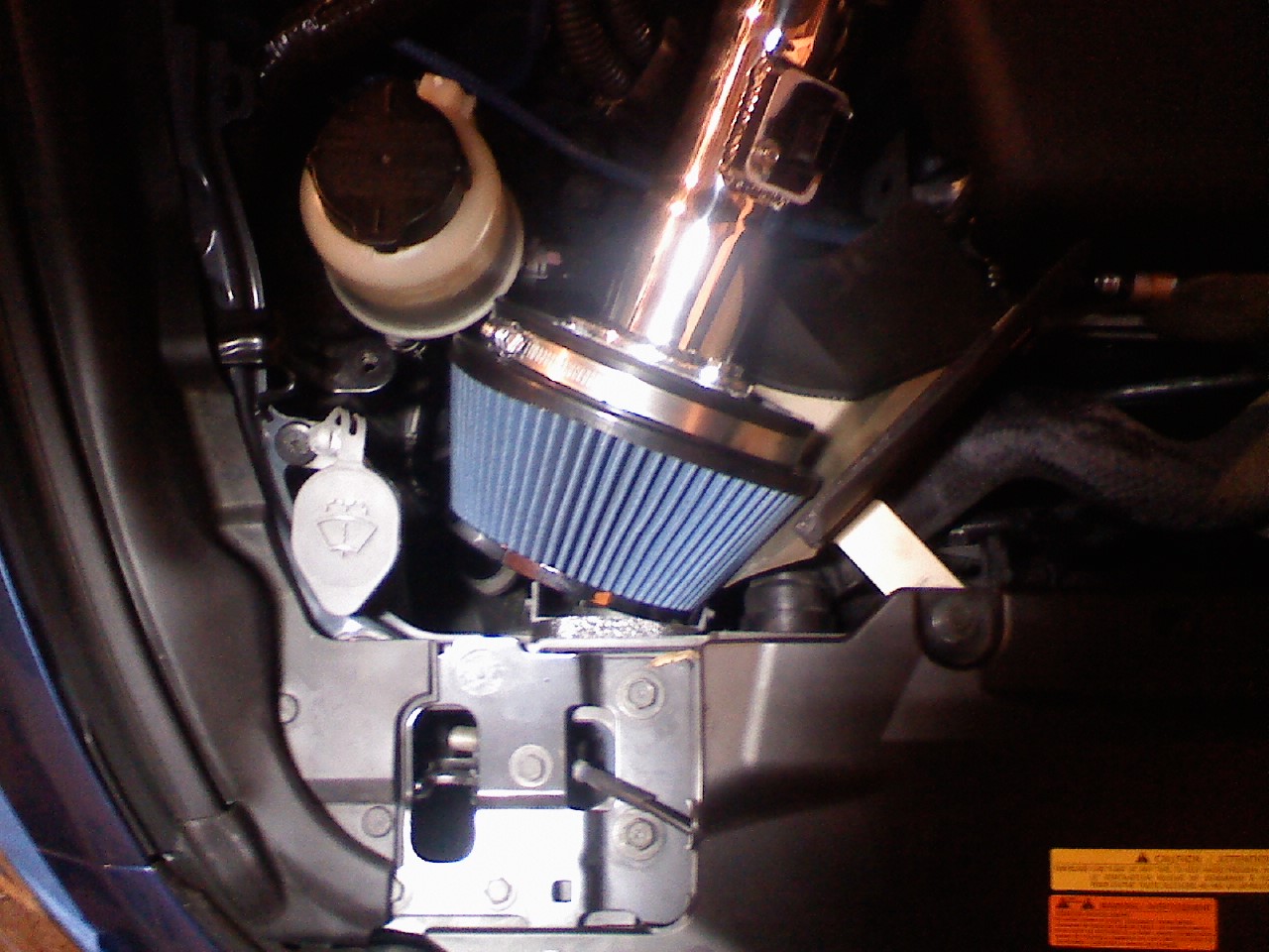

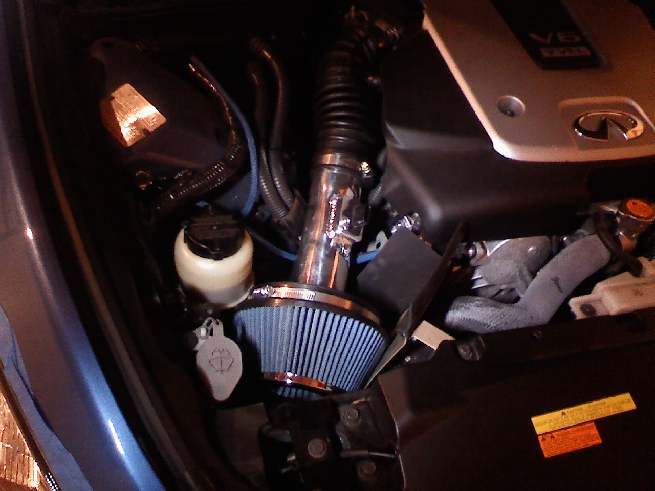

Hey guys, i knew what i was in for with the install, but just wondering if there was any update on this from the OP? I'm havin the same issues of course, and am trying some suggestion that you guys have made. I hafta go to Home Depot today to get some more bolts because i am actually missing one that should have came with the intakes. I'll just pick up some extra as well while im there.
I really dont see how the passenger side braket will attach to the filter. Gonna try removing the black mounting peice from the frame.
It seems so odd for this filter to fit, because i dont see how it can get down past and clear the power steering fluid bottle. >_< Any advice guys?
Attached Thumbnails JWT fitment-passsidefar.jpg   JWT fitment-passsideclose.jpg

Ahuja, I think you may have got the wrong side bracket on the passenger side.

The 2 brackets are of different length. I used the shorter one on passenger side and longer one on the driver side I think.

yea i used the short one on the passenger side. idk what it is but i never cd get the screw to go in the hole as shown in the pic.

It looks like you're very close in the first pic. Try taking off the black metal bracket from the frame, attaching it to the JWT bracket first. Then twist and turn the whole thing little by little to get it to go back onto the frame.
That's what I did, took that off, attached it to the JWT bracket first.
