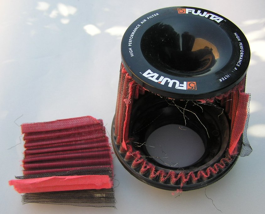

Intake concerns - testing
There may be another problem associated with the Fujita equipped cars. Lab flow testing is attached.
While the JWT and Stillen/KN filter restriction levels rise quickly as loading occurs, this is alarming.
Dynamics

Fujita Review
My mistake.
I thought that the lab test analysis of the Fujita product was appropriate with the understanding that this was a performance review.
Regards,
Dynamics
