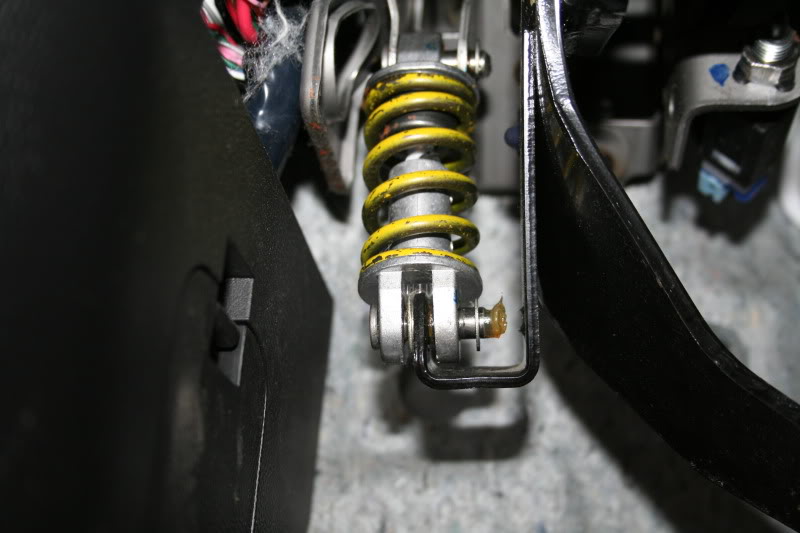

Here is the unaltered spring and assembly:

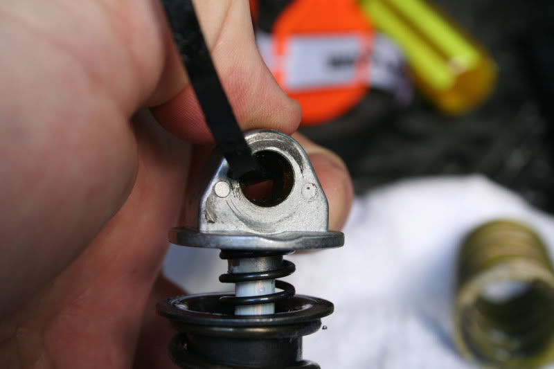

Here is what the assembly looks like un-compressed and without cable ties, and with the new spring in photo:
Now - simply pay careful attention to the items in the assembly, slip the bottom part off - remove old yellow spring - put new spring in place and get some more cable ties. I also slipped a cable tie into the top eyelet to indicate top and bottom. I attached a new cable tie to the assembly - it was a little fidgity to do - but I got it compressed and got it close to the 62 mm mark of the removed assembly. Again - I put an additional cable tie around the assembly to keep the top to bottom tie in place and keep it from slipping off the touch points.

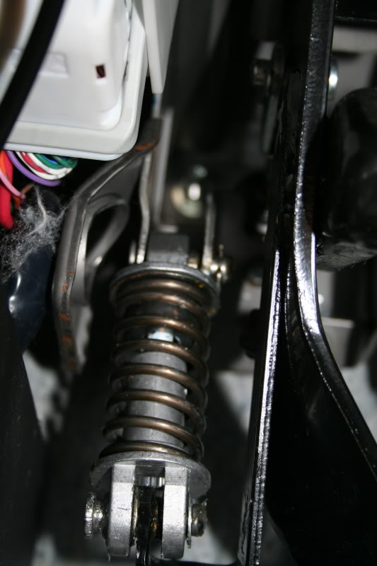

As I mentioned - I kept the top pin already on the car portion of the mount - and gently slid it to the left as far as I could without it dropping out:

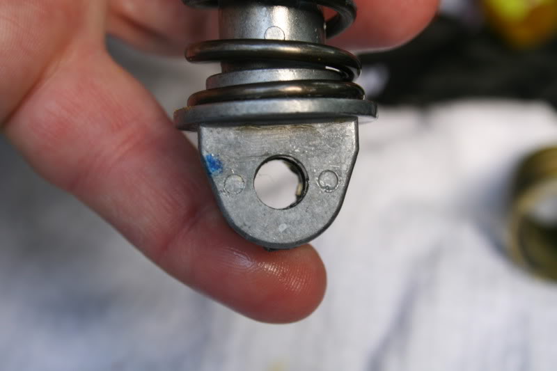

Then I put the assembly back in place and slipped the pin through the mount holes. As was mentioned elsewhere - there are two little 1/8 indent impressions in the assembly - on the top and bottom - here is what I mean:
These two little impressions need to go on the right side (closest to the clutch pedal) for re-installation. I didn't know what they were when I read about them - so I'm showing them here.

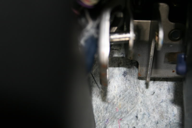

The bottom pin is a bugger to get started in the hole - as there is not much room on the left side to simply insert the pin into the car side of the mount. It fits - but just. the clutch pedal has some side to side play - you'll need to gently give it a little push to the right to get the pin started.
Once the pin is started through the first two holes, do yourself a favor and get a pair of channel lock pliers. Use the channel locks to compress the bottom pin into the hole. I tried for a half hour with needle nose pliers - but it was a waste of time. Got the channel locks out - and bam - the pin was in.

With regard to those 2 little dimples; I think that side of the clevis is a few thousands smaller than the other side. With it oriented to the right, subsequent pin removal was easy. Facing to the left, removal was more difficult.
