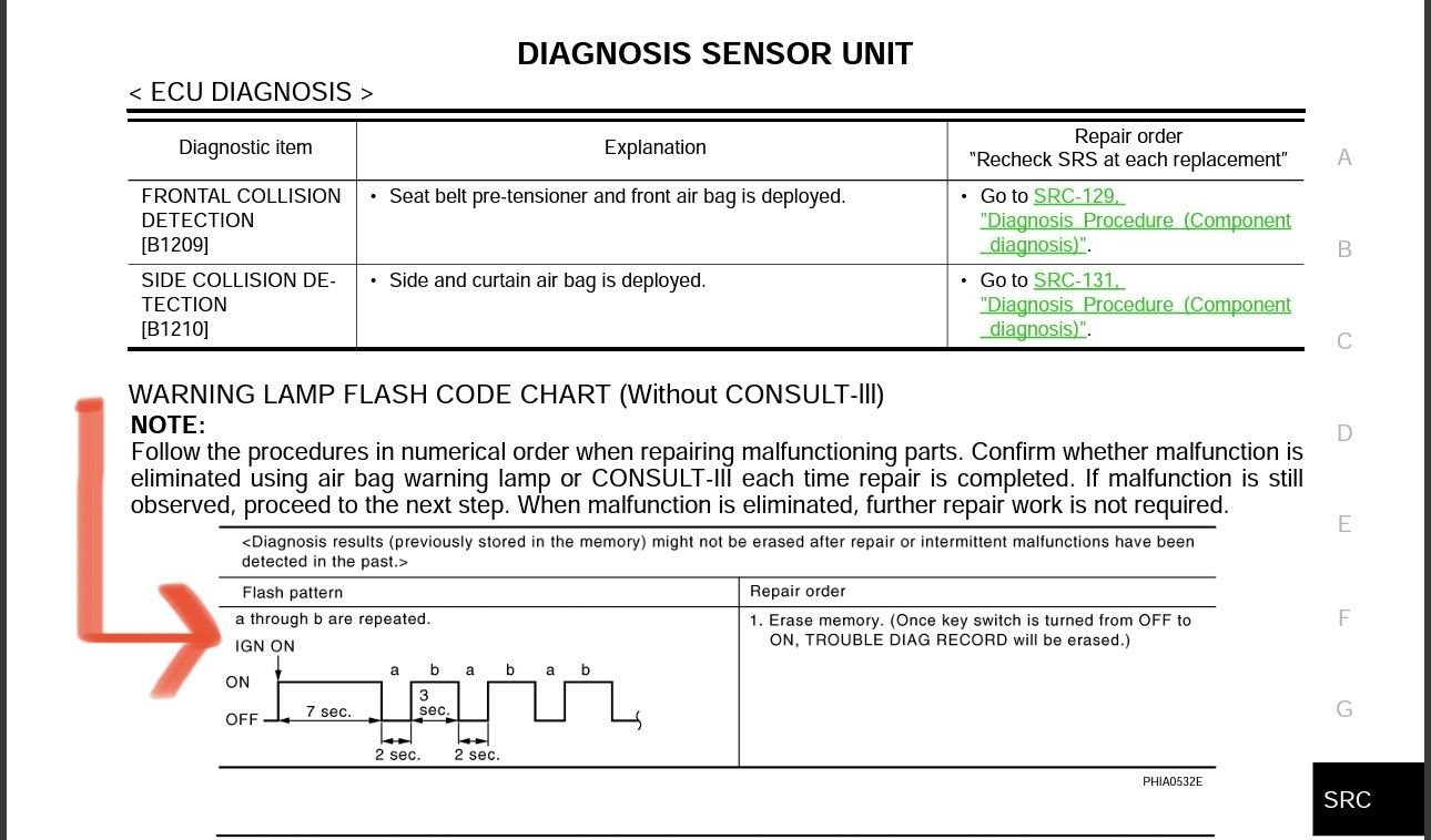

It appears that, somehow, you entered the self-diagnostic function. Unfortunately, "7 flashes" indicates a major malfunction within the control unit:
The ACU has capacitors that store a small charge to allow for airbag deployment in the event of battery damage.
My guess? With your low battery issue the jumper pack may have caused a power spike that shorted the SRS control unit ("ACU").
Wish there was better news but it appears that the ACU has to be replaced.
