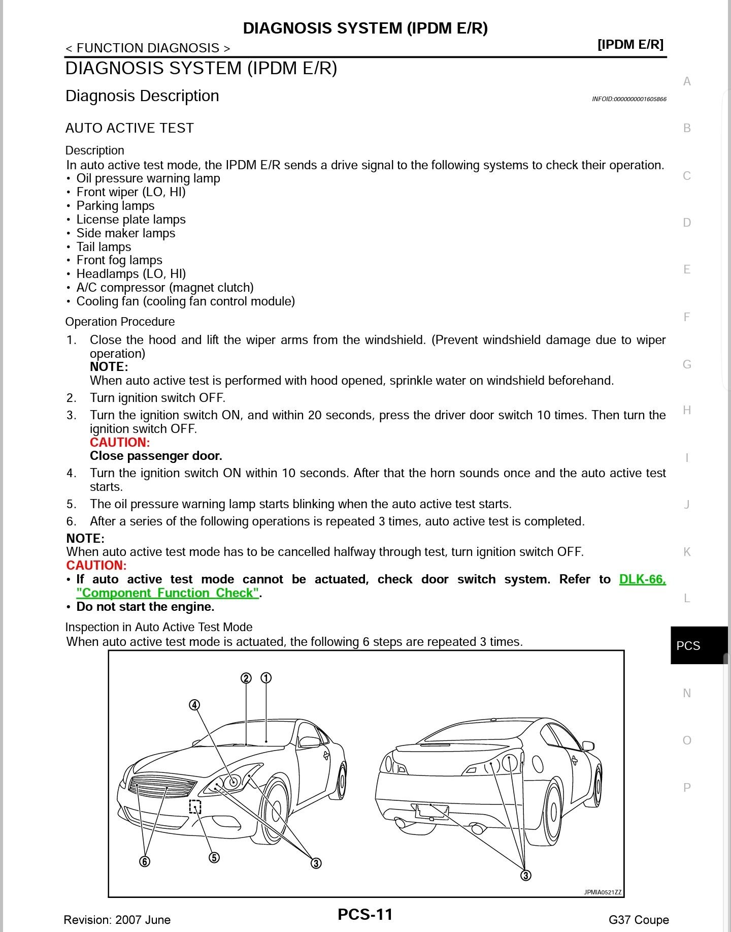

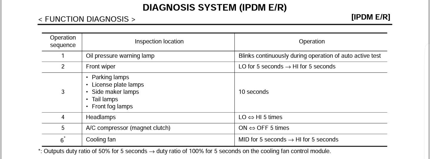

+1 for the fans. In my case both of my fans were barely running on LOW speed and never went up to HIGH speed. They should be running at high speed when the AC is on. My symptoms: AC only cooled down while at highway speed. Stop at a red light- no AC and coolant gauge went high. Replaced whole fan assembly with a set from a 370z off eBay and problem solved. By virtue of the fact that your AC works at highway speeds tells me your AC system is fine.
Also, you can run the IPDM/er self test which will test the fan motors (HI/LO) speeds:

Fan works at idle.
Ok, this is getting weird. I ran the test and apparently fan are good as well as the compressor clutch.
