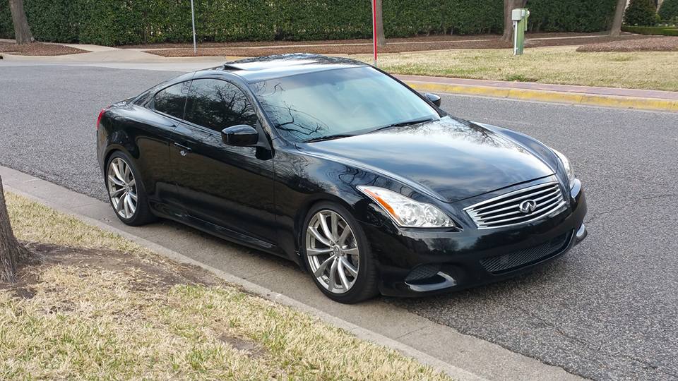

I have a incredibly loud rattle (sounds like rocks in a cooking pan) coming out from under my car only when Its cold. As soon as it warms up it stops. but it does come and go while warming up. I have no cats and I have full open exhaust so Its not the cats rattling. I did have it up on ramps this weekend but could not pinpoint where it was coming from because my car is lowered also. 08' Coupe/5AT 100k on the odometer. Any ideas! Thanks
