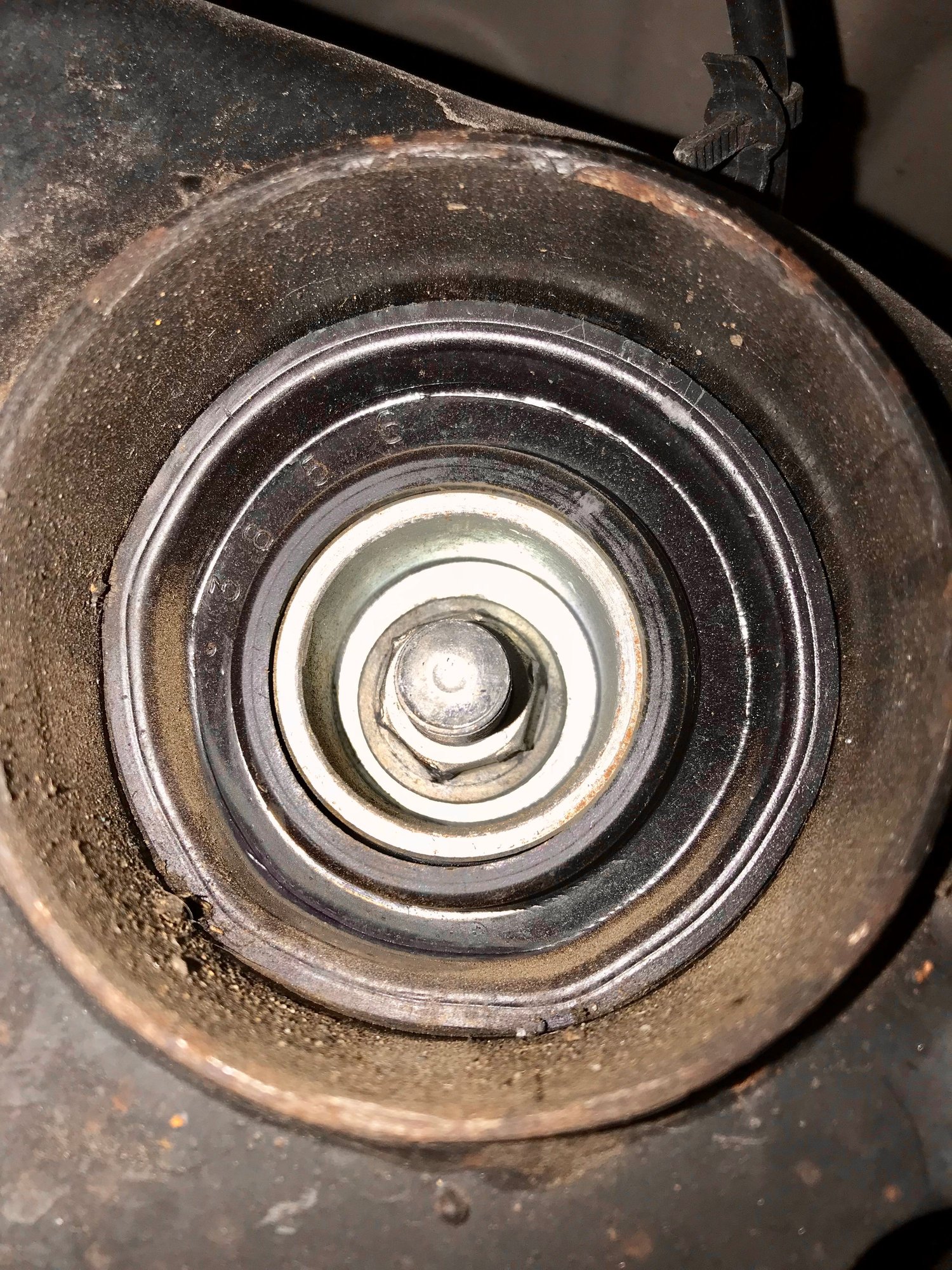

Old Oct 18, 2017 | 09:10 PM
Jonesmeister11's Avatar
Jonesmeister11
Joined: Mar 2014
Posts: 656
Likes: 51
From: Phoenix AZ
I think its the diff bushing.... again... look for the split in the diff bushing.

From: Phoenix AZ
Originally Posted by Kris9884
yeah, that could be it but it seems so minor. Didn't you already tackle that once before?
Yeah this is the second super blue diff bushing. I ordered z1’s polybushing. It’s coming in tomorrow. I’m having similar issues as I did before. I just didn’t dream I would be replacing it again. When taking off at a green light I get a lot of vibration.
