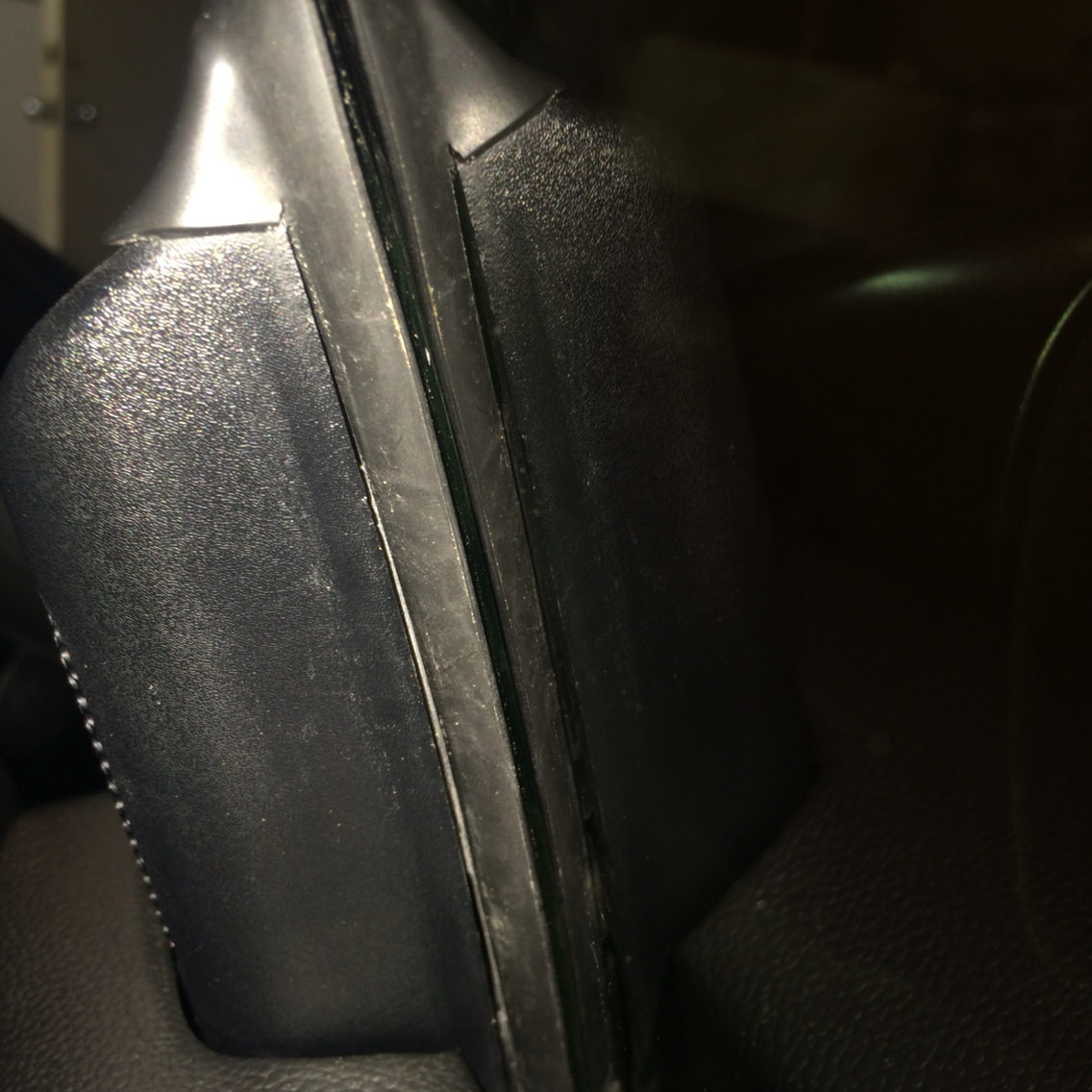

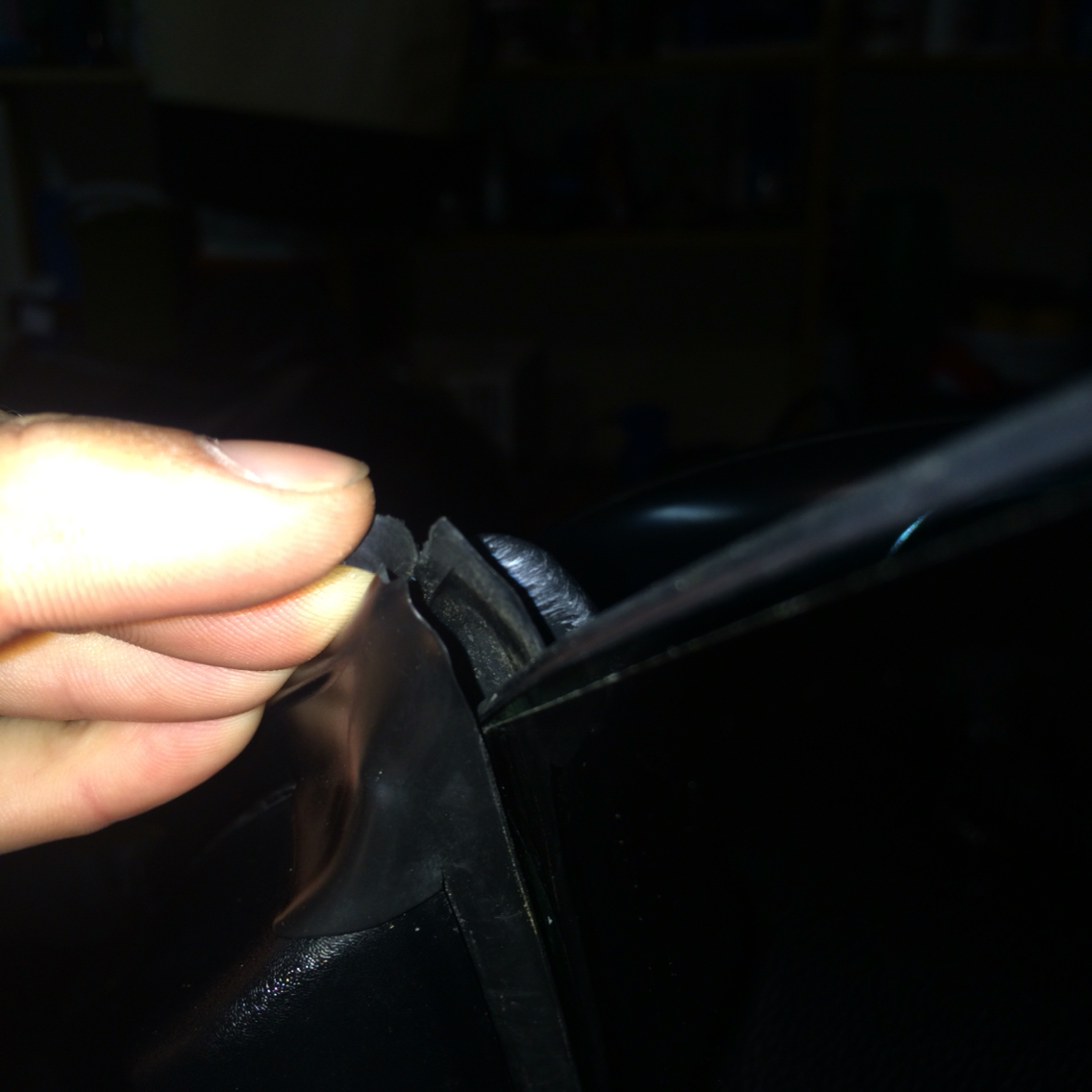

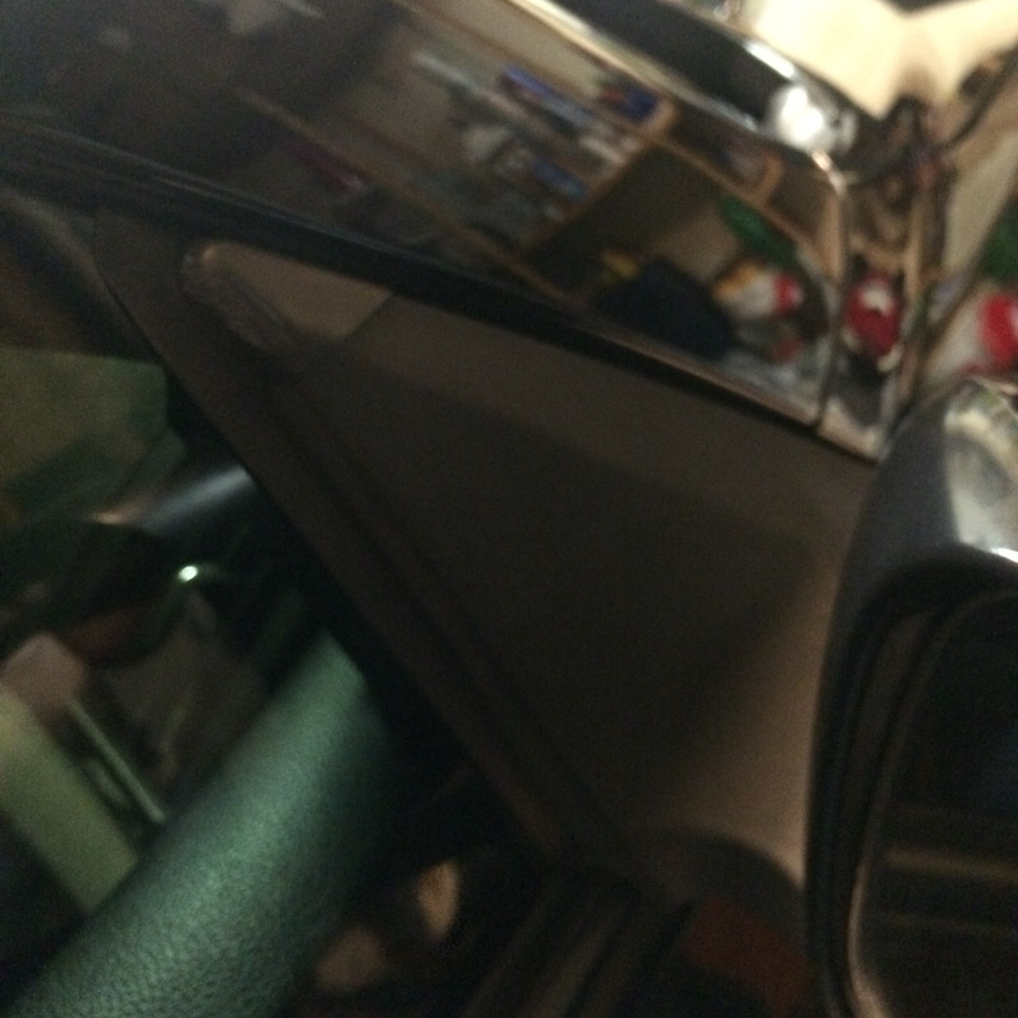

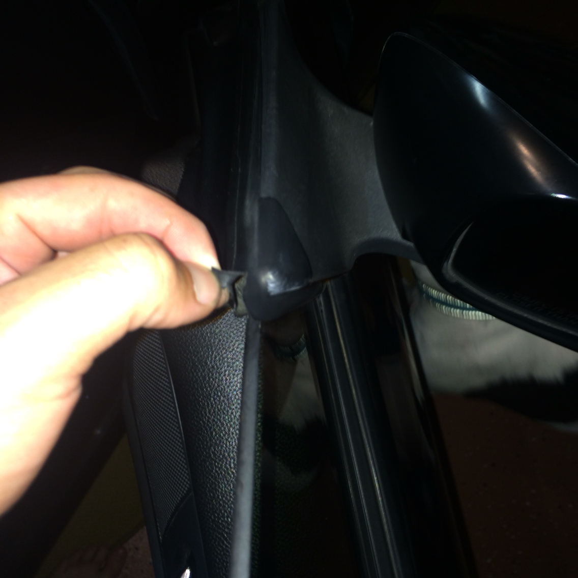

Sorry for the delay but here are the photos of the typical cause for the wind noise in the cabin.
The tiny little tear seems to be caused by the adjusting up and down when the door opens over time wearing down the rubber and splitting it. That's where the air is entering the cabin and because it's so small you only hear it when at cruising speed when the pressure is the strongest and able to get thru the tear.
IIRC, the part cost about $40 when I bought one a couple years ago for my Z. It looks like the same exact part on the G and the replacement process is pretty easy. You just take off the interior door panel, the speaker cover and unbolt the side mirror assembly to free the rubber seal. The only tedious part is getting the new one in there perfectly since there's a little piece with 2 bumps that slip into holes where the window rolls down. Just takes a skinny flat head, a flashlight and some patience.
