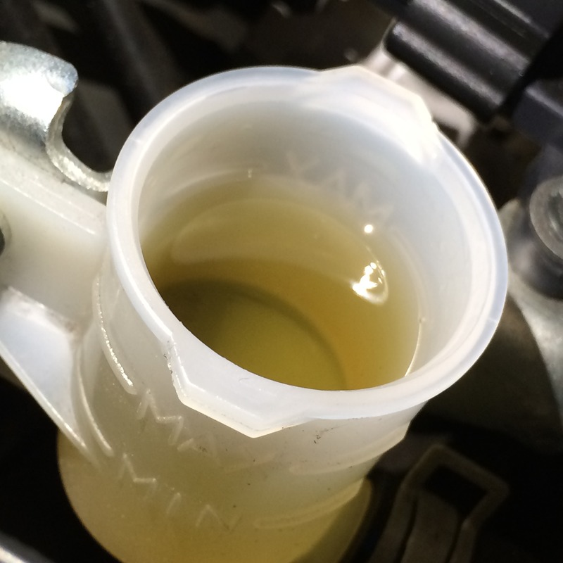

Originally Posted by vqsmile
I'm pretty darn sure that's what's going on there, but it is troubling when you say that the fluid level in the reservoir hasn't gone down at all. Are you absolutely positive about that?
Well, while I could possibly be getting a bit influenced by you (lol), it does look like it may have gotten a bit lower afterall. I remember fully topping it off to the max line (not going over it though) and when I pulled the cap off tonight, it did look ever so slightly lower. Here are some pictures:
If it is leaking within the hydraulic system, then it would not be going down; it could just be just bypassing the fluid. The only scenario I'd see for that would be if the master cylinder seals are shot, and are allowing fluid to squeak around them instead of building pressure toward the CSC.
When I read your comment about the MC seals, I took a closer look at the rubber of the MC near the clutch pedal and found this:
When my own CSC failed, I had it (and the MC) replaced by the dealership during the last few months of my Elite ext. warr., which is why I went ahead and replaced it with stock parts. If I were doing it myself and paying out of pocket, I'd seriously consider the aftermarket options.
Yeah, I'll do the heavy duty CSC from ZSpeed but is there something like a heavy duty MC aftermarket option available too? Or do most people just go OEM here?
