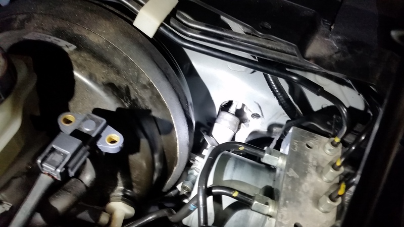

Okay guys, I need some serious help. I've been trying to remove the master cylinder from the car but have had no luck:
Notice in the picture that I've gotten it off the firewall (aside from the rod) but cannot get enough room to get it to come up. I followed the instructions from GPL4 here https://www.myg37.com/forums/vendor-...ce-review.html but still am unable to remove it from the car.
Can anyone who has actually removed the master cylinder help?

Did you loosen the ABS module and shift it to allow more room?

But yes, I did loosen the ABS module from the bottom and shifted it a bit. It provided some room for me to pull the MC out but not enough to take it all the way out. I'm not sure but maybe I'm not moving the module enough but it just seemed to not want to budge anymore and I'm afraid of forcing it and causing a kink in one of the lines somewhere so I stopped. There's just this black bracket that the module sits on top of that the MC hits and I cannot seem to get around it.

Take the pedal assy out, Its only one more bolt up top and will give you more room for the studs to clear the firewall. Turn the master upside down and it will come out above the ABS unit. There's one spot/position it will slide up out of there. If you still cannot manage to wiggle it out take the damper off the bottom with the master upside down in there, Then it will pop right out.
Another reason we use the 370Z master is that big damper is not on the bottom and they come right out.

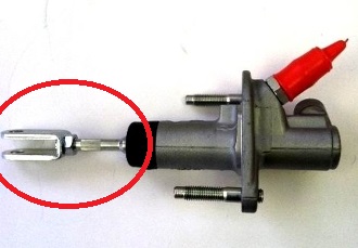

Zspeed, this damper rod you're referring to, is that the MC plunger rod as circled in the pic below? Held in place by just the rubber boot, correct?
Thanks for the removal info. I'm sure it'll come in handy some day. The surrounding design is truly retarded. The FSM tells you to disconnect and remove the hard lines from the ABS module.
@Slade, what did you use as a stud remover, 2 nuts tightened against one another?

No the big round nut looking thing on the bottom of the master cylinder that the one in the pic does not have. That's the damper.

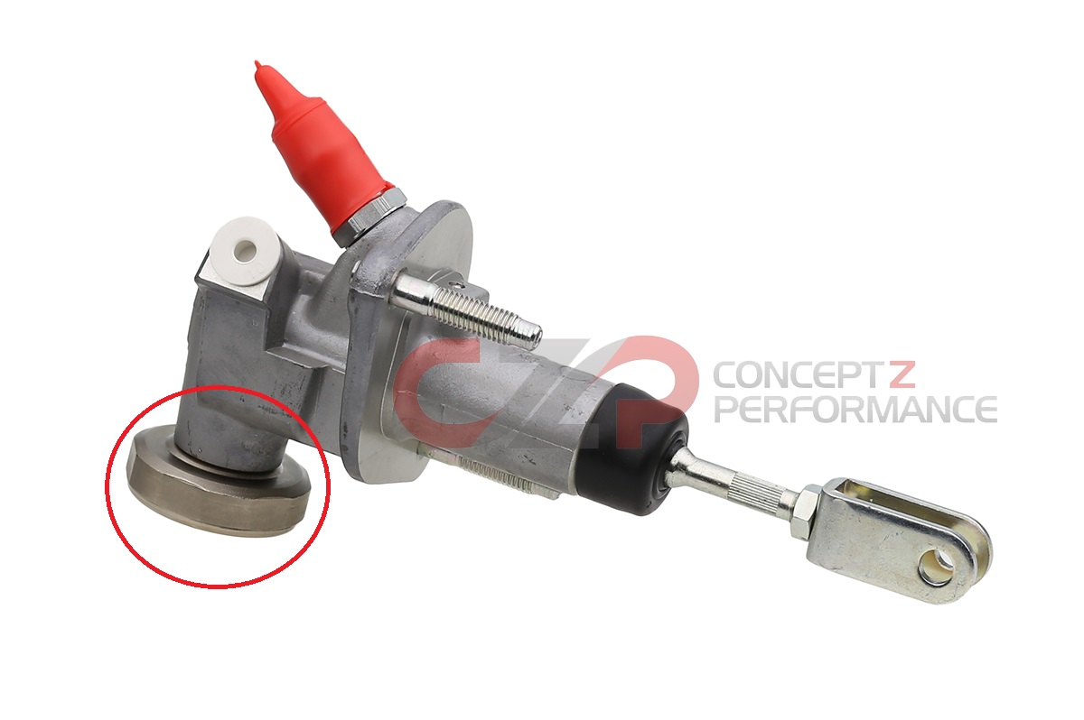

That's the damper.
Zspeed,
I think I understand what you're referring to.

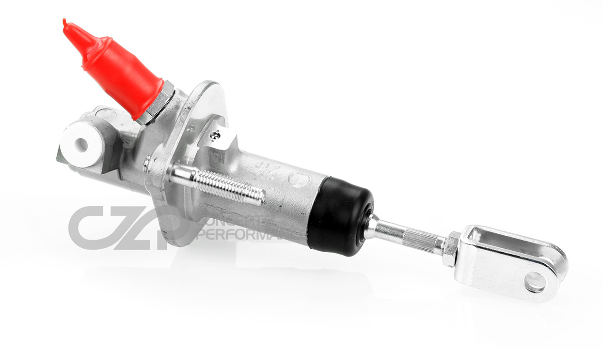

370Z CMC
G37 CMC
This damper piece you're referring to is circled in red in the 2nd pic, right? What purpose does this actually serve? Removal is just to unscrew counterclockwise with some channel locks or similar?
That 370Z version is the same part number as the older ('07-'08) G35 used (Nissan # 30610-JK00B) right?
I didn't know they were 100% compatible with the G37's since they changed them.
That would be good to know, as I have an extra BNIB one that I've been holding back from listing here for the G37 crowd.

Well guys, I tried...and I failed miserably!!! The space for movement down there was so tight that I could not maneuver the master around to flip it upside down as instructed. Removing the pedal definitely gave it more room and there was a point where it was coming out but the damper that ZSpeed talked about prevented it from having enough room to come out. If I was somehow able to flip it upside down and remove the damper then I think I would have gotten the master out but alas, the battle has been lost...
Anyways, in the end I just put everything back together and bled the system and the pedal feels nice and firm again (for now). I will be taking the car to a shop to do the work and given how much trouble it gave me, will gladly pay to have it done. lol

Yes the 370Z and early G35 sedan 07-08 master is a direct fit into the G37, just deletes the damper on the bottom of the G37 master, all the damper is is a plate with 2 rubber seals on either side to dampen "any" feel the clutch had without it.
