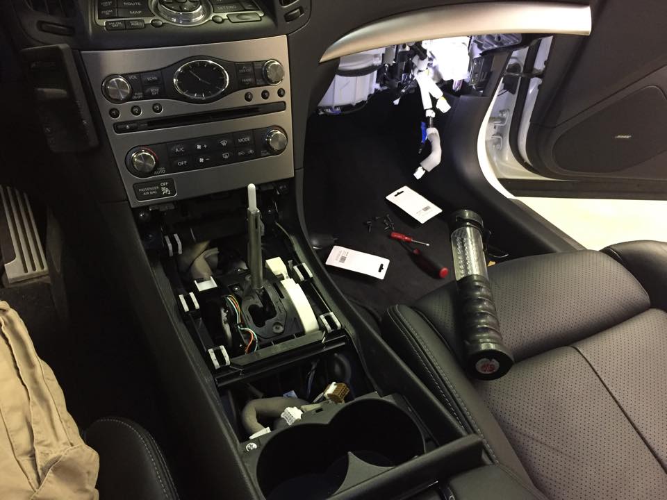

Did this last night to my 2013XS Sedan. Works like a charm. I love having the best of both worlds. RWD / AWD / and / or being able to fully disable VDC whenever I want.
I also put the two switches in my glove box to be a bit more stealthy.
Attached Thumbnails Turning off awd in G37x coupe-11117537_10152690754121822_2030484940_n.jpg   Turning off awd in G37x coupe-11149134_10152690872911822_2093675006_n.jpg

Just checking couldn't we just unplug the yaw controller in the center console?
And we still could do burnouts cause of the brake light switch.

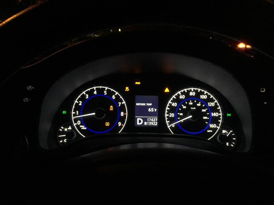

This DYI doesn't do it for me. I tried to follow steps listed on here. But after splicing the orange cable and connecting two wires to a switch. I was able to get the car in RWD mode but not back to AWD. The AWD light is ON all the time now.

you have to cycle power (turn car off and back on with circuit connected to re-engage AWD).
if that does not work, make sure the wiring is good and the switch is not defective

we have an electronically controlled AWD system. when you do this mod a fault is detected in the AWD system and it is disabled. but the front drivetrain is still mechanically connected to the transmission through the transfer case and so it still rotates, but no torque is sent. so . . . this means that you couldn't use this mod to run a staggered setup outside the AWD system tolerances or go on an RWD dyno.
