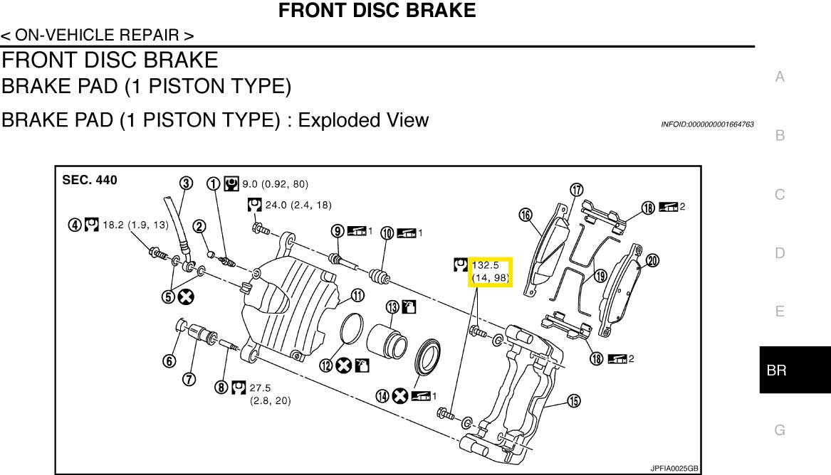

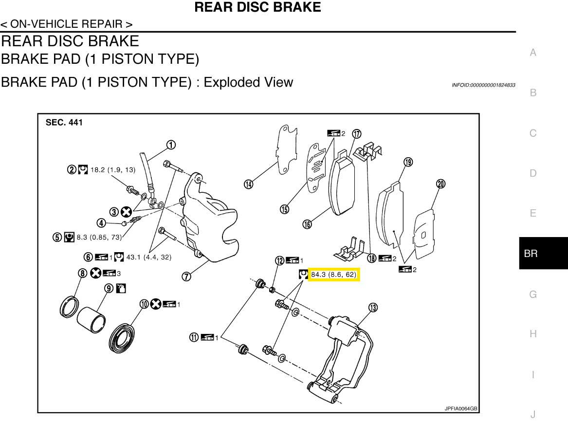

if anyone is bored enough..
see if you can find the torque specs for the caliper mounting bolts for a G37S
only thing I could find is the two bolts on each caliper that hold the caliper halves together. not the bolts that actually hold the calipers to the car
they mention "torque to spec" or whatever when they mention the caliper mounting bolts, but don't show the actual number
winner gets an E-cookie and maybe some nudie pictures of finagle69 if he's nice enough to donate

looks 98 front 62 rear (ft-lb)

I don't need any Nudz.... but This is what I am using to get my numbers...
I know they are for the non sport brakes, but the sport brakes do not have that extra bracket. So I think it would be safe to assume that you would use the same torque for the bolts that attach the sport bake calipers to the knuckle as the bracket for the non sport bakes.
