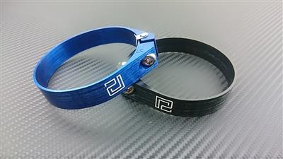

There's always ongoing discussion here about the heater hose connector, which is a project I finally took on a couple months ago. One of my take-a-ways from that topic is that you should be using the OEM spring clamps for rubber hoses that expand and contract because of hot coolant fluid. Constant tension clamps, not worm clamps. It makes sense.
That said, I'm actually using a P2M clamp on my upper radiator hose into the radiator, because it looks cool.
I mean, better than a worm clamp, but not constant tension. However, it's been been there for 7 years and no leaks, so...
