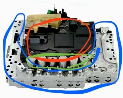

as far as I know you would still need to have the new TCM programmed since it is tied to the VIN info on the ECU. You will not have to reprogram anything so long as you continue using your current TCM. Most people probably are not going to sell you a valve body and TCM separately.
Red is the TCM. Green are the solenoids. Blue is the valve body itself.
Hopefully this helps. To reiterate though, are you sure that the issues you’re having are being caused by the valve body? With the mileage on your car it’s not uncommon for things like the torque converter, clutches, etc to start failing. Especially if the previous owner drove it hard and listened to Infiniti and never changed the fluid. Just trying to save you the headache.
