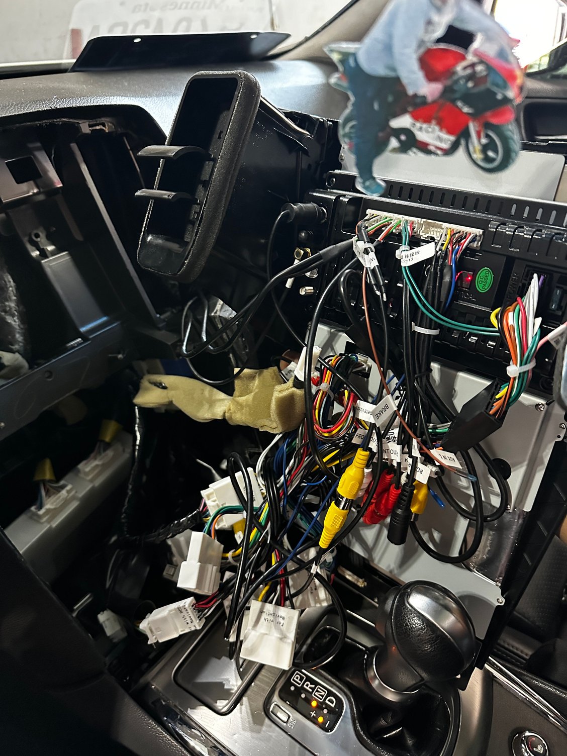

thanks for both replying back! This how it currently looks in the back on the unit and yes those
2 yellow connectors are connected. I have 2 cable that I don’t remember what it did (that might be the 2 problems lol) that the manufacturer for the unit didn’t provide connectors for as they said doesn’t need to be connected.

My God! Is that a cluster buck of spaghetti wires....
One BIG ISSUE I see: NEVER work on electronic devices with the battery connected. I know it is easier to troubleshoot, but leaving the battery connected while fiddling with wires is a disaster waiting to happen. Based on that, you will definitely need to check ALL of your fuses.
OK, so it appears that the UMAC amp is connected properly. If those issues still persist then the issue points to that thing and/ or the missing (not needed (?)) harness(es). I can almost guarantee that, somewhere in that mess of wires, the two (2) AV COM (LCD/AMP) circuits are not connected properly.
At this point, I would entirely remove this thing and put all of the OEM pieces back in. Reconnect the battery and see if the car returns to normal. If it does, then you can proceed with the re-install. If it does NOT then you have a separate issue lurking.
I wish I could be of better help but this requires more of a "hands on" diagnosis.

Thanks for the advice! When you say “I can almost guarantee that, somewhere in that mess of wires, the two (2) AV COM (LCD/AMP) circuits are not connected properly”. What wires or connections would that be. And I also did install that screen with my battery still connected because I previously had a 300 and I had installed the same screen in and didn’t have any issues with it and the car didn’t freak out so I thought there was going to be a rainbow at the end of this install as well. I was definitely thinking about reverting back to OEM just to see what the issue was but just didn’t make my way around to do so but most likely going to attempt to do it this evening and if not sooner then later because I hate having any issues with my vehicles. Also what fuses need to be checked pertaining the cluster because I seen a forum a while back and I did look at the meter fuse that had the 10 amp and luckily that was totally fine even put a new one just to play it safe.

To clarify, this car uses several different LAN's to operate the various bells, whistles, features, and "run" the car. CANBUS, AV COM, K-Line, and serial links all communicate with each other to some degree.
In this case, based on what I can determine, the two (2) AV COM lines (AMP->LCD & LCD->AMP) appear to be be connected. I am assuming that the two (2) (separate) AV COM lines (AMP->METER & METER->AMP) are also connected which is why the cluster illuminates and the gauges work- for the most part. In order for that AMP/LCD network to function, it requires information from the other networks. If something in that Chinese harness is not connected properly, then the AMP can not get the info it needs to turn ON the LCD and display the information.
Again, at this point you have two (2) options as I see it:
1) run the gauge cluster self-test and see if the LCD responds accordingly
or,
2) Revert back to OEM and see if everything returns to normal.
If you are active on that facebook nonsense you may want to search there for some input.
I do not think you have a fuse issue as everything appears to power up. My concern here is that a power surge, or spike, could have "fried" a module or something. Again, we won't know until you go back to OEM.
