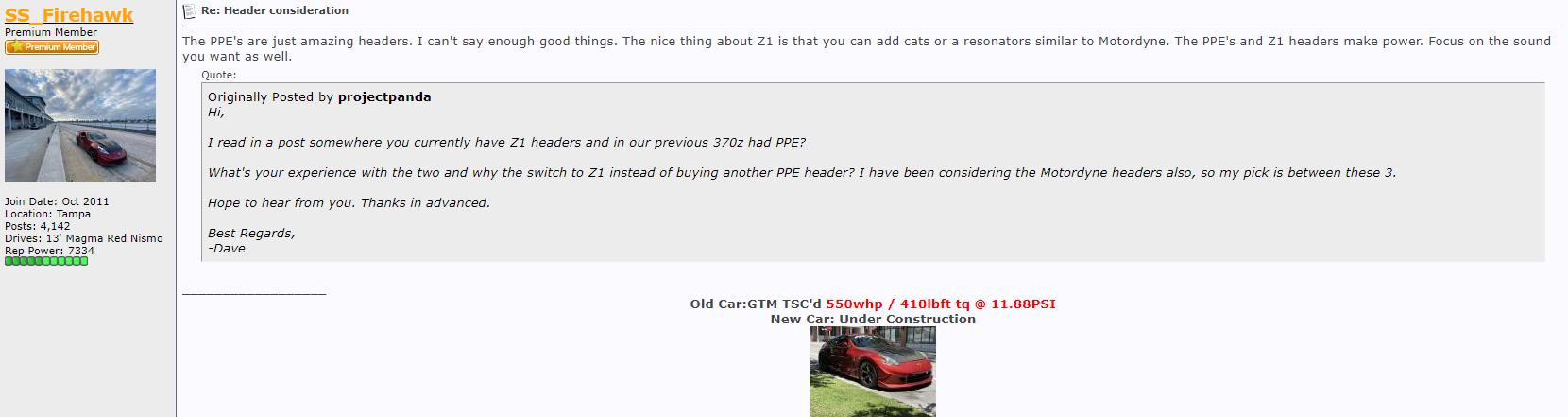

This thread post off G35Driver is a really good comparison of shorties vs longtube
Guy compares PPE's design of stepped and non-stepped designed vs momentum headers with Motordyne art pipes (z1 headers)
The DE seem to like non-stepped design. The HR/VHR are a stepped design.
He makes 21 whp and 13wtq peak gains over the shorties.
I was also at one point considering PPE headers or Z1 headers and I asked this forum member over at The370z.com since he's ran both.

https://g35driver.com/forums/intake-...ml#post6429229
