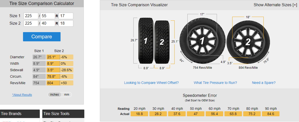

Enkei Lusso wheels (18") were put on with Hankook Tires (Ventus V2 225/40/18) and new brakes, calipers, rotors. While the wheels in themselves obviously look better than the old factory ones, I am quite disappointed by the amount of space in the wheel well now, between the tires and the fenders. It seems that 20" wheels would have filled out the space in the wheel wells more. The shop told me that they could do a drop with coils to close some of that gap between the tops of the wheels and the fenders, but that does not solve the problem of the gap between the sides of the wheels and the fenders. I fell short of the look that I was at least trying to go with (last picture attached)....
You have the wrong tire size for our car. Did you choose the size or the shop? Your overall diameter is 6% smaller than what you had on there, so your speedometer is wrong as well. Factory for the G37XS sedan is 225/50/18, I would try and work with the shop to get you into the proper sized tires and then see how you feel.
Epiphany, the shop gave me four tire options to choose from, and that is the one that I chose (based on style). I actually do not have have a G37XS, just a G37X. Would it still be the wrong size for the X?

As much I am unhappy with it, it's just not my style to publicly throw out the name of a business. Based on Epiphany's reply, I assume I needed 225/50/18 tires, rather than the 225/40/18 ones that I got? But would getting the 225/50/18s have actually closed the gaps between the tires and the fenders? There is over 4 inches of space in those gaps right now, and it seems that I would have needed a bigger wheel to close that space (such as a 20" wheel).

You throw out the name of a business whenever you write a bad Google review. Yes you needed 225/50/18, and yes they will have helped closed the gap some, and you drove home safe so why wouldn't it be safe to drive back to the store? According to the pic from the other post, you added over an inch and a half to the wheel gap by getting the wrong size tires.
