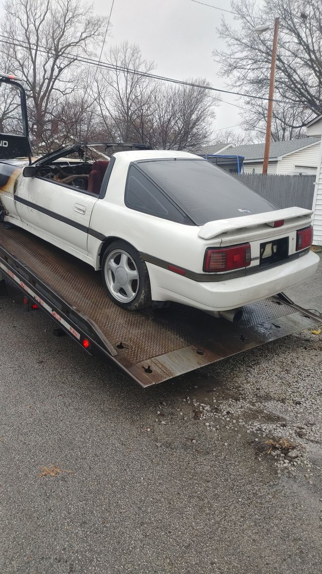

I just bought a 2011 G37X to replace my 87 Supra than burnt up.

The supra
