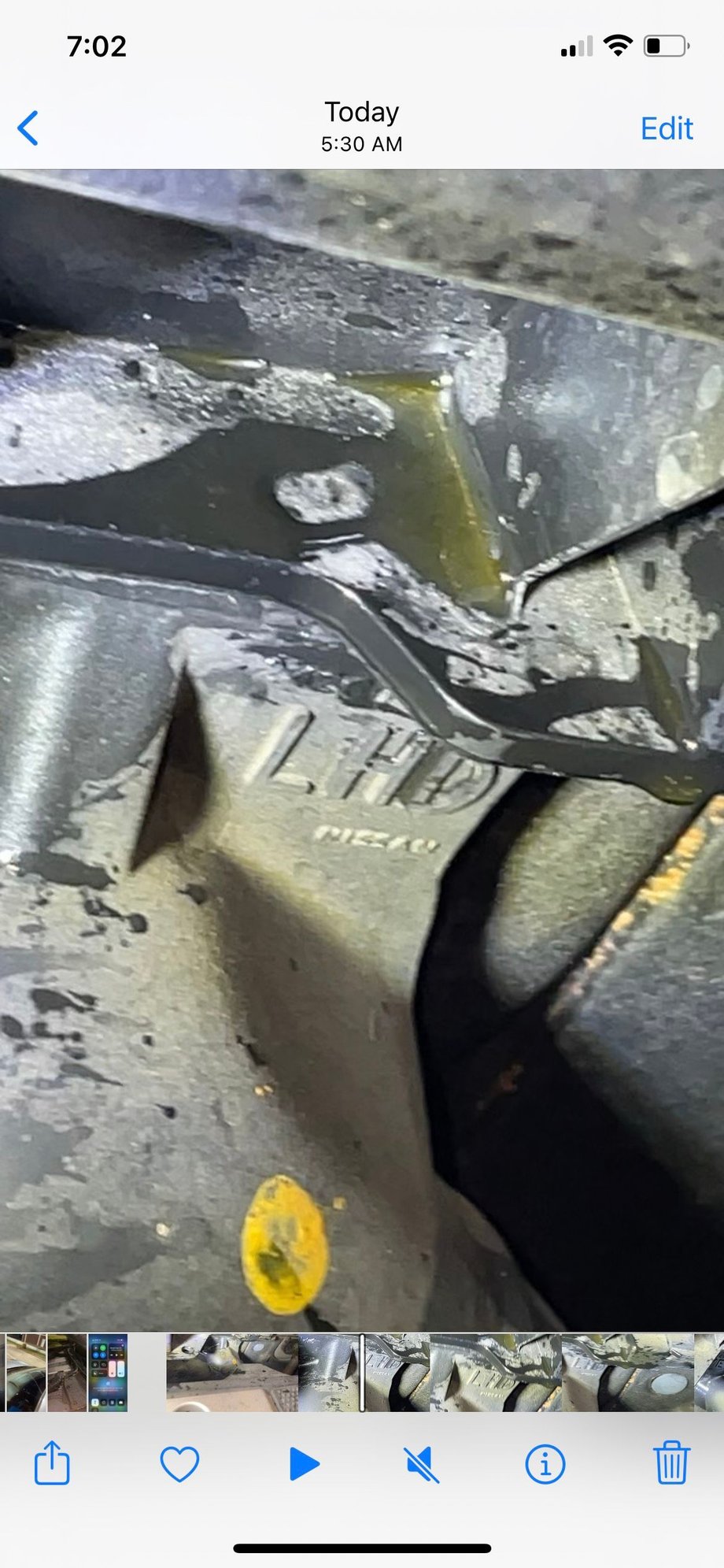

Sitting in the drive thru after coming home from work i noticed my car was smoking from the engine bay. i popped the hood and found that the smoke was coming from the back of the engine, the liquid that sprayed all over the place is green.
wondering if anyone has had this happen because i dont know much about cars and its sunday so i cant find anyone yet to look at my car. im assuming maybe something cracked or a tube came undone but i cant tell from the angles i can see and could this mean i need a new car

Being the "incident" occurred behind the engine, more than 99% likely your heater hose connector broke. Unfortunately, this is a VERY common issue for these cars. Look behind the engine on the passenger side and you should be able to see if the connector has broken.
Here are some links to help inform and guide you. It is not a difficult repair, but due to lack of space it will be a little frustrating- especially in this summer heat and humidity.
DIY- Heater Hose
Another Heater Hose Thread
And, don't panic. Obviously you can not drive the car without coolant, but I am sure no damage was done.
Cold engine: open the radiator cap. What color is the coolant? Did someone recently "top off" the overflow (reservoir) tank?

I haven’t had anyone look at the car for about 6 months and no I don’t think anyone has done anything to the coolant or system but the fluid that shot everywhere is green as seen in the pictures and the fluid in the tank is red

Out of curiosity, is the "red" substance watery or oily? Sounds to me like someone may have "topped off" your overflow tank with a different type of coolant, perhaps.
Most automotive coolant (antifreeze) is green. However, different OEM's use different additives, compounds, and chemical formulations that are represented in different colors. For example, Nissan uses blue, Audi uses red, etc. Then there is yellow, turquoise, orange, the list is almost endless.
Find the source of the leak- likely the connector- and repair. From there, flush the system (including the overflow tank) and refill with fresh coolant. Either green or Nissan blue.

it turned out to be the coupler.. costed 197$ to fix and now I’m back up and running
