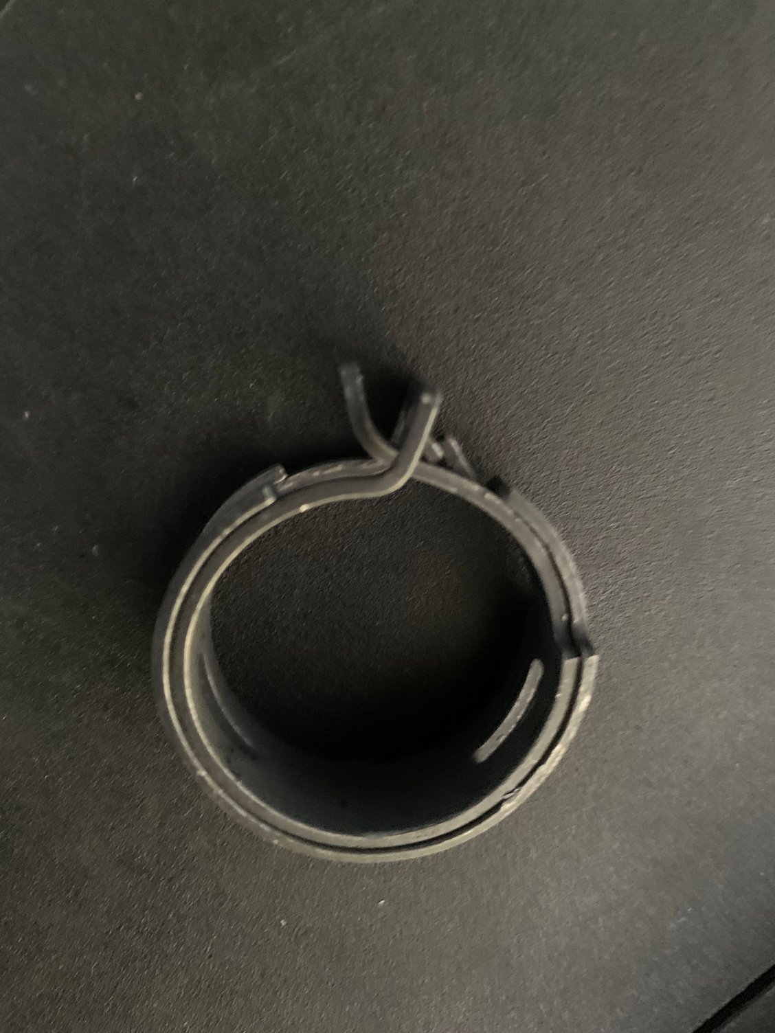

Update
Heater connector & coolant replaced and back on the road.
Parts: Q60/G Coupe 2007-2016 (HEATER PIPING)
$20.98 - 1 EA. 92417-JK20A - CONNECTOR
$15.85 - 1 EA. 92401-JK20A - HOSE
$12.82 - 1 EA. 92402-JK20A - HOSE
$4.75 - 4 EA.(IF YOU REPLACE BOTH HOSES) 01558-00521 - CLAMPS
Notes: It wasn't too bad. Said link above is pretty much how it went for me but I didn't replace any hoses just the connector with new clamps. Picture below came from the firewall hose, the other piece I had to squeeze the hose and everything just fell to the ground. Make sure you squeeze with the hose pointing down so the pieces don't go back towards the engine. Another interesting thing I came across is this video below where it talks about clamps. You can draw your own conclusion. I chose to use original constant tension clamps pictured above on this thread.
What size metal spring clamp would be a good substitute? TIA!
Old Dec 31, 2021 | 10:01 AM
camb003's Avatar
camb003
Joined: Feb 2019
Posts: 63
Don't have one with me to measure but I think it's 3/4? Get a few around that size if you are on a last minute situation. That said I think I posted a link here as to consideration with using general clamps. If you are in a bind go for it but IMHO go for OEM clamps in the long run.
Sorry to hear this happened but it's a relatively easy fix. I did not replace the hoses just the connector and clamps. The hose against the firewall has easy access, the hose against the engine has a MF access. Also when refilling with coolant there is an excellent DIY guide here that tells you how to do it right to minimize air bubbles in system.
Best and Happy New Year.
Old Dec 31, 2021 | 11:40 AM
BULL's Avatar
BULL
Moderador
Joined: Jun 2019
Posts: 2,626
Likes: 765
From: South Florida
A 3/8 14mm deep socket is the best/cheapest coolant adapter/bypass you'll find.
If you go to Harbor Freight they even have them in different colors for your liking.
As far as the video goes. I believe in the clamps 100%. I believe the issue is that these get rusty/tired and need replacements and replacements are, well, more than worm style and also will be in stock anywhere.
Your average folk does not have the right tool for these clamps which can be frustrating
Clamps sometimes dont work with some aftermarket hoses that their OD is smaller/bigger than the clamp which is more down time.
Go for the clamps if you can, nothing like letting go of the pliers and it's set. Nothing like a tired forearm in an unreachable place where the only thing that fits is a small screw driver
Old Dec 31, 2021 | 12:23 PM
camb003's Avatar
camb003
Joined: Feb 2019
Posts: 63
Good points although I must say the OEM hoses were relatively inexpensive and so were the OEM clamps. Taking the clamps off was a bit tricky but nothing rocket science like. The beauty of an OEM clamp is that it comes preloaded and all you have to do is place it over the hose, release the preload and bang, done deal. I used common sense taking clamps off and on using a simple pair of pliers although a 45 degree angled pair would be best. I'm sure there are videos in YouTube if you want to exactly know how these OEM clamps work.
Old Dec 31, 2021 | 12:39 PM
bjmsam's Avatar
bjmsam
Posts: 92
From: Mount Airy, MD
Thanks! I was not considering worm clamps.
