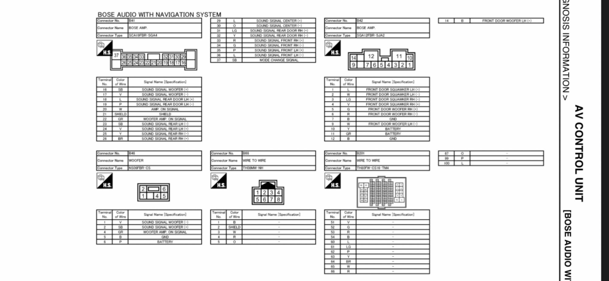

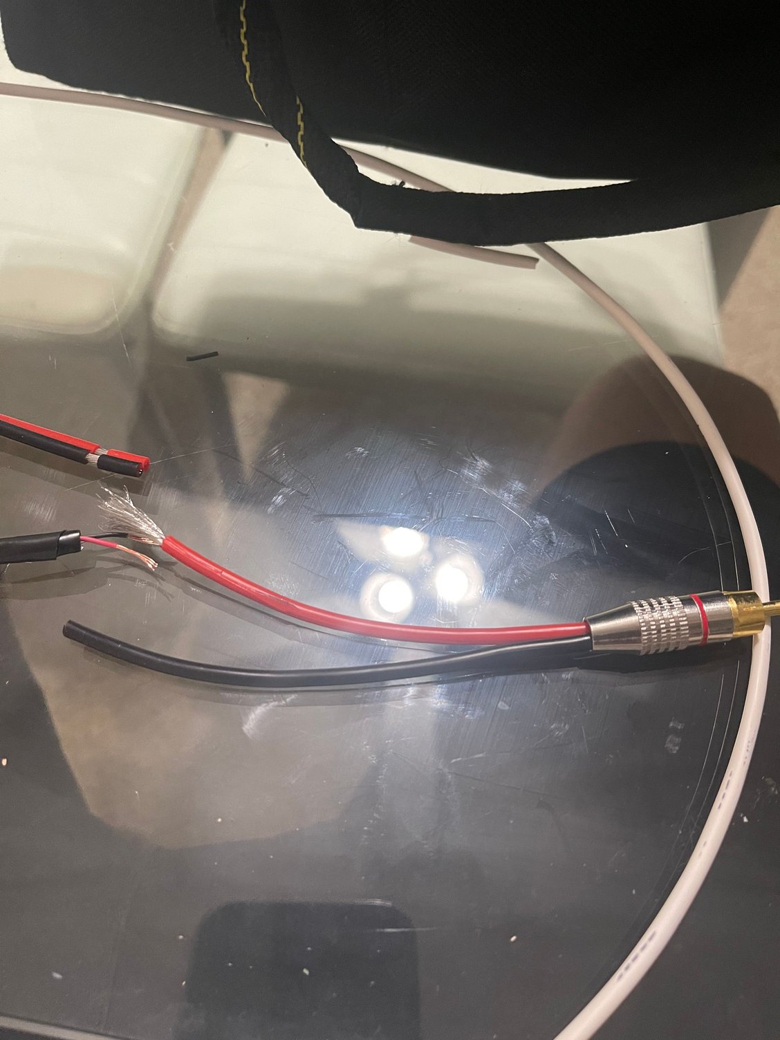

Gonna attempt absinthe method now. Would u say this is proper length between the 1503 wire and the rca connector? Or should I make the rca connector as close to the wire
as physically possible?
Old Apr 13, 2021 | 12:19 AM
  #38
Gtrlos's Avatar
Gtrlos
Joined: Jun 2017
Posts: 44
From: OC, SoCal
Also one last thing 🙏🏼 For absinthe method, since I’m splicing the shield wire into the negative (outer) on the rca point do I have to splice in the shield wire on the BOSE amp side into the negatives of the b41 connector? Or just leave the bose amp side exactly as I’ve done in the last attempt?

Sorry I'm late the action here. Hey, you got ONE channel to work cleanly? That's something! Trying to figure out why one and not both though... It wouldn't have been the 1" difference in length, but are you sure you got +/- right on both at the Bose end?
The best thing would be if you could solder the 1503 directly to RCA plugs... The idea is to take that shield as far as possible. Any unshielded wire in the circuit has the potential to pickup interference. What's the deal with that RCA in the pic, are the red and black wires single conductors or is that a Y-cable with 2 shielded leads?

No problem man, here is the link to the RCA cable. It’s a rca cable with both left and right connectors and each connector has the +/-. They come like that out the box CESS-064-1f Speaker Cables to RCA Plugs Adapter, 2-Channel (1 Foot)

Turns out I had my wires switched up. Saw P on the wiring diagram thought it meant PURPLE but it actually meant PINK. No more buzzing!!!!

So yeah, those RCA 1-ft "speaker" cables are not the ideal thing to use in this application because they are unshielded wires. If you're up for doing some soldering build yourself some custom cables. BUT, it sounds like you've figured it out and gotten it all to work without the noise so this is great. And if it's working - don't fix it.
Now tell us what's up with the sub. Aren't you taking that signal from pins 16 & 17 of the large Bose connector, or pins 8 & 9 of B43? At either plug, the light blue wire is "+" and the purple wire is "-". That signal source should follow the head unit's volume control, it shouldn't be a constant level. So I'm not sure what's happening there.

I tapped into 1-2 on connector b46. I don’t have the b43 connector got confused earlier about that . Was going off the wrong diagram
