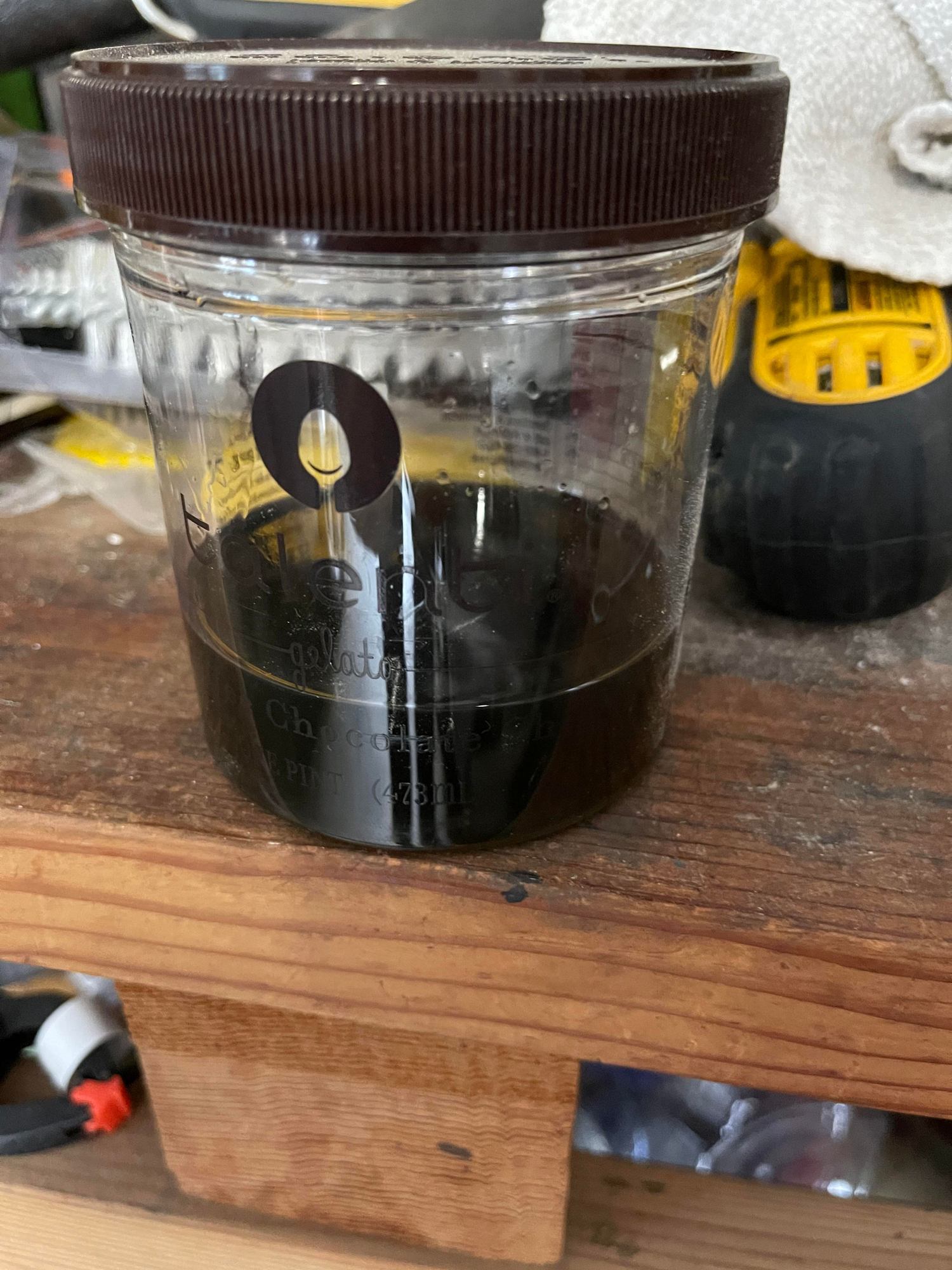

Hey all....PSA here.....CHANGE YOUR FLUID!!! (Mainly yelling that to myself). I had a small epiphany this morning to do a fluid changeout like I did in my old G (at about 140k). I just did the "Ranger" method for flushing the fluid (
). Basically, you suck out the fluid from the reservoir with a large syringe (just what is in the reservoir), clean out the bottom of the fluid cup, refill with clean fluid, pump the clutch pedal about 30 ish times, lather rinse repeat until your fluid is clean. Took me about 4 full replacements. Now my pedal is back to normal. It went from super soft, not returning all the way, engaging about 1/2" off the floor, but to full return, normal stiffness (steady gentlemen), and the normal engagement point.
The attached picture is the initial flush plus 3 fairly clean flushes. YIKES!

That's pretty dark fluid. I never let mine get that bad. Flushed every 2 years. Once there's fresh fluid in the res, gravity bleed for a few refills then traditional to finish it off.
If you follow that video at all, DO NOT pump so fast. Good way to aerate the fluid. Pumping should be slow and even.
