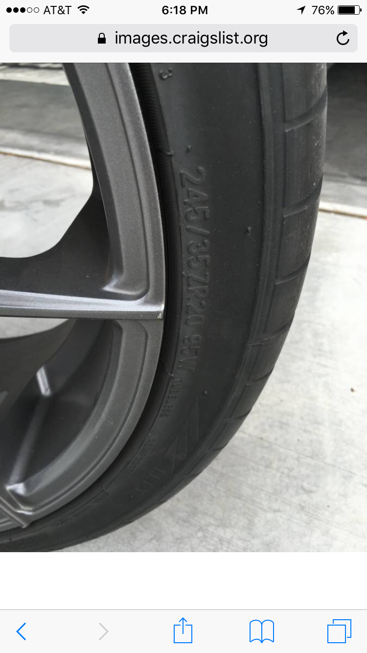

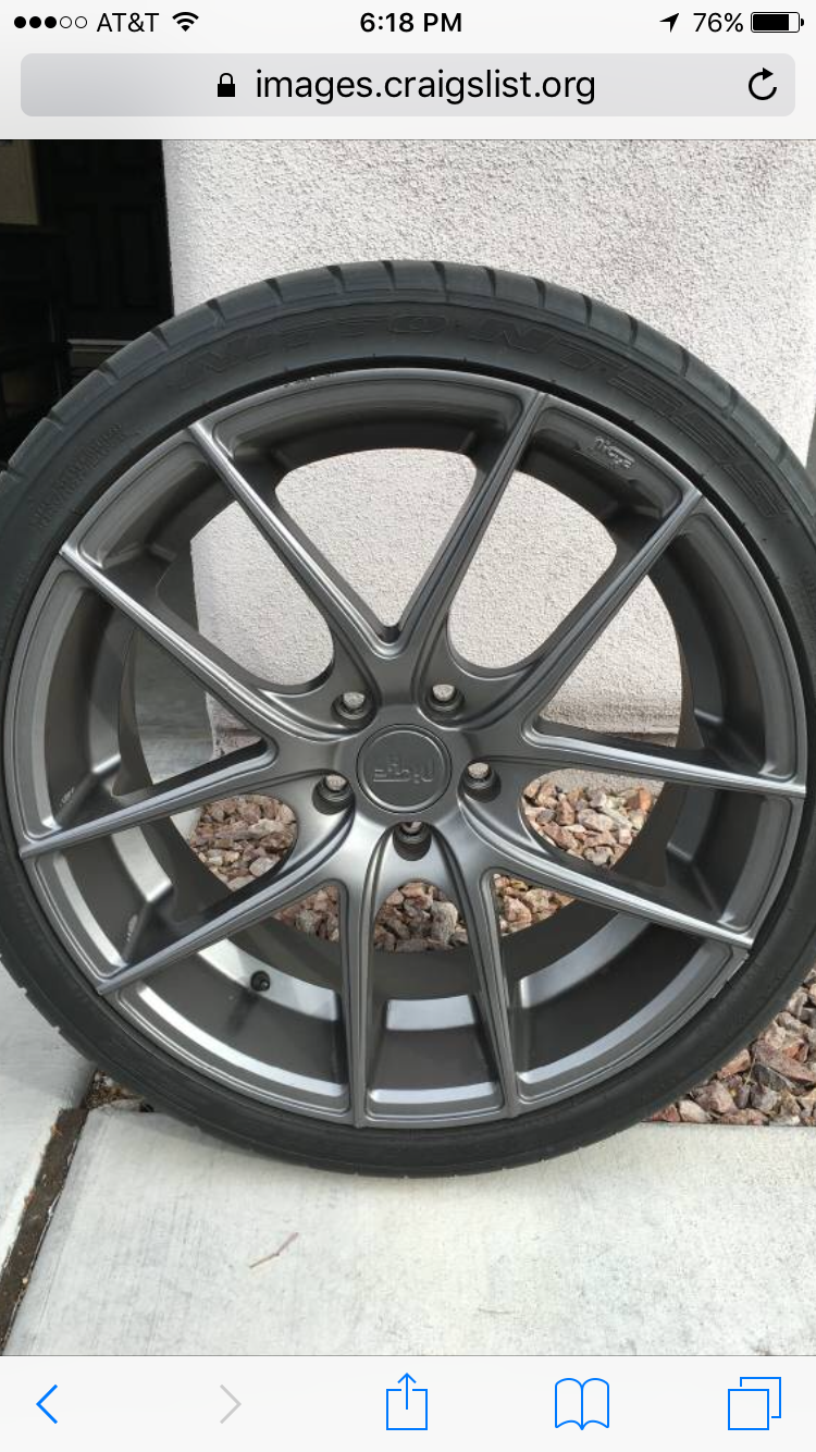

20x8.5 Niche Targa rims. In great shape. Lug pattern is 5x114. Tires are Nitto 555.
Tires are 245/35/
Gonna buy them probably
Are those measurements gonna look ok on my sedan- dont want them sticking out to much
Want it more flush looking
Any pics or advice please

Only spec missing is the offset, and that is important to determine the exact fit at the fender. If the offset is +30 to +40 they'll fit ok, if it's less positive the wheels may poke outside the fenders, especially at stock height, if you go more positive than +40 they will be sunken in quite a bit (but this can be addressed w/ spacers). You'll also want hub adapter rings to eliminate high speed vibration and new tapered seat lug nuts.
If your sedan is RWD the Tein Basis Z coilovers are a good choice and at about $500 shipped they are a lot of bang for the buck, if you want adjustable dampers the Tein Flex Z coilovers can be had for about $300 more. You may need camber kits depending how low you drop, and for a full F&R kit it's about $550, just the rear kit (which is needed more often) is about $200.

Offset is 42- with the teins is it bouncy or pretty decent - rims coming off a honda accord

42 offset is pretty conservative, but they will fit without issue. I'd drop it first then decide what spacer thickness you'd want or just run them as is.
Not sure what the bore is on the Niche wheels, 73.1mm is pretty common but you'd have to confirm w/ Niche or measure them, the Infiniti hub bore is 66.1mm. I'd go w/ aluminum adapter rings, the plastic ones don't hold up well. Ebay has them for about $15.
Teins won't be as firm as the Taiwan-sourced coilovers, should be closer to OEM ride.
Going from stock 17s to 20s will be quite dramatic in rougher ride quality, and top that off with coilover suspension will compound that further, so be prepared for much more NVH.

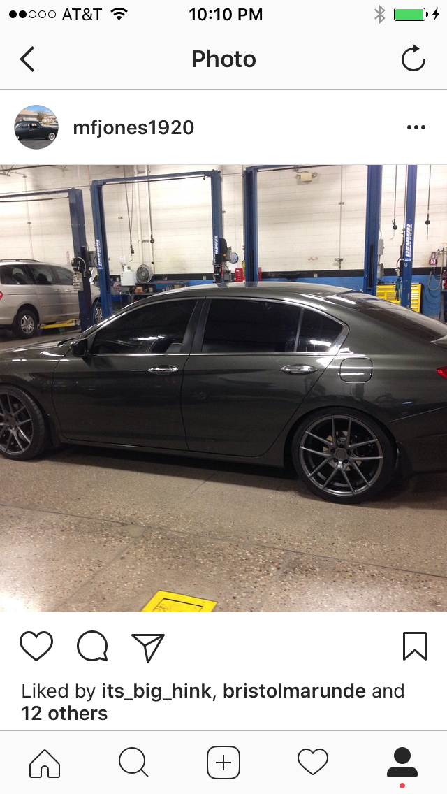

Ill pm u pic of rims on honda accord

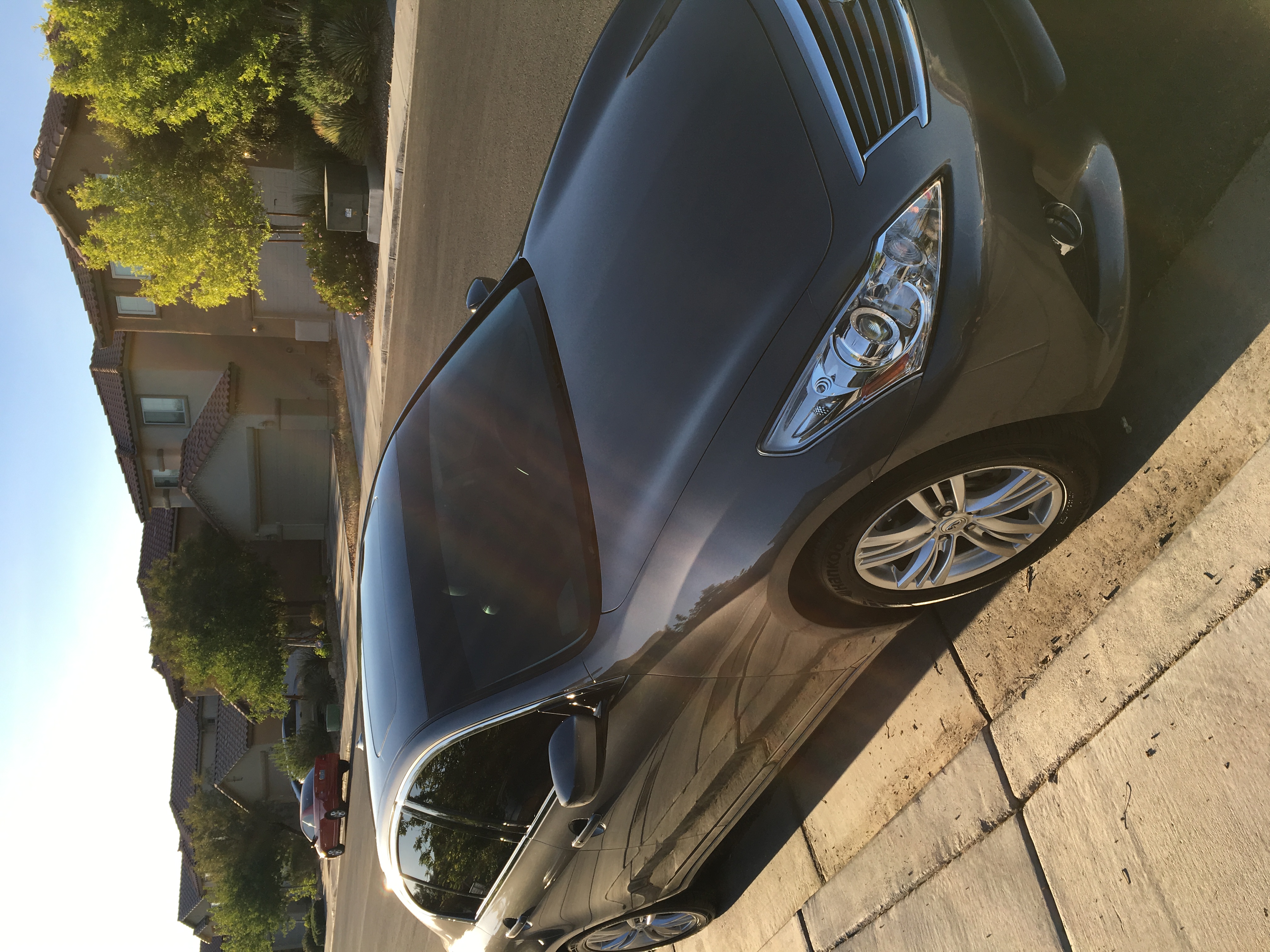

35 offset
Rims on accord coming to g37 sedan
Will my front rims poke out like that?

35 offset is better, wheels won't be sunken in as much.
As far as 18s or 19s, they will give a softer ride vs. 20s, and if you're not in a hurry to lower your G they will look better as 20s tend to make the fender gap appear even larger at stock height. Tires for 19s can be quite a bit more $$ than 18s.
