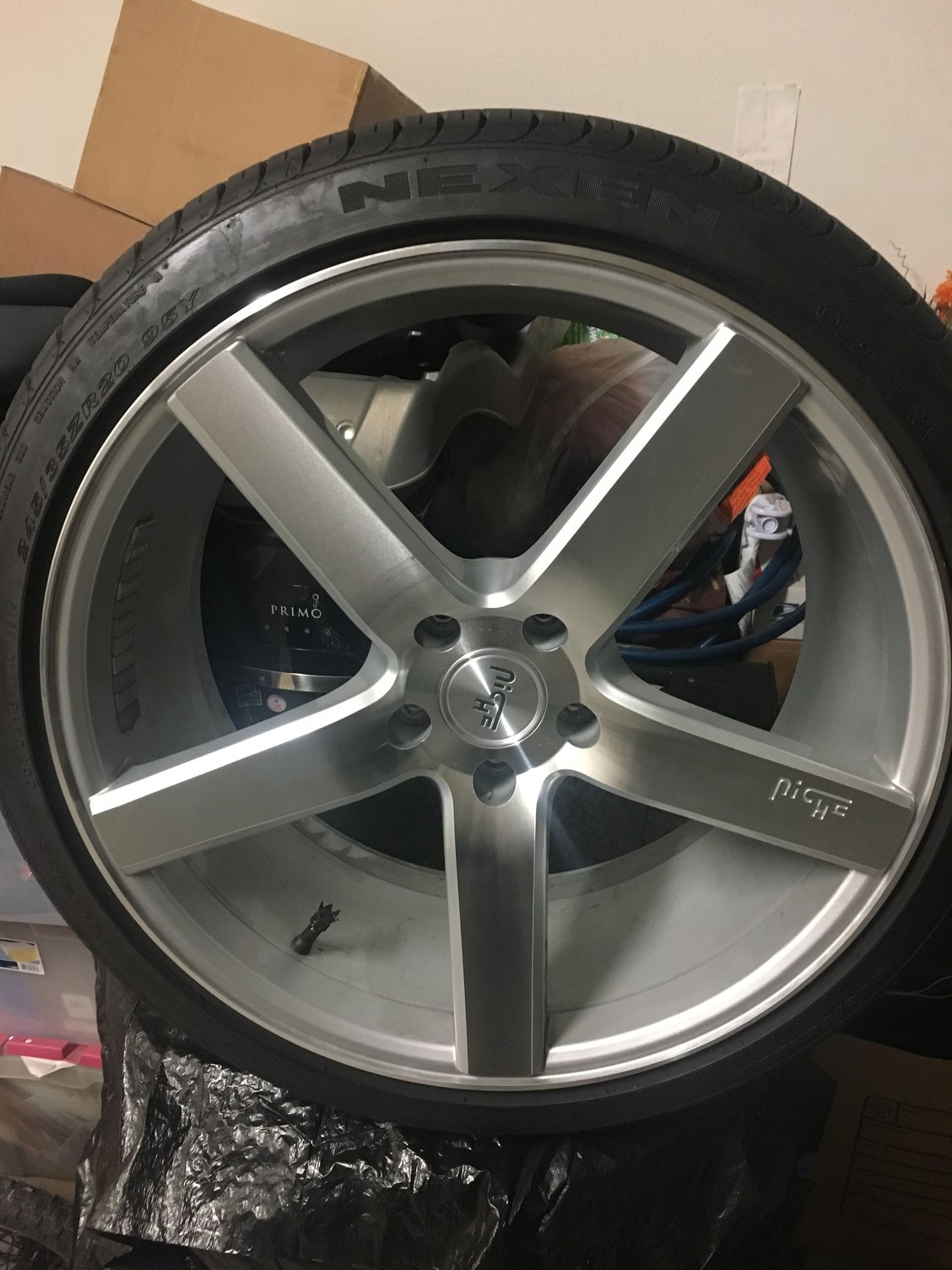

[img]webkit-fake-url://a8c5c48a-9b1f-4e8d-bb75-875b613d2c2f/imagepng[/img]

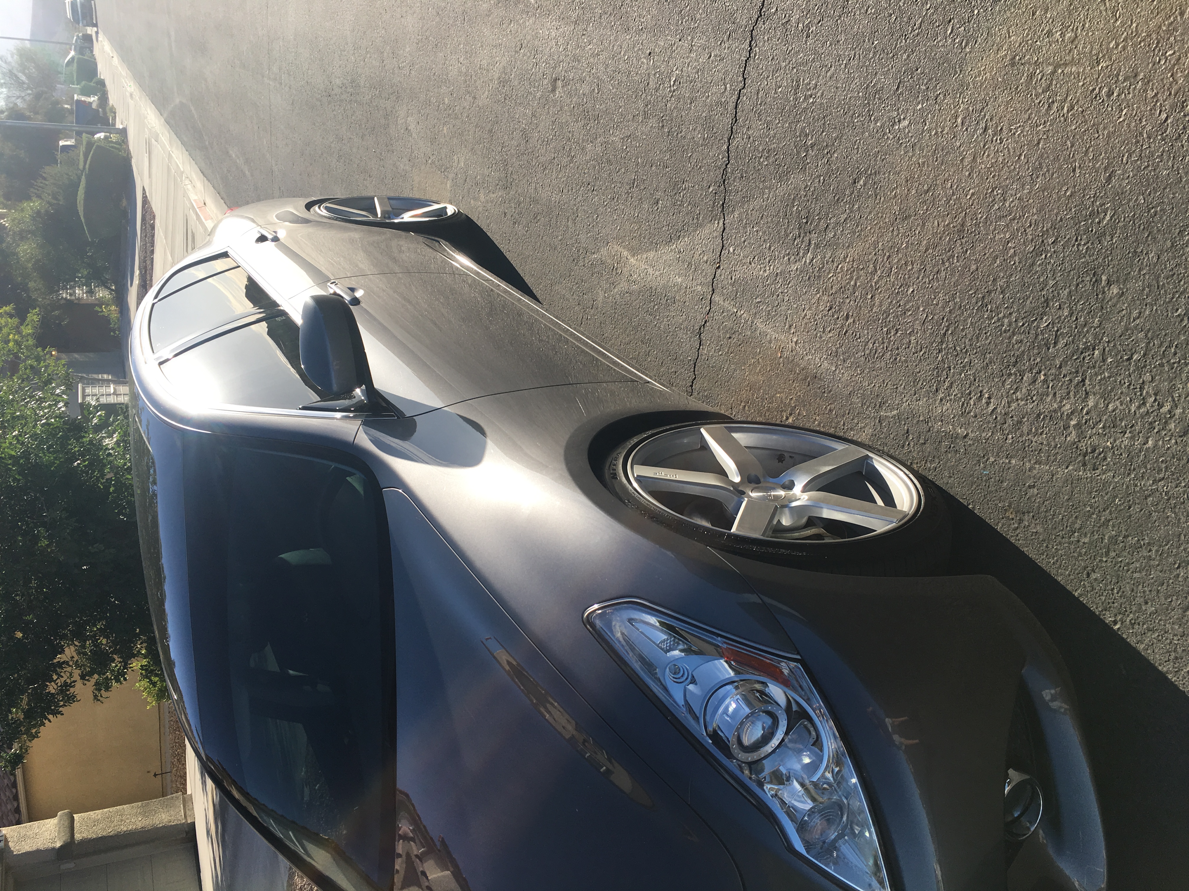

I ended up getting this
20x8.5 offset 35 245/35/20
20x10 offset 45 275/30/20
i wanted to say thank you for the advice & help with the rims- this was owners old car- ordered hub centric rings & tapered lug nuts like u told me - thx for info

Glad it worked out! That will be a good fit w/ those specs. Now you'll want to lower your G

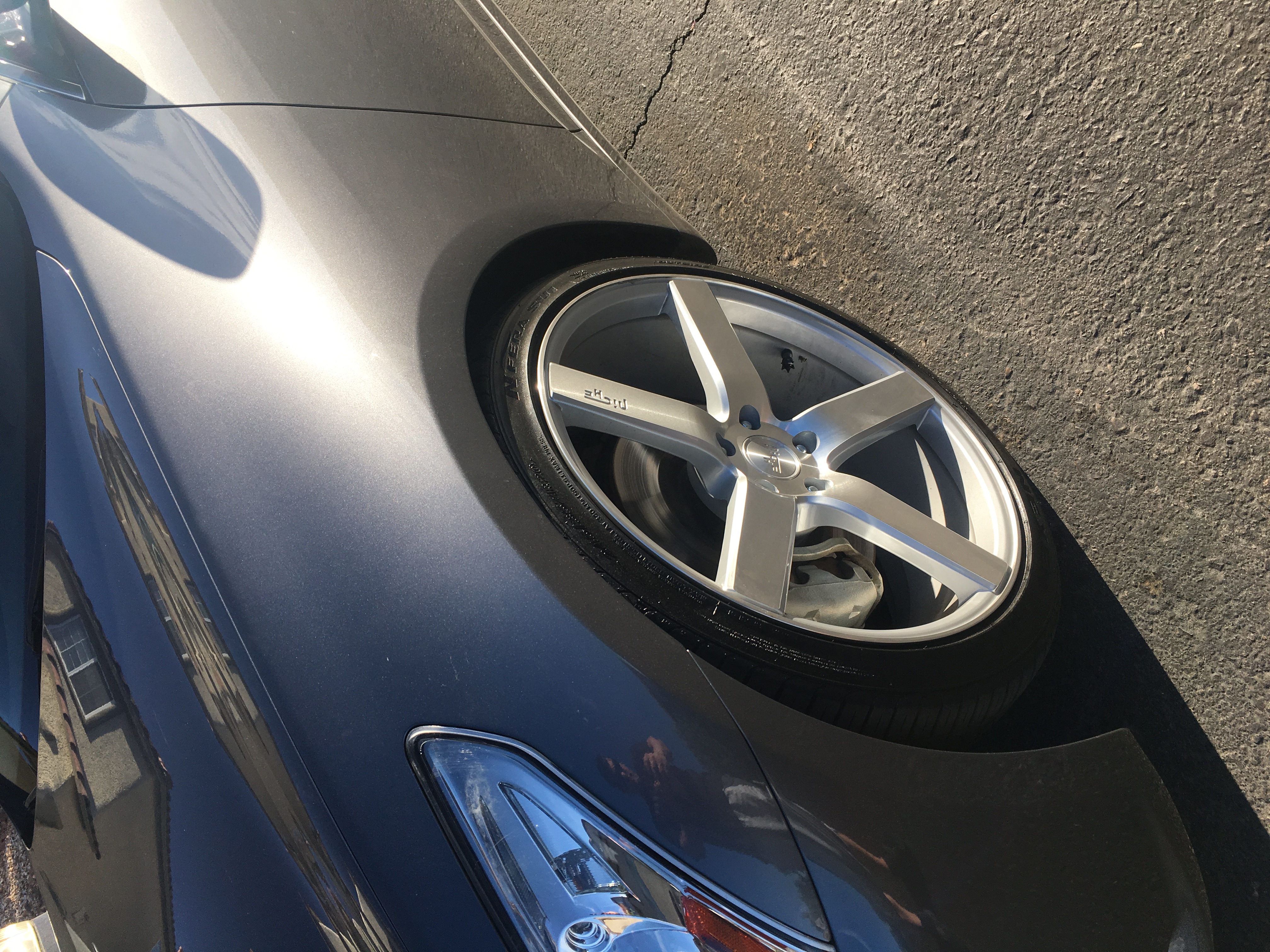

Do u think front is flush or I need a small spacer
Overall is a spacer bad? Do they get stuck sometimes
Old May 17, 2017 | 09:32 PM
  #24
I'd get the suspension lowered & aligned then reevaluate, you might like the fit as-is and if you want a spacer you'd be able to determine the size needed much easier.
Spacers aren't a problem, just stick to a brand like Ichiba, H&R or B2 Autodesigns, those are decent quality. Just need to torque to 80-85 ft. pounds and if they are bolt-on spacers use ONLY a 6 pt socket that's sitting flush as the stock nuts that come w/ the spacers are very easy to round off. Also w/ the bolt on spacers re-check torque shortly after install and every oil change.

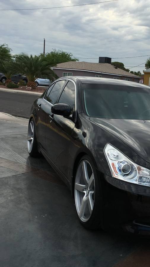

Went 26.5 all around - 450$ for labor for coilovers, front rear control arms & camber kit & alignment was included - I shopped over 10 plus shops for prices & they had the best- panda 🐼 auto - they just opened & they have 2year 24k mileage warranty - never heard of warranty on work before
Old May 26, 2017 | 12:30 AM
  #29
Once I turn my head to the side that looks really good there Kp! Sounds like a fair price too!
