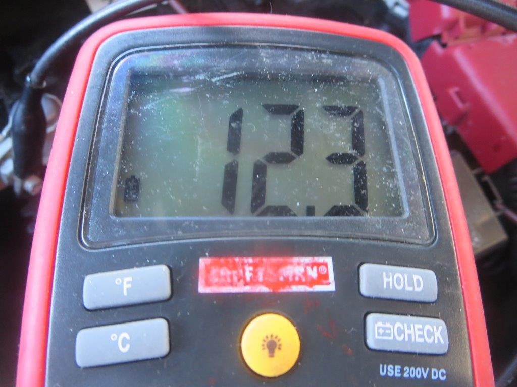

Measure battery voltage with engine off

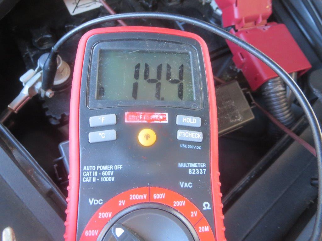

Measure alternator voltage across the battery with engine running

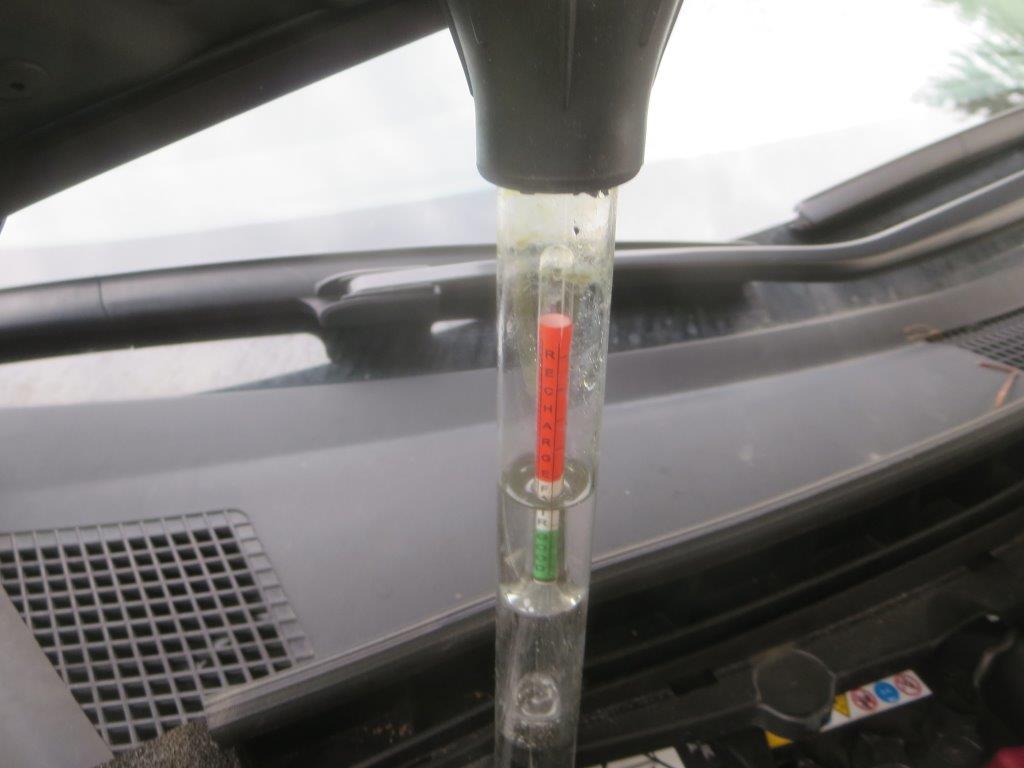

Test the specific gravity of each battery cell with engine off
