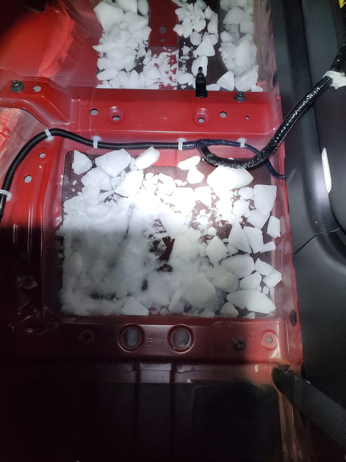

While the carpet is out, figured I'd shed a few pounds.

Holy sh*t! Someone is actually doing it! I removed mine from the trunk area, use a heat gun, chisel and goof off. When you take her out for a spin could you tell us if the cabin noise is louder or not?

So with the carpet about there was noticeable increase in noise. Road noise and exhaust drone. Not too bad, bearable for sure. With sound deadening removed road noise increase more but again not too bad. With the carpet back in, which I have not done yet and dont plan to until I'm certain drain tubes are fixed I can see one hardly noticing the difference. I did not do any of the trans tunnel or under console dash area.
just floor boards front and rear. Not under rear seats nor trunk.
Total weight was 3 pounds each side for a total of 6 pounds.

That seems like a lot of work for only 6 pounds. I could see doing that in a race car, but a street car- probably not. Thanks for taking the time to do it. So was it dry ice that you used and how did that help with the removal?

Dry ice makes the mastic brittle so you can whack it with a hammer and it shatters. Easy clean-up for the part that does so, some will refuse to part from the floor and then you have to use a heat gun to melt it, making for a somewhat gooey mess.

If you want to know another trick you can do with removal of the tar sound deadening in hard to reach areas, I would recommend getting a 5 gallon bucket and throw the dry ice block inside. Then, dump in a full bottle of isopropyl alcohol and smash the dry ice until it becomes a paste. Then you can throw the paste onto weird surfaces like the transmission tunnel.
