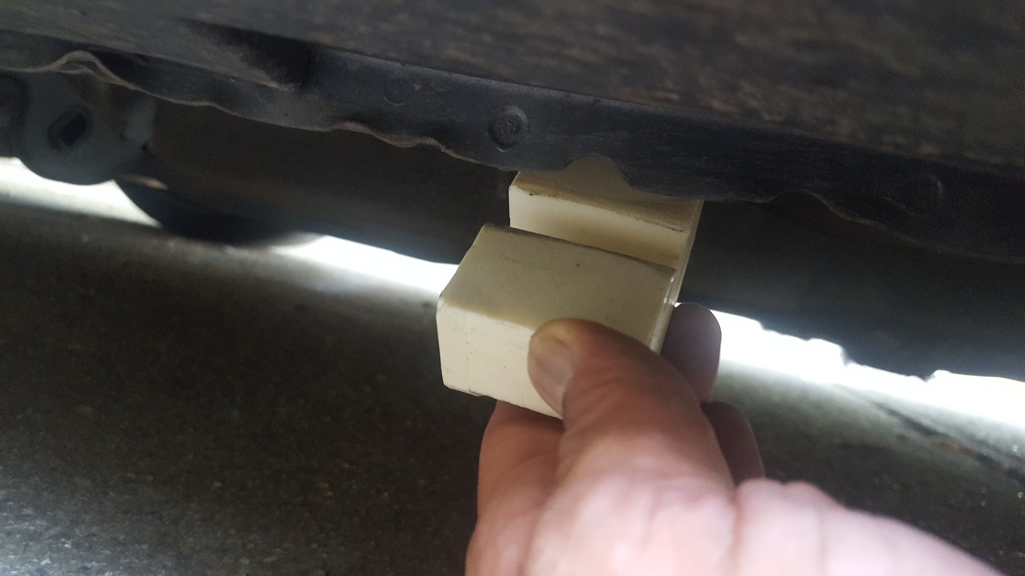

Mine looks kind of like this, except instead of the metal stock on the bottom, the two halves are screwed to another puck.
http://www.ft86club.com/forums/showthread.php?p=390308
