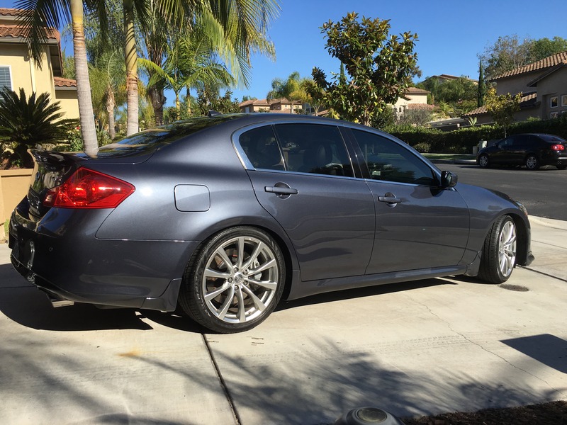

2012 G37S 35k miles 7AT
Owned for 7 months
Motor is all stock
Whenever I smash the gas pedal I hear a high pitch whistle sound coming from the engine area. Usually occurs mid to high rpms Almost like a Toyota Previa sound for those who knows what I'm talking about. Im almost certain this isn't a wind related noise. Is this a normal sound for our cars?

maybe shoot a video of it so you have proof just in case the dealership can't replicate the noise issue....btw, nice ride! I'm originally from So Cal and moved to the East Coast, miss the San Diego weather right about now...LOL.
