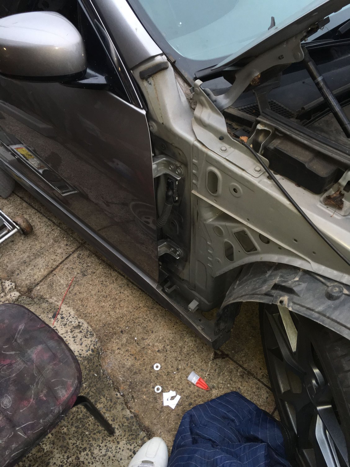

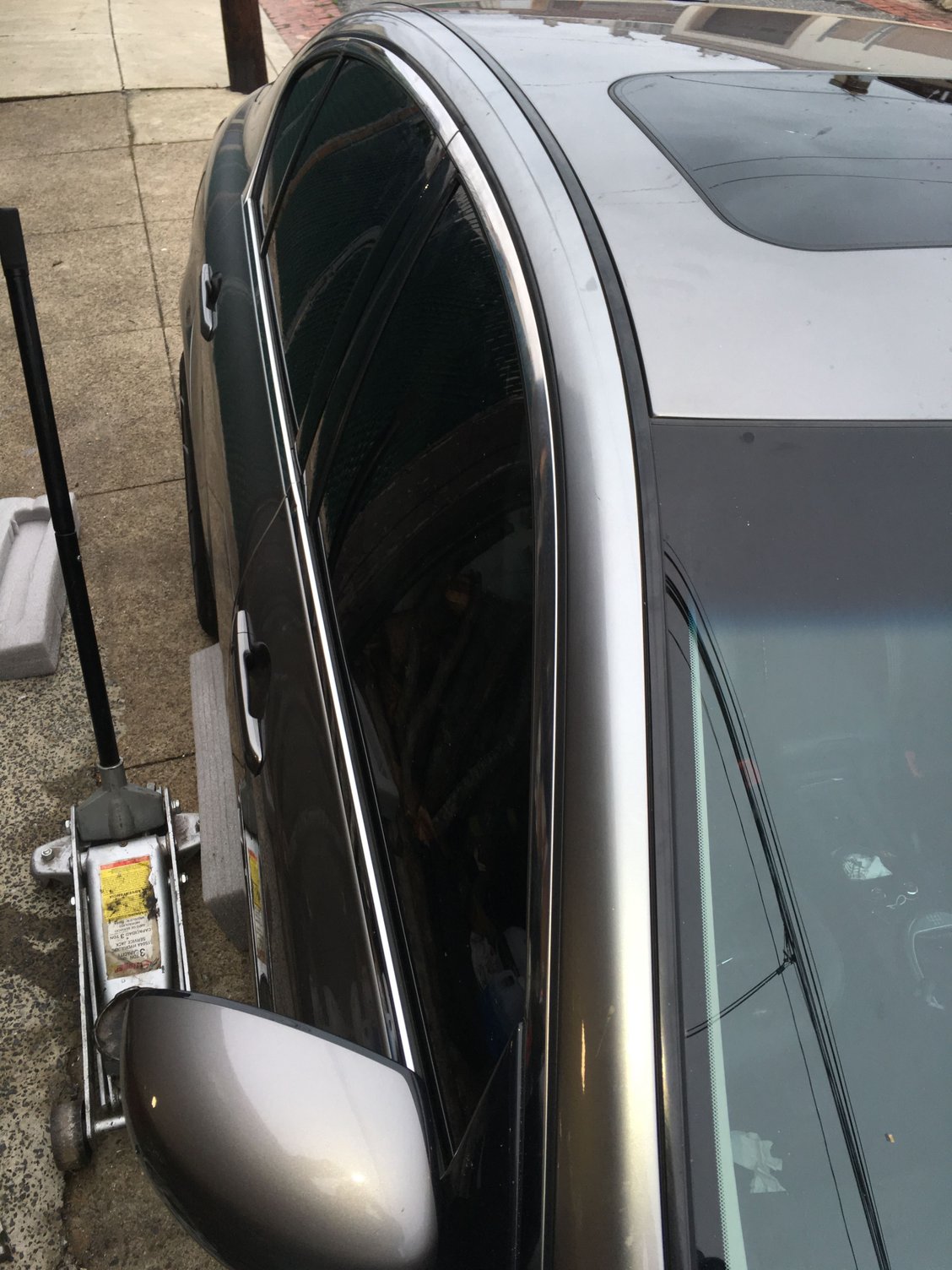

Slide hammer worked well, pulled the bottom hinge out
But it took a little work getting the gap between the door and roof to align but here's the end result
Well "end result" for today at least. Obviously still a work in progress, the shade is minimally off but I didn't see it in sunlight yet but it's coming along, still a while but the good news is the funds were transferred and it's all in my account. Even if the few naysayers here end up being right and the fault will be split, this would still be my first claim with state farm in about 15 years which won't increase my premium anyway so all in all, at the end of all this I'll have some extra change in my pocket.

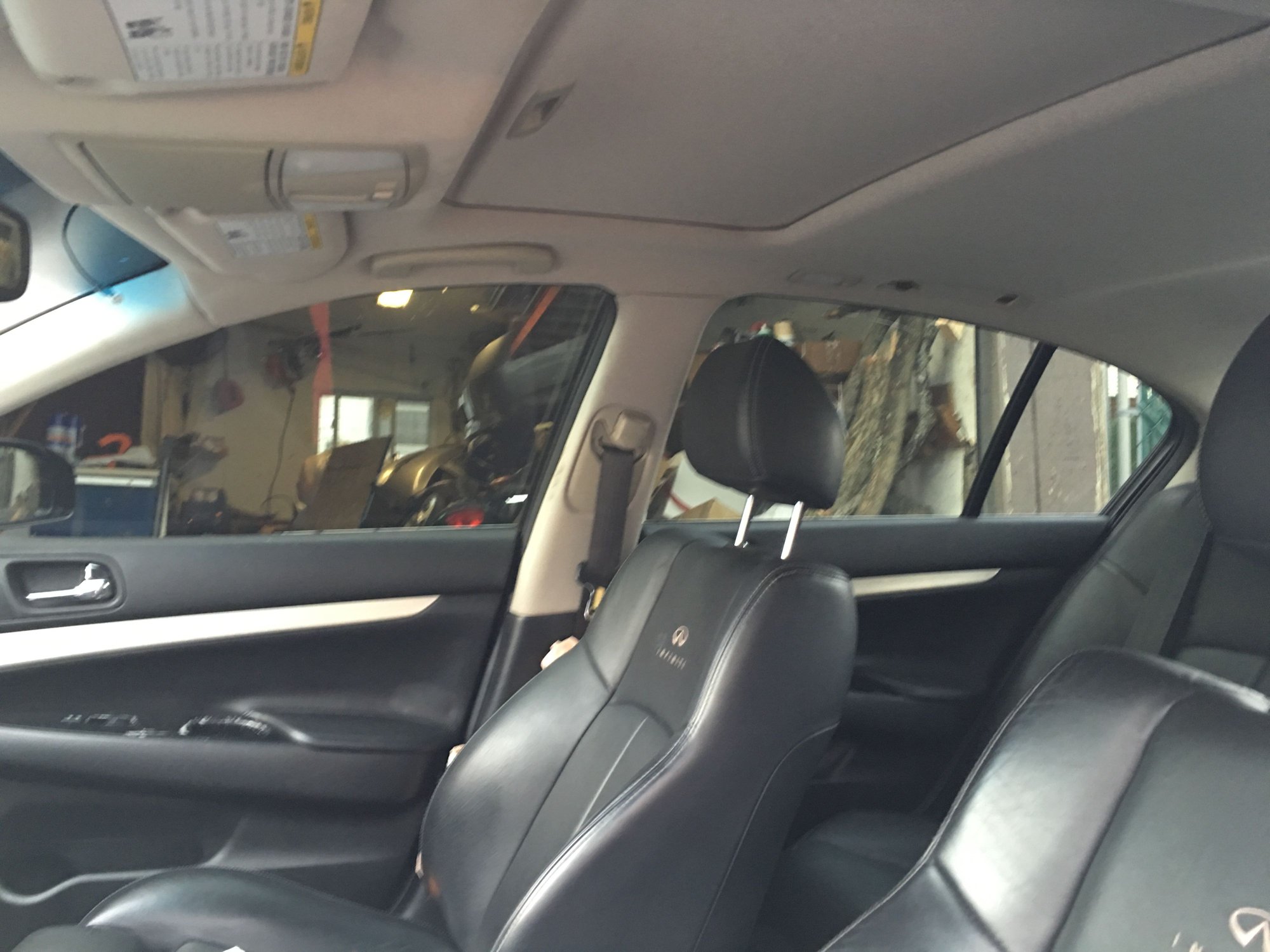

Curtain airbag done for today, there are little creases in the headliner. Maybe they'll work themselves out but if not I'm going to try the fabric steamer method, heard it works wonders.
Install was fairly straightforward, didn't have the take the headliner off completely, just the two roof handles and the sun visor. Headliner was already bent a bit at the time of deployment so I just wiggled in there to get to the 10mm screws. The connection was at the back, taking off the back of the passenger side rear seat helped a lot, as well the the corner peice between the door and the rear glass, all clipped on. That made it a lot easier to remove the blown bag and install the new one
Baby steps but in the right direction, still waiting on the fault decision...

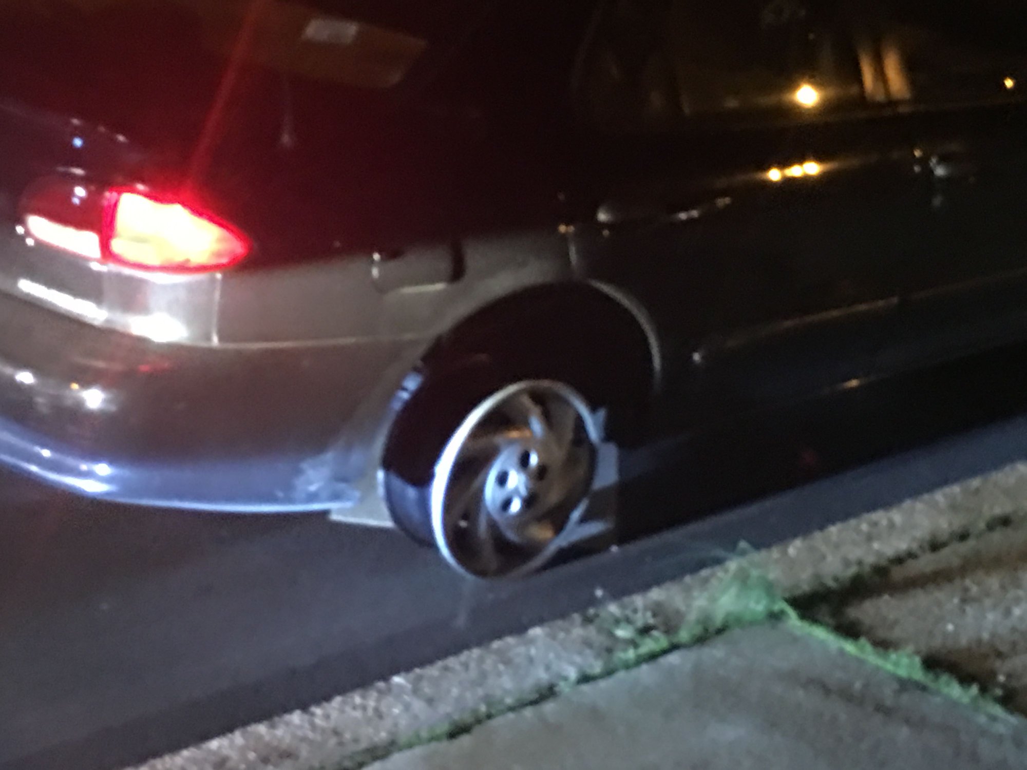

Oh and now this crap, coming home last night, I'm driving my girlfriend's car (2011 vw gti) we're stopped at a red light, complete standstill, we're the only ones on this road since it was close to 12am and BOOM, we get rear ended. Wtf, is it my luck or my gf's?? Luckily the damage isn't as extensive as mine, but what this lady was driving is insane, a 96 chevy cavalier WITHOUT a tire on her rear right rim, not a flat but no physical evidence of a tire ever being on the rim. I have no idea what was wrong with her. She admitted fault and we pulled over to the side. She kept fumbling around for her insurance papers and couldn't find any. Called the cops and while we were waiting she starts driving off, I yelled for her to stop and she did. Cops weren't showing up but luckily I flagged a passing cop and he stopped. Got her insurance info and we left but the cop wasn't going to let her go. I'd really love to know what the f*** was up with this whole thing. At least she had insurance and the claim is in the works. Here's a pic of what she was driving
What the hell is wrong with people... Can't wait to get some details, hopefully I will, the progressive rep that took my statement could hold it in and was cracking up.
