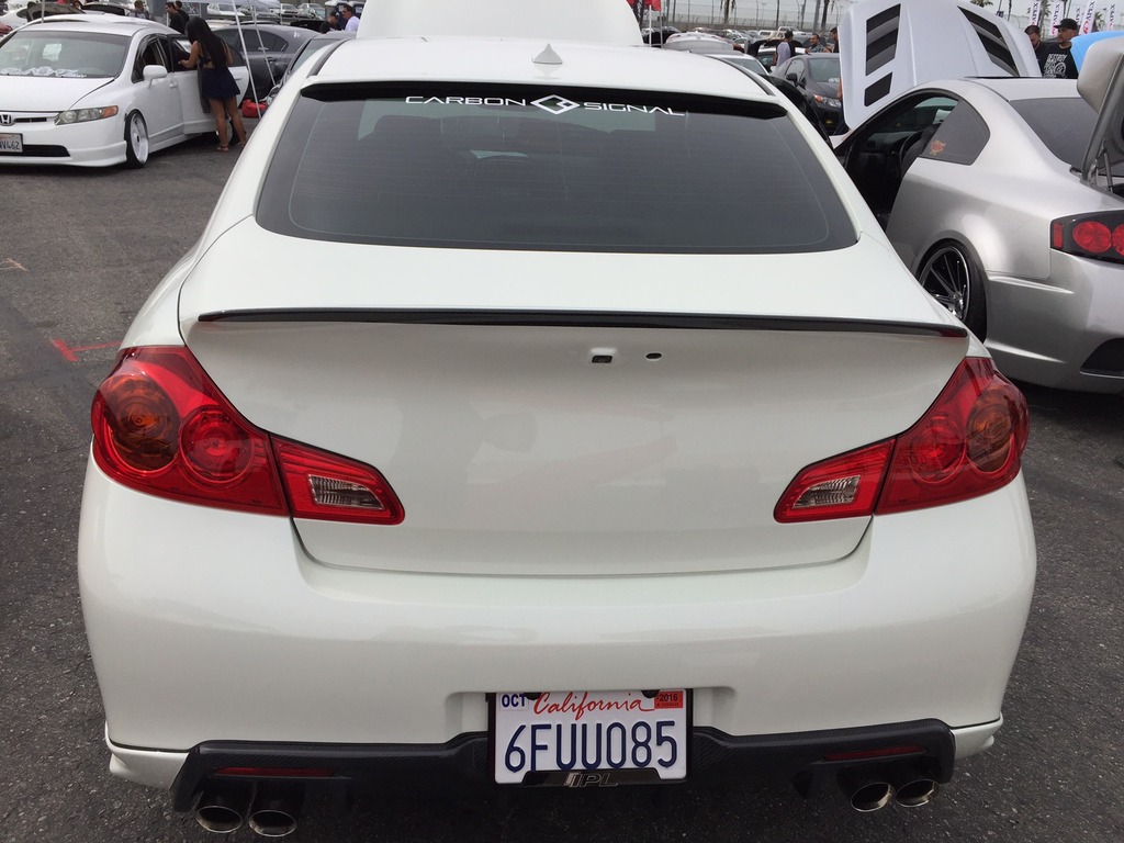

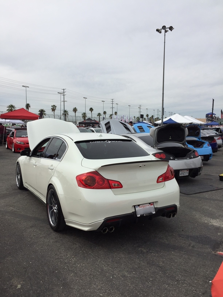

Mike, my vote is obviously for quad tips!!
My wife "forced" me to get rid of my big Tanabe tips because she was tired of constantly scraping them on steeper driveway departures, so when I decided to redo the rear end of my car the obvious answer was to go with quad tips. Now not only do I have a fairly unique look, but I also have way more ground clearance in the back, so no more scraping (= happy wife)!
I ended up going with dual 3" tips (with 2.5" inlet) from RedTail Performance, part #RTP-037LR. These a dual wall, angled cut, with stagger fitment that seems to match the angle of our rear bumper almost perfectly. I wouldn't go with the straight cut, non staggered fitment, as the outer tip on either side will stick out from the bumper/diffuser while the inner tip on either side will sit nice and flush.
Exhaust Muffler Tip Dual Round Forward Slash Cut Rolled Edge 2.25" Inlet / ID, 3" Outlet / OD, 9.5" Length. 6.25" Outer Width #RTP-037LR

Haven't even considered the stagger fitment ones at all because I wasn't sure how it would look/fit but this advice from you is very helpful and I think I may as well be getting the same ones!! One thing that's giving me a headache is whether they will be able to make the opening bigger in my CS diffuser for the quad tips since it's CF laid over fiberglass
Do you have any more pictures straight on of the rear and some closer shots of the tips on an angle?

There's your solution, Mike, right there. Same rear end, too, so he knows. It would be great to see some detailed, close-up shots of those tips installed.
It's been my opinion of late that 2GoRNot2G gives good, experienced advice. Glad he found this thread.

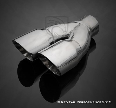

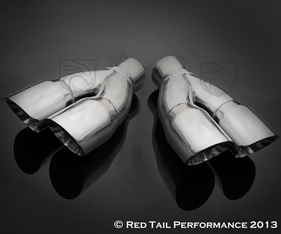

My Tanabe piping is also 60mm (2-3/8") and I spent weeks looking for a nice set of quad tips with 2-3/8" inlets and 3" outlets, but couldn't really come up with anything. I ended up going with 2.5" inlets and 3" outlets and the exhaust shop was able to make them work. The tip needs to be large enough to slide over the muffler outlet anyway and if necessary they can always use a flare took and enlarge the outlet pipe on your muffler a bit for a proper fitment. Here are the tips I ended up going with. They were around $120 for the pair if I recall correctly and I had them on my doorstep about 2 days after ordering!

Awesome!!! I couldn't find anything 60mm(2 and 3/8") inlet either. And figured the first bigger size 2.5" inlet would do and could always be welded over or something just simply made to work.
As soon as I get in touch with the shop if they can do the cutout bigger for me.. I hope they can make it work

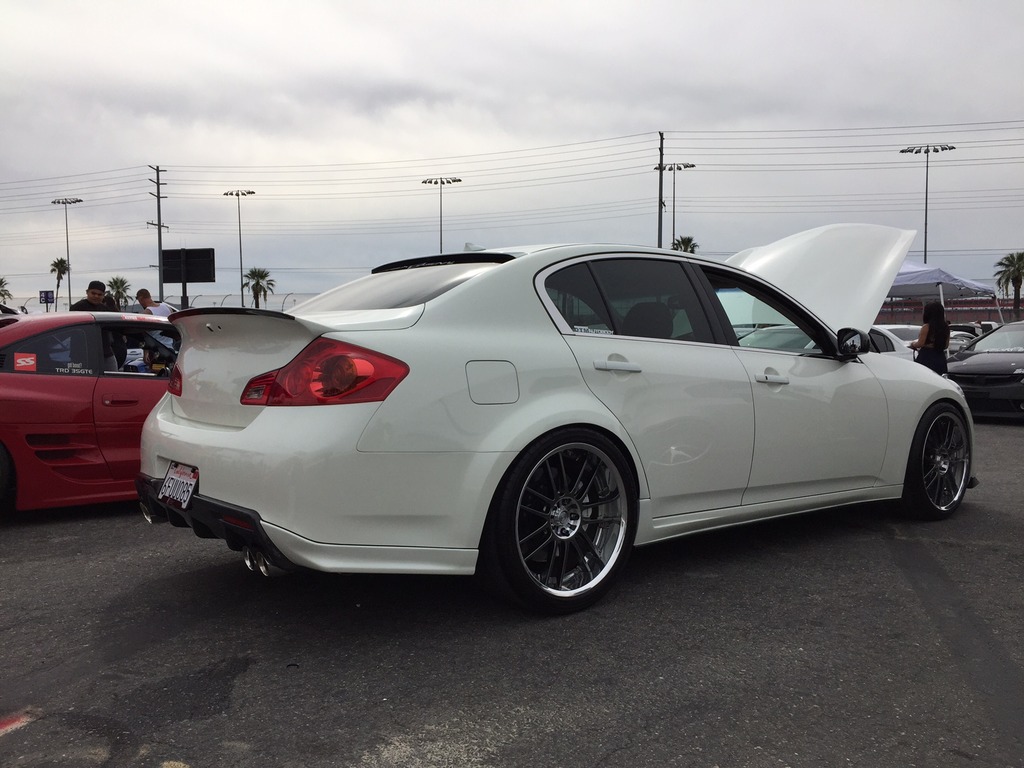

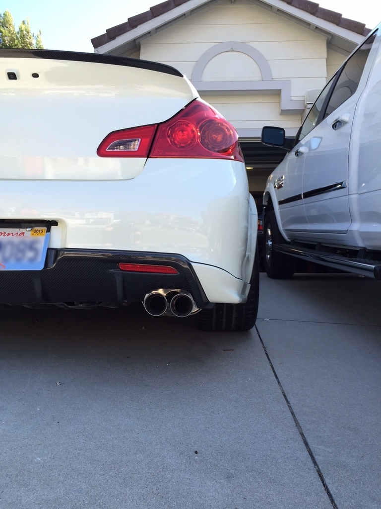

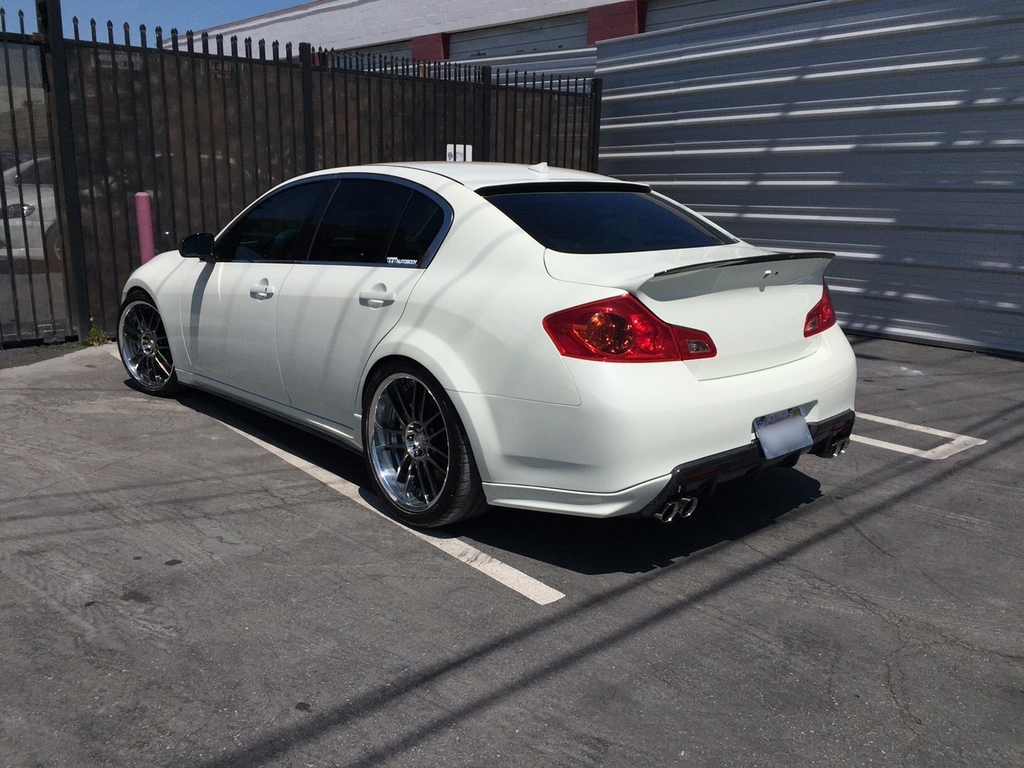

I originally talked to Carbon Signal regarding their rear diffuser and they were going to custom make me one set up for Quad tips, but it was going to be a long lead-time and I ended up getting a good deal on this Access Evolution piece from Bulletproof Auto (who is local to me), so I decided to go with the Access Evolution for the rear diffuser. Even the Access Evolution unit needed to be cut to fit the quad tips. I took MANY measurements (and them re-measured) before I ordered and the tips to make sure I have enough space for them. The tips are ~6.25" from edge to edge, so you'll basically need an opening with about 6.5" - 7" of width for the tips to fit and to allow enough clearance for some exhaust movement. I'm not sure what kind of space the CS diffuser has between the air fins, but try taking a couple of measurements... you'll also want to make sure you exhaust tips are close to being centered in the area where the opening will be made, otherwise the exhaust shop will have to modify more piping and/or mounting than just switching tips.
Here are a few more pics of my set-up. Hope this helps you decide.

Awesome awesome awesome!!! You're really a lot of help, thank you so much for all the information regarding this, I'll definitely have to take measurements and follow all of your advice, I'll also send you a PM which is important before I contact the shop

Zoomed in and adjusted for shadow so you can get a different perspective on them.
Pixilated because of it, but helps nonetheless.

Thank You John! The first picture I have zoomed in myself in my phones gallery because I asked Adrian to text me but the second one definitely shows them better after you did the adjustments! Thank you! I'll probably be ordering the tips tonight, still need to get in touch with the shop because I haven't had the time yet.

No problem. Figured it would help put your mind at ease about the cut-out, the staggered length, and the slash cut.
These are going to look spectacular on your car.

Yes sir it did put my minf at ease! Haven't even considered staggered length ones because I thought it'd look odd, but I guess I was wrong!

Well that seemed to work out well, and this look is definitely something to aspire to, love that G!
