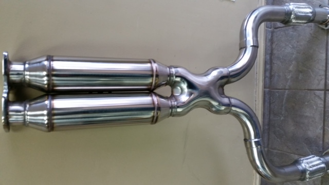

FI uses an X-Pipe design, and they do it by cutting holes into the bend, and welding them together:
Researching X-pipes, H-pipes, and straight-dual exhausts because of this thread has been pretty fascinating for me.
The take-away is that true-dual is no bueno.
ARK uses a Xpipe also? The whole X pipe or H pipe thing always interested me. One says to make more lower end( H) and one says makes more up top (X).
An looking at this system compared to mine it looks like it WILL not fit a X car.
Attached Thumbnails J2 Engineering Dual 3.5" Muffler Tip Exhaust Catback System For Infiniti G37 4DR-arkxpipe.jpg

The picture from my post is the current FI setup.
That's the ARK Grip in your photo... flex sections, x-pipe, side-by-side resonators. According to their website (), the ARK Grip is marketed to both RWD and AWD Sedans. AFAIK, it's the ARK resonated cats that have model restrictions, only supported by the 6MT.
And I agree with your confusion. Based on minutes of research (LOL), there doesn't seem to be a consensus on which is preferable, just a general disclaimer from everyone that "every car is different", and that on modern cars you should have an overlap between exhaust banks, of either type... X or H.
