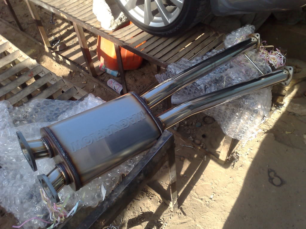

This is the old mid-pipe that Fast Intentions first used for their g37 catback. I have experience with both that and the new x-pipe. The new x-pipe definitely flows better, especially from 3k rpm and up. The x-pipe also sounds throatier and has a cool hiss sound.

If I'm not mistaken, that Magnaflow muffler in the first gen FI exhaust was an X-Pipe internally as well. I think it's perforated, so some purists balked at whether or not it was a true X-Pipe, but it is an X-pipe design.
