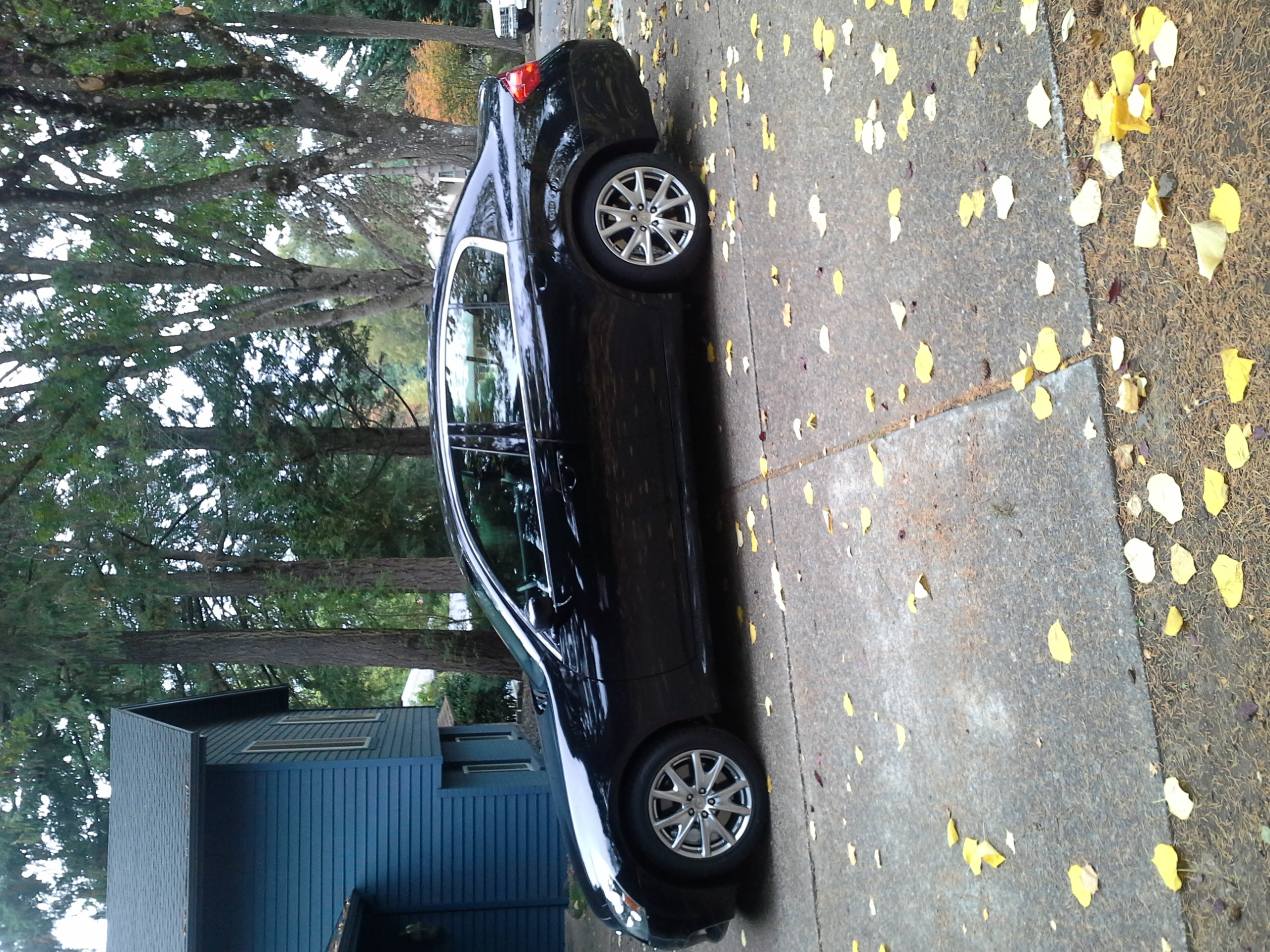

Hello,
After 10+ years of owning and driving trucks, I traded my 13 F150 for my new to me 2012 G37s. I work sales and just needed something better for daily driving. I did own a G20 back in college but was nothing compared to this G37.
I was heavily shopping and looking at A4, 335i, Maxima, is350 and Q50. Wife had a B7 A4 before and it was fantastic, very reliable but I read and researched the new direct injection 2.0 TSI had carbon build up issues. 335i is a beast when it works but a couple of my co-workers advised me to pass on used ones because they've had some expensive repaid bills. IS350 interior was way too small for my kids car seat and I just hate the new styling of the front and the rear tail lights.
Was going to lease a Q50, interior was nice and full of technology but something about the driving feel was lacking to me. So, I got a smoking deal on my car, 30k miles for $22k. I looked at the g37xs but it didn't have the same driving feel of the rwd S.
So, here's my question for you all. I have been research and from what I have read HFC is the best horsepower bolt on but I am confused on what to buy? The FI is the one I think I want because its resonated and will keep rasp/hiss sound down but then I have to get custom mounting done because it doesn't have mounting brackets? wondering if I got a brand that was not resonated and had mounting brackets if I wrapped it with header wrap would that keep rasp down? If all this is too complicated I'll just do some CAI. I cannot do full CBE because I need to keep exterior sound low, not professional for my job to have a honda like loud racer...
Thanks in advance.
