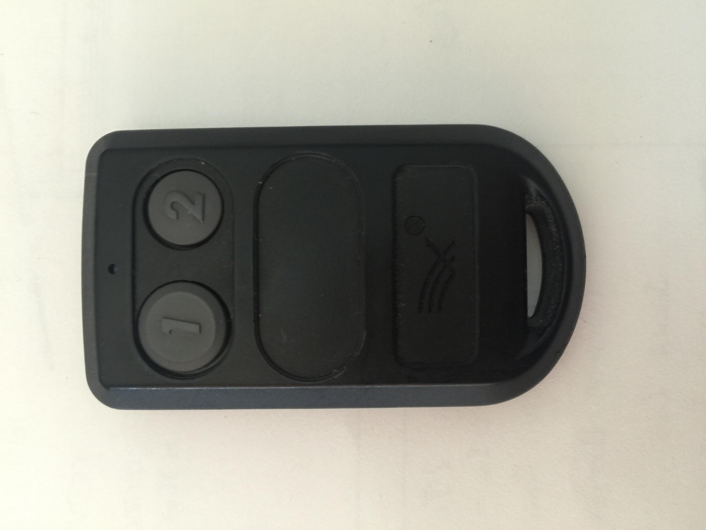

I am attaching a picture of the transmitter. There is a logo on it. It also contains an internal FOB which can open the building's pedestrian access doors. It's a 200-apartment building.

Based on the logo, it seems the manufacturer is Farpointe Data, Inc.
https://fccid.net/document.php?id=1231779
http://www.farpointedata.com

I've found more information about the transmitter:
http://www.farpointedata.com/datashe...2_WRT4_TDS.pdf
http://www.farpointedata.com/datashe...mitter_QSG.pdf
