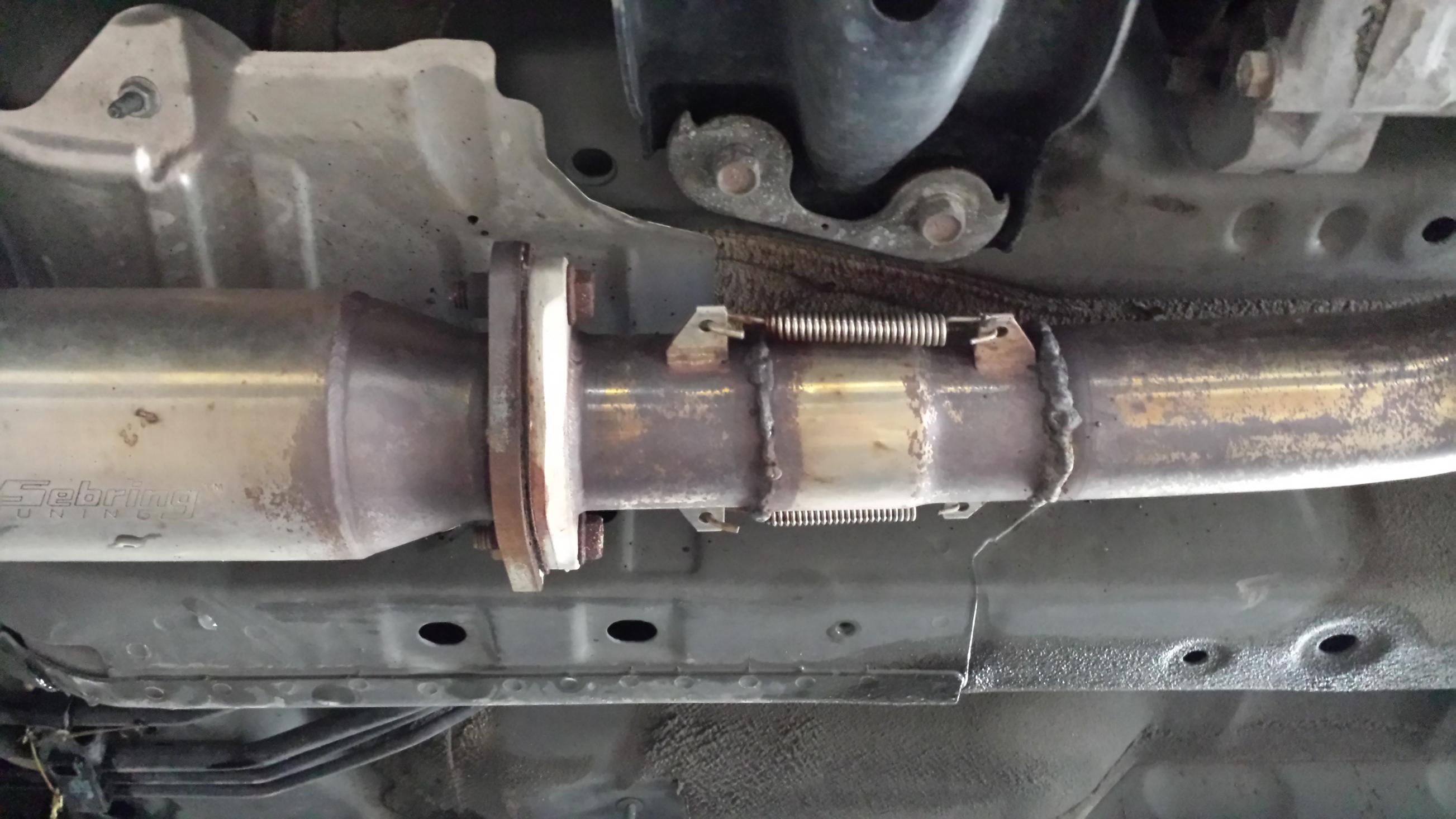

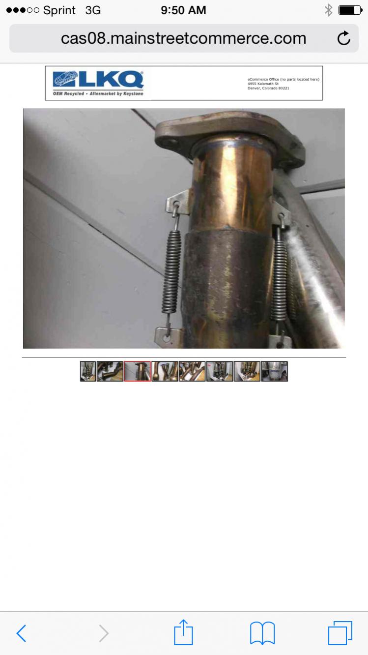

I just picked up this catback online and happened to notice an odd looking flex section, has anyone seen this style before:

that's the revised version. that's what i installed on my 2012 g37x. in my case, i had to flip the passenger side flex pipe to get it to go around the front differential. that's the invidia q300 right? the older version of this exhaust has the traditional style flex pipe that has the braided look. this one uses springs. completely normal. that's just the updated design.
Ah ok, so revised still doesn't mean it will clear on AWD? I'm not sure how you tell the difference between q300 and Gemini ??

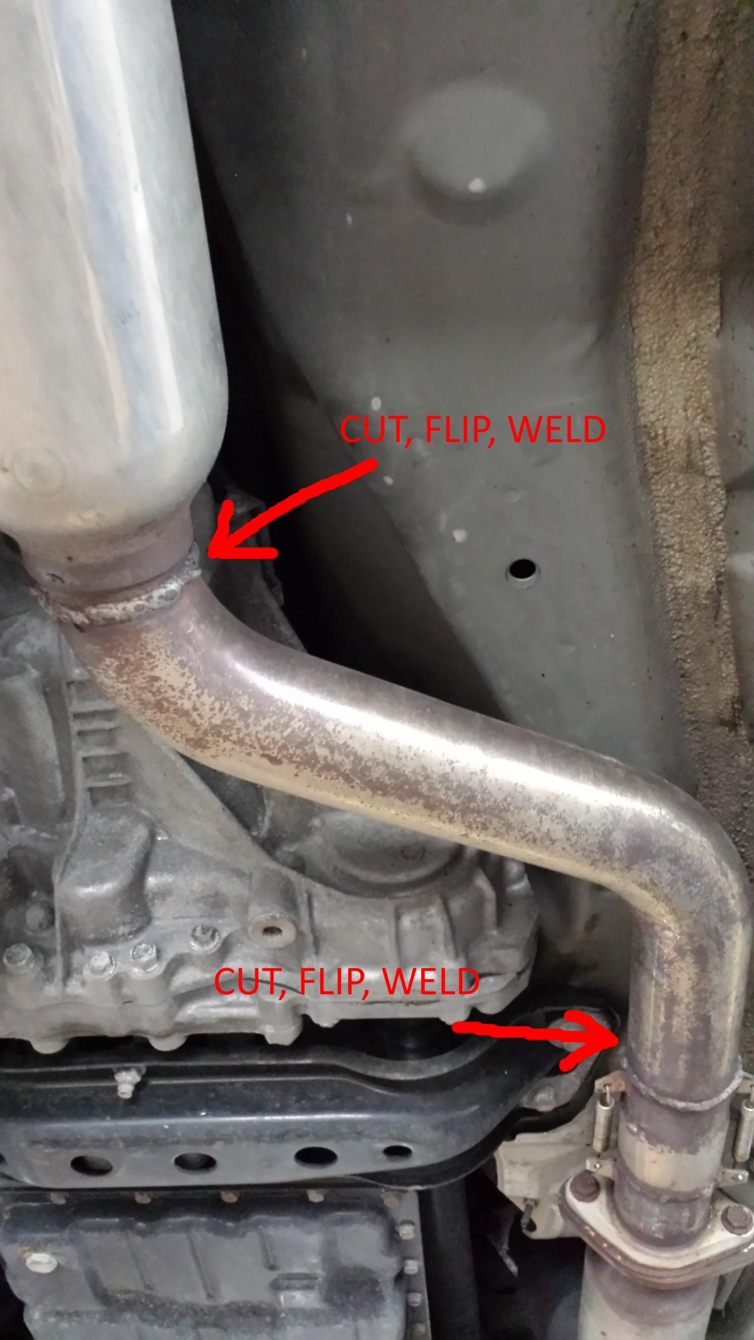

Yea invidia doesn't make an out of the box system for the awd unfortunately... Only a couple systems out there that are specific to the awd. You could do as I did though and modify it. Doesn't take too much extra work. Just need a good welder. I'll take a picture for you at the end of the week to show you how the modded piece looks like so it fits the awd. There is also an old thread on the forum that shows pictures of how to modify it. I'm responding from my phone though so I don't have it at the moment. My box said q300 so I'm not sure how you can necessarily tell the difference between that and the Gemini.
EDIT: found the thread I mentioned and it looks like you actually commented in it.
https://www.myg37.com/forums/g37-sed...k-and-awd.html
That's the thread that I saw before I bought my exhaust that let me know it was possible to fit the awd with modification. I just did exactly that. The only difference was the flex section design. They just look different that's it. So the pic you posted from LKQ has the updated flex pipe design just like my q300 exhaust system. When I get my car in the shop later this week, I can show you a picture of mine.
I hope this helps answer your questions though.

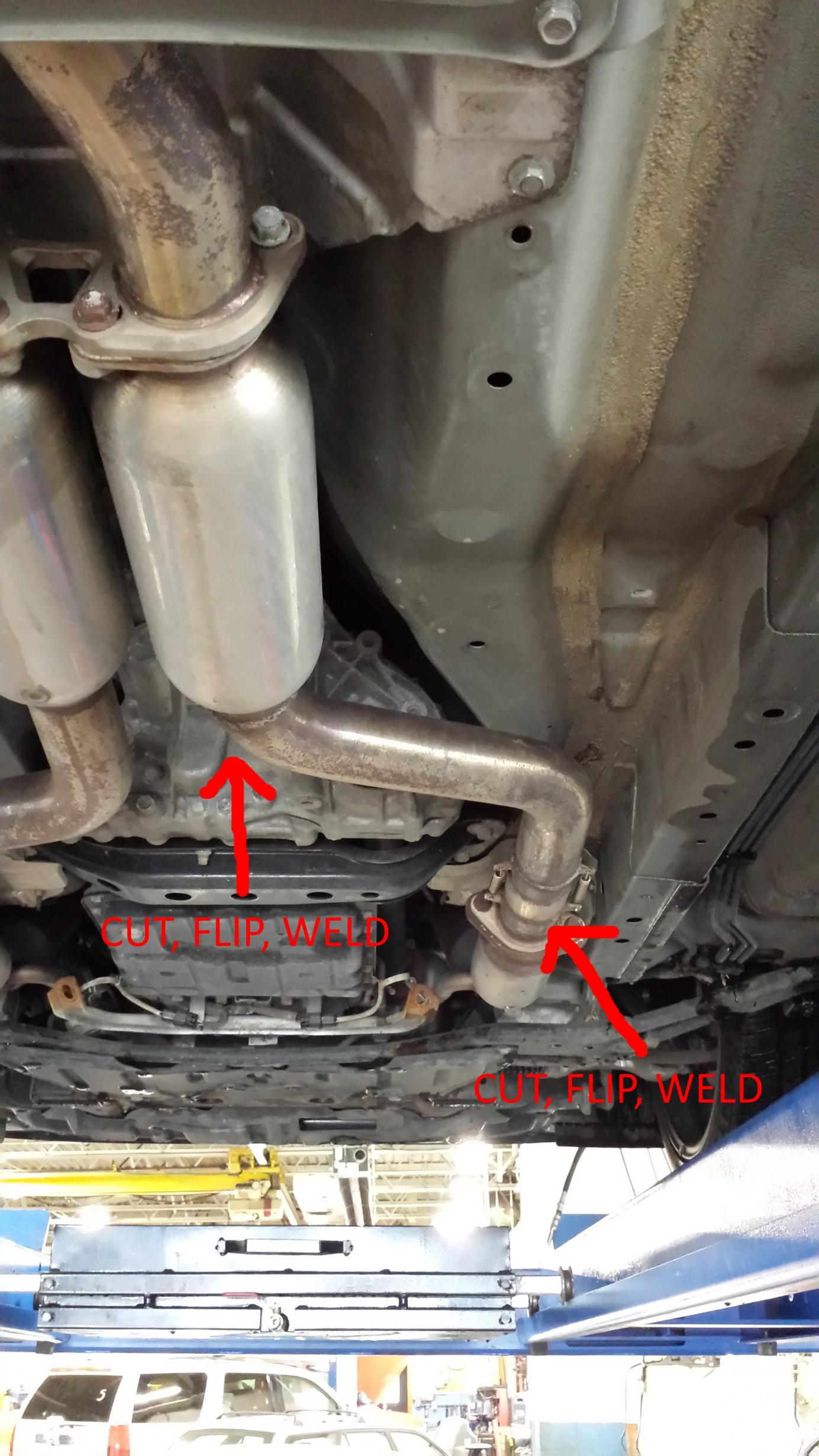

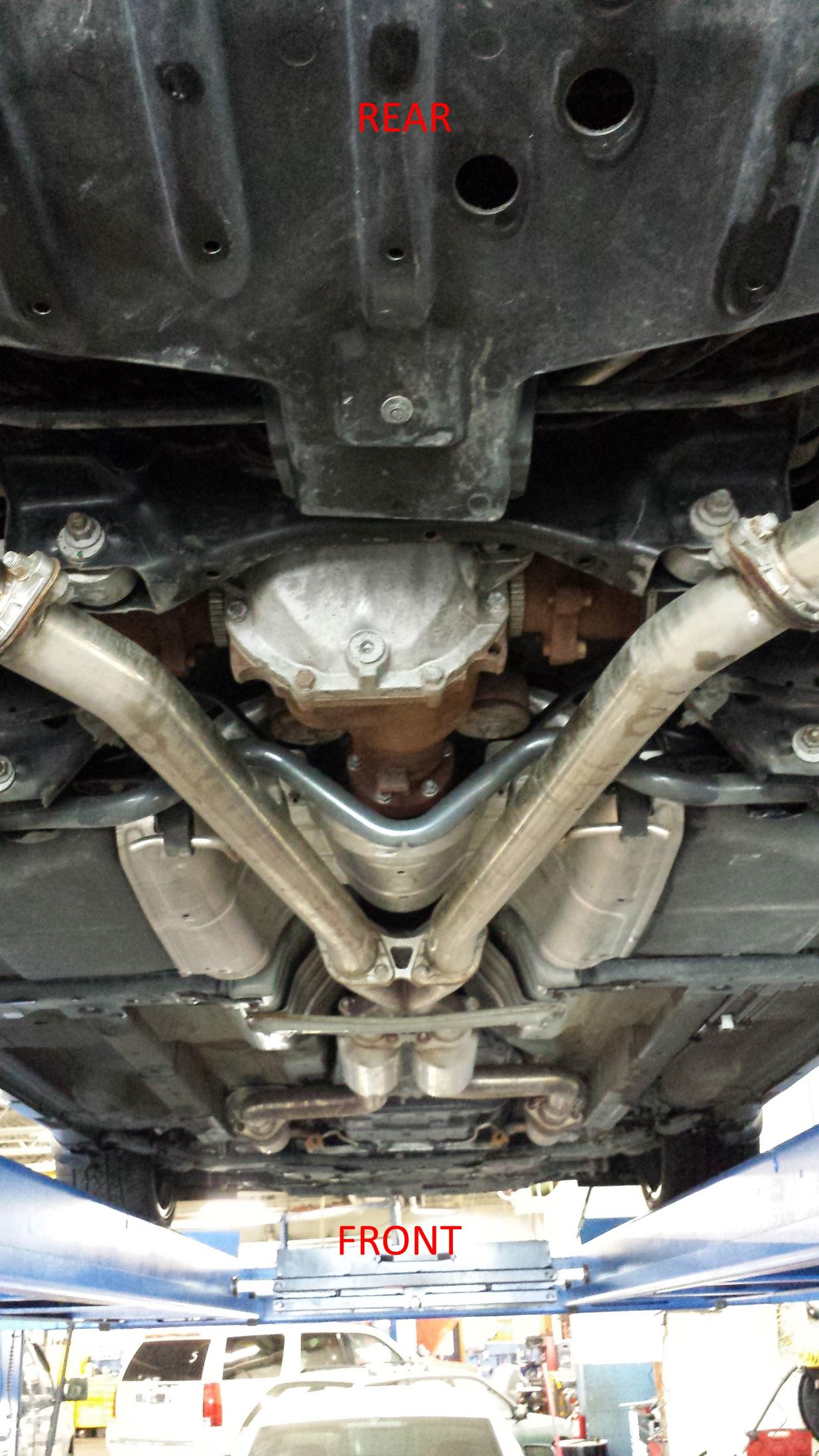

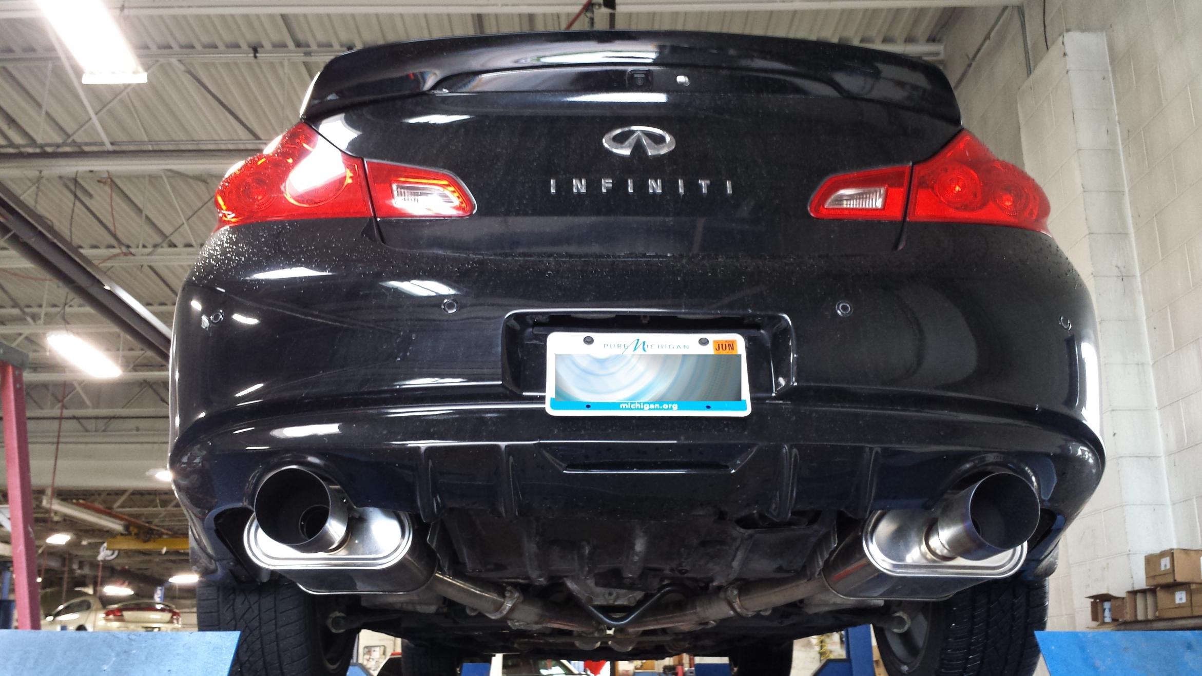

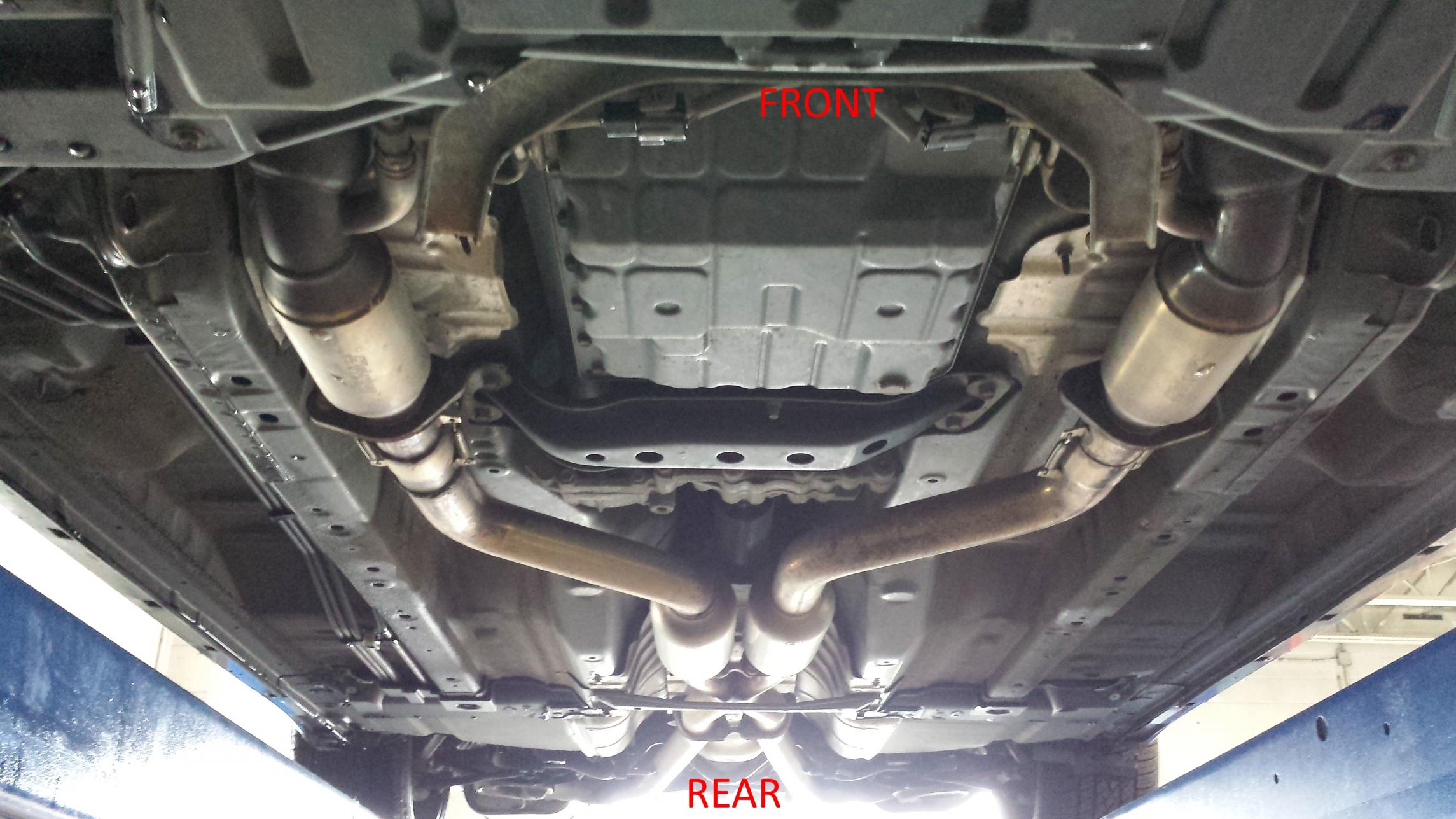

pictures as attachments
Attached Thumbnails Question about odd Invidia flex section-20150530_145827.jpg   Question about odd Invidia flex section-20150530_145837.jpg   Question about odd Invidia flex section-20150530_145859.jpg   Question about odd Invidia flex section-20150530_145913.jpg   Question about odd Invidia flex section-20150530_145950.jpg
Old May 31, 2015 | 07:18 PM
ay37's Avatar
ay37
Posts: 145
Likes: 21

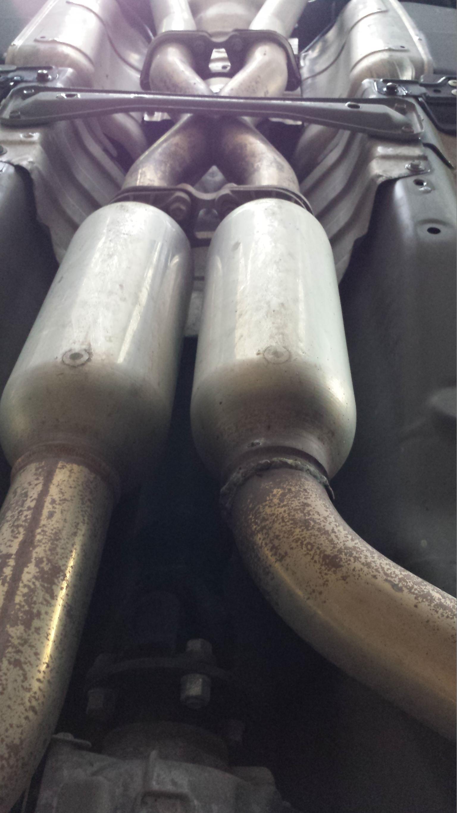

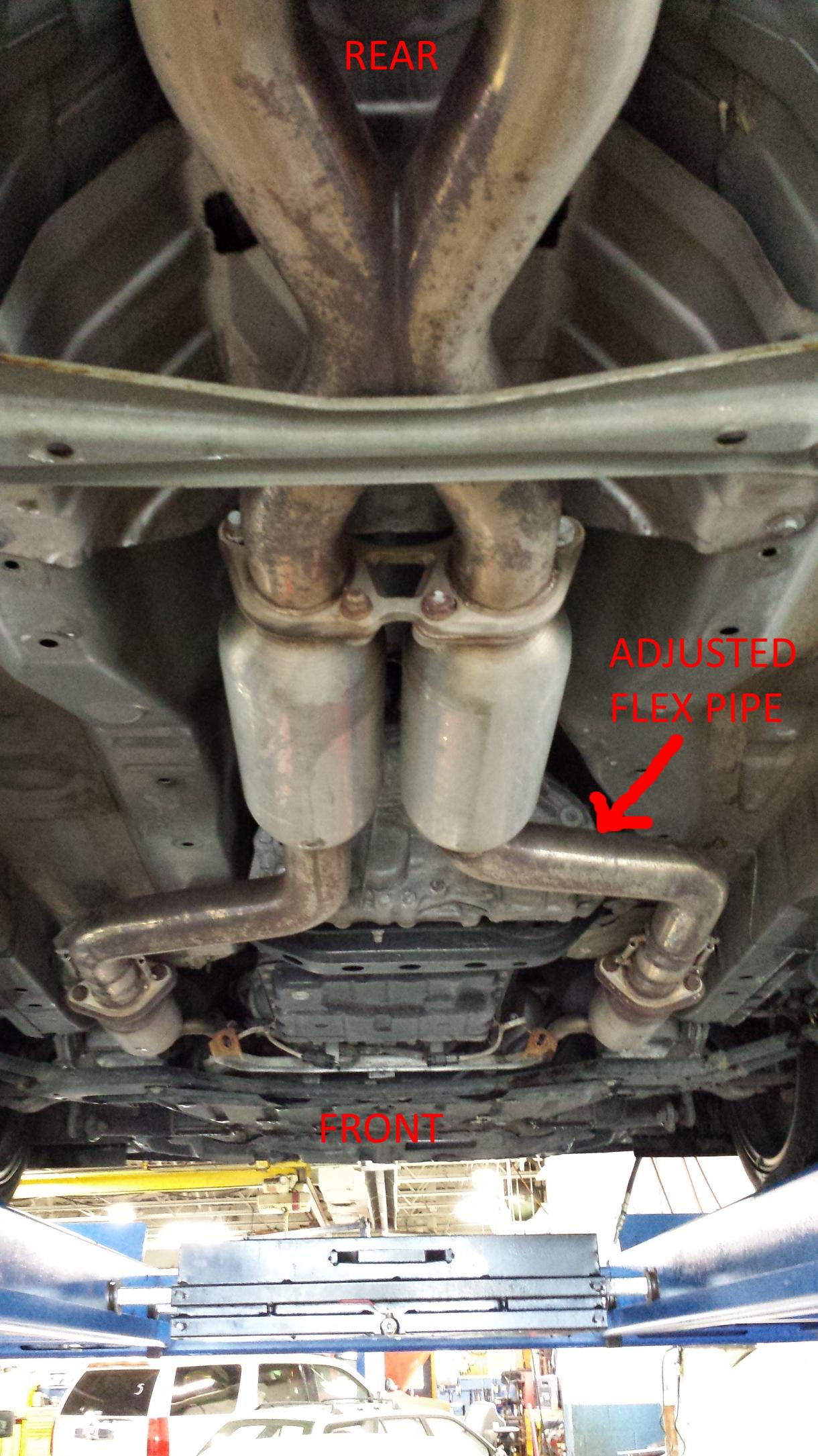

Here are three more
Attached Thumbnails Question about odd Invidia flex section-20150530_150024.jpg   Question about odd Invidia flex section-20150530_150038.jpg   Question about odd Invidia flex section-20150530_150152.jpg

sweet man thanks!

just to make sure I have the correct side pipe flipped which one came with the sticker installed on it? the driver's side??
all of mine were marked with a sticker. is your kit new or used like the photo you originally posted? if it's used, then the stickers probably are scraped off by then. best thing to do, is line it all up once you have the car on the lift. you can't mistake which pipe goes where really. then once you have it all layed out on the ground, you can begin to mount the driver side with no problems. once you get to the passenger side, you will notice the flex pipe can't bolt to the cat properly because the front differential is in the way, that's the one you want to flip. that's how i did it at least. i layed it all out on the ground, then matched up the pipes, aside from having a new system so it already had stickers marking which piece goes where.
