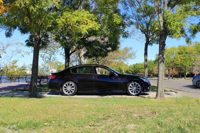

2010 G37xS
BC Coilovers
19x9.5 +43 Nismo Rays (Squared Set)

Looks nice. Are those bc's made specifically for the XS AWD sedan? How do they ride? I'm guessing u needed a camber kit right?

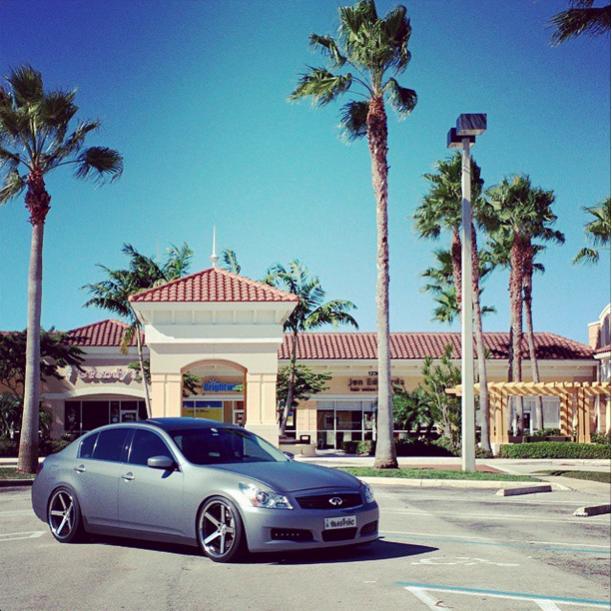

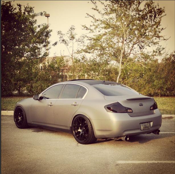

Both my setups are square.
20x10.5
lowered on D2 Racing Coils. with dampening set on the middle setting.
The first pic (older setup)
Stance SC5 +35 offset all around 275/30/20
The Second (Newer Setup)
Avant Garde M310 +25
Attached Thumbnails G37xs sedans - lowered with rim-screen-shot-2015-03-26-at-11.35.45-am.jpg   G37xs sedans - lowered with rim-screen-shot-2015-03-26-at-11.35.23-am.jpg

yes, both my setups run 275/30/20 all around.
my very first setup on my car was staggered.

love the whip and them rims bro... With them 20's lowered is there any rubbing when it comes to fenders?. i am trying to put 20s on my 2011 g37x sedan

when i had +35, i had to pull the front fenders,
After going with the +25, i had to get the rear pulled as well.
but then again i am running 275/30/20. if i ran 255, i could get away without pulling the rear fenders but the tire would have a great deal of stretch.

+20 is a coupe setup,... for sedans that is very aggressive. unless you want to drive with a lot of negative camber, i would not recommend +20.
My current setup were +20 and i had them shaved to +25 as when installed as +20, it was too aggressive.
