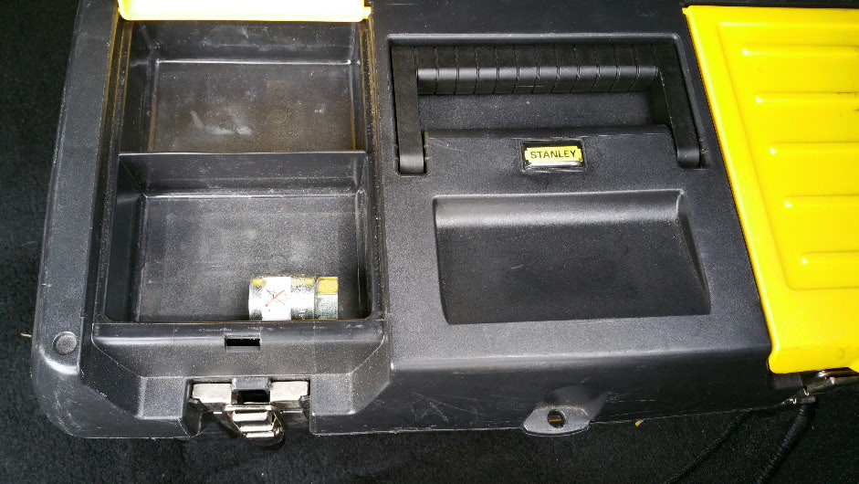

I found the noise
I sorta knew better than to assume before taking some troubleshooting steps, but I went and made a thread about nothing
Earlier, I mentioned that I'd need to empty my trunk and see if the sound was still there...well, the sound was coming from my trunk. I had a coworker stand outside the car and listen. He couldn't hear anything.
So he got in the back seat and heard it, but said it was from the trunk.
I started pulling things out until I got to my toolbox. That's when I knew what it was I typically store this thing in a compartmentalized box with my tire repair kit and a piece of foam to keep it still. I never put it back after I checked my lug nut torque.
The FIRST thing I should have done was empty the trunk...I know better. Anyway...let this serve as a reminder to anyone who stumbles on this thread...if there's a sound from the back, empty the trunk first...I'd even go as far as to remove the spare tire.
