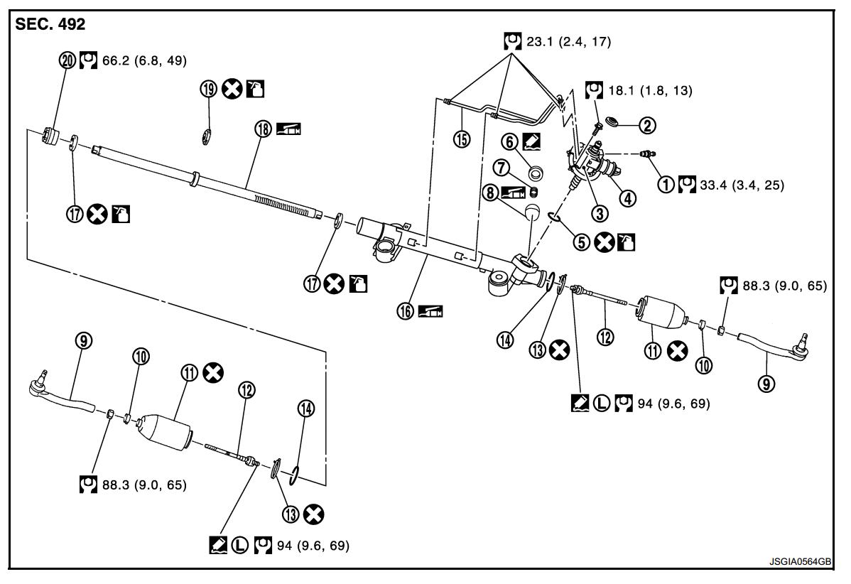

The alignment should be done as removing the rack involves transfer of the tierod ends from old to new rack. I believe our cars only have outer tie rod ends, not inner. Tie rod ends (item #9 below) adjust the toe setting, so an alignment should be done. In fact, I'd request a pre/post alignment printout.
