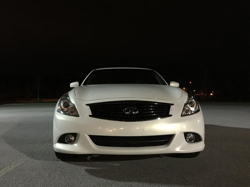

And, even though just about everybody on this forum knows what the difference is between the two bumpers, here's some before/non-Sport and after/Sport pictures.
Before/Non-Sport:
After/Sport:

And you got rid of those license plate hole plugs too.
Win-Win

looks real nice, color match is good too; also, any chance you are going to add a lip?

Thanks. I've researched lip options and am leaning toward the Carbon Signal Spec IN lip. I'm probably in the minority here but I don't really care for the OEM sport lip.
