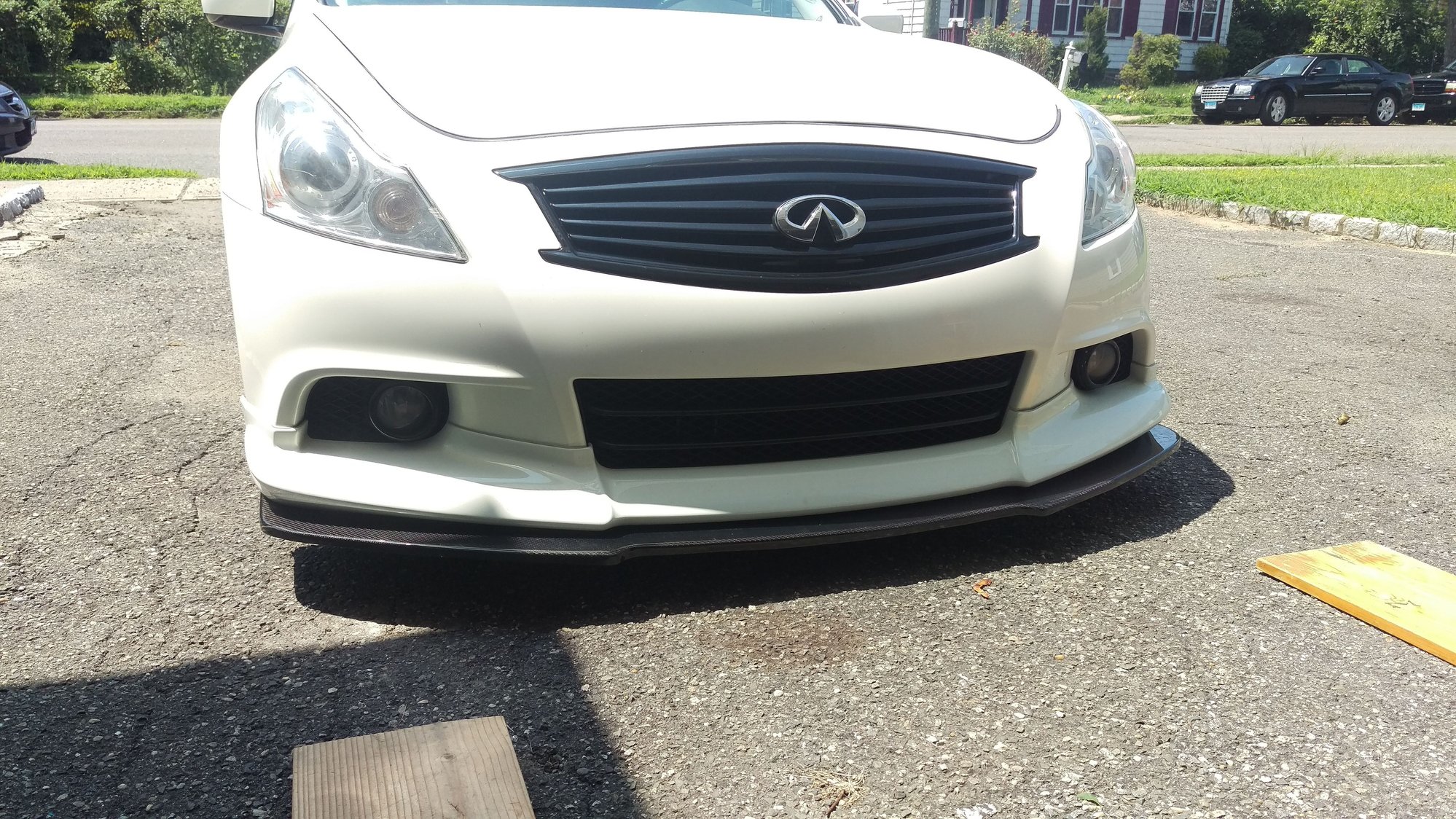

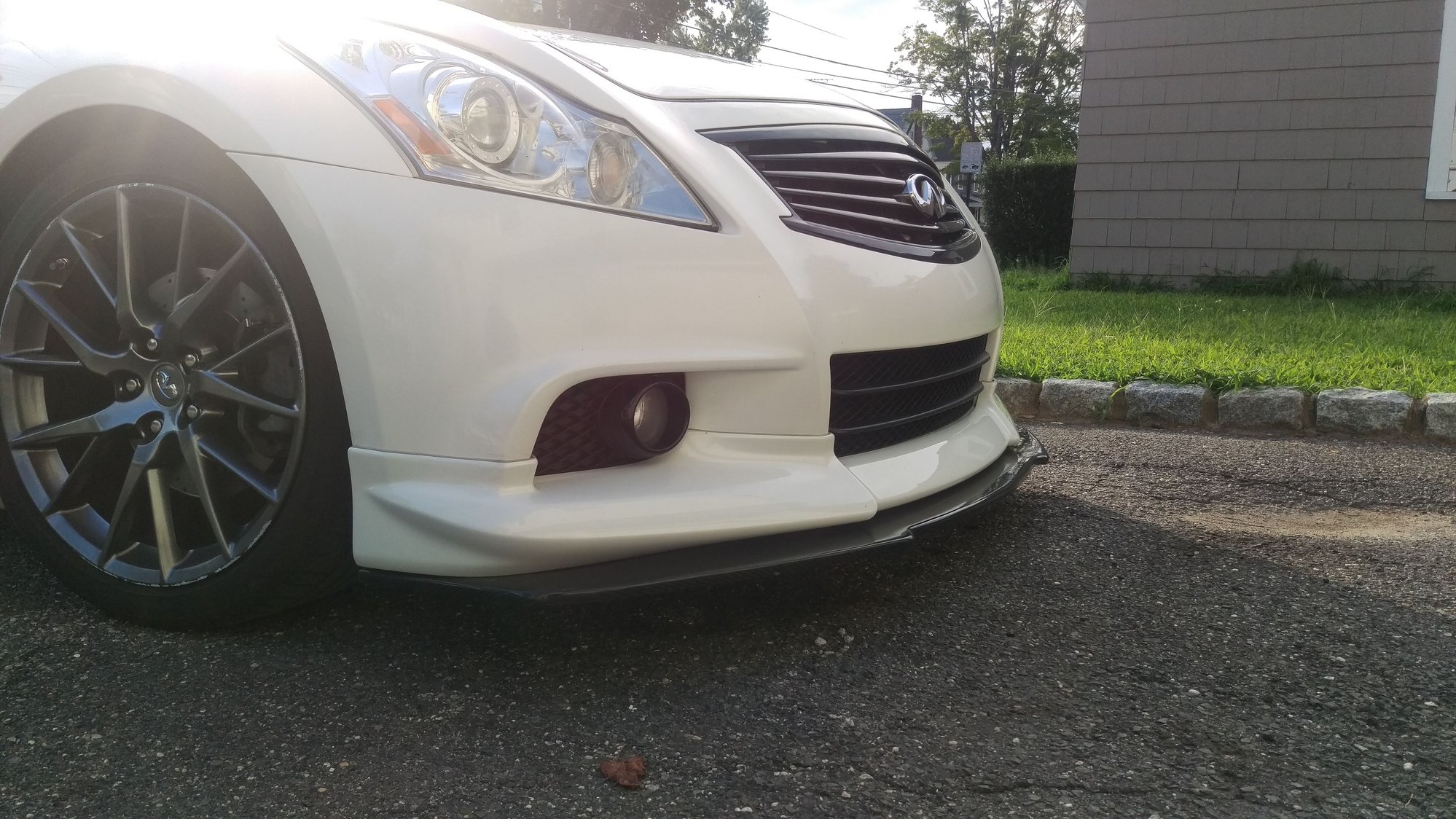

Sport bumper swap complete with splitter
looks very nice! where did you get the splitter? is there one for non-sports?
Thanks, splitter is from R1 autoworks and no they don't have one for the non sport sedan
