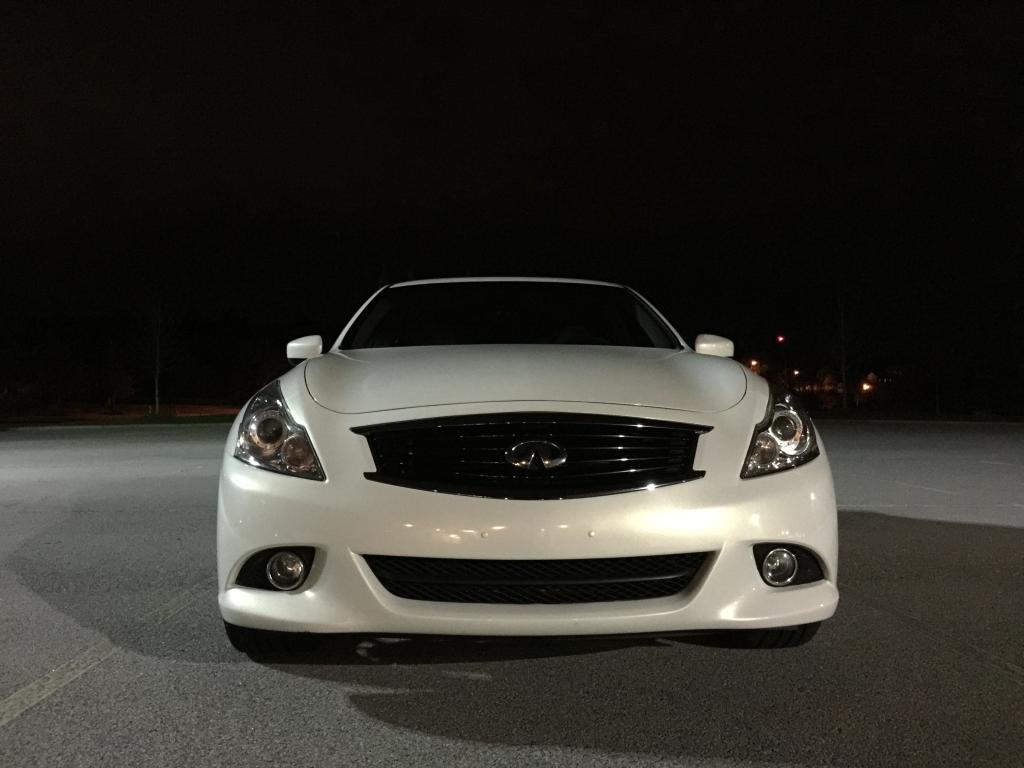

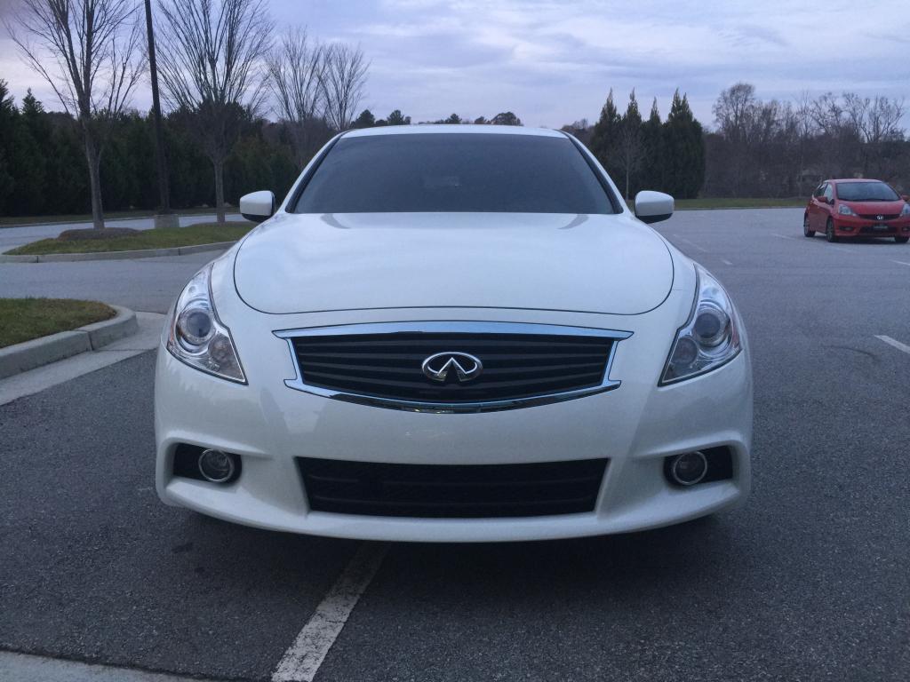

And, even though just about everybody on this forum knows what the difference is between the two bumpers, here's some before/non-Sport and after/Sport pictures.
Before/Non-Sport:
Attachment 141399
After/Sport:
Attachment 141400
