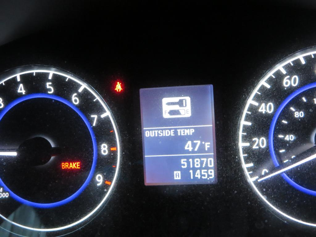

Mine does!
A day after I read your post this popped up on my dash
Stopped by a nearby Batteries Plus. They measured the voltage on the original 3v battery and it read 2.8v
I had them them replace batteries in both key fobs which are now 2 1/2 years old
No more problem
