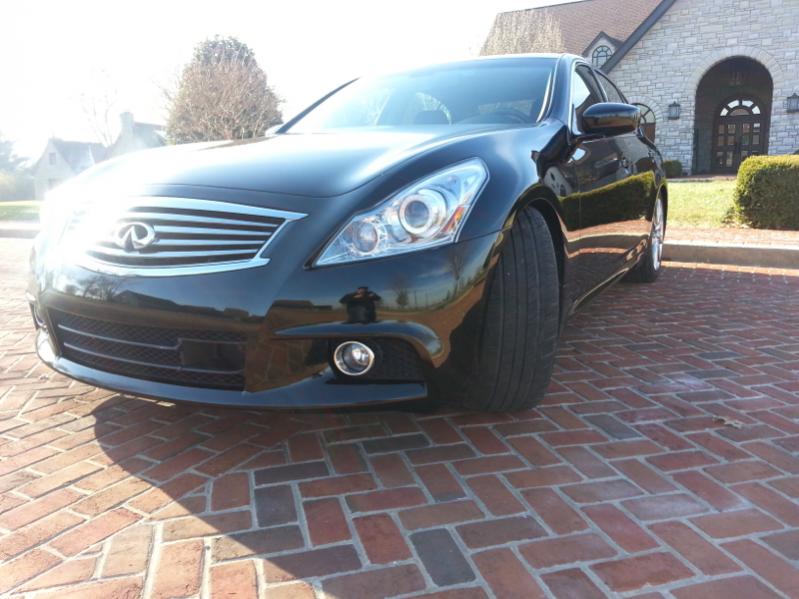

Good choice, just don't expect not to lose cruise. That is still an unknown factor as to why some lose cruise and some do not. My theory is that if you have icc(intelligent cruise control) you will lose your cruise. I do not have that feature on my car and still have cruise. Just FYI.
How do I know if I have ICC?
You'll have the cut out in the front bumper, see attached.
I see. I guess I don't have that.
