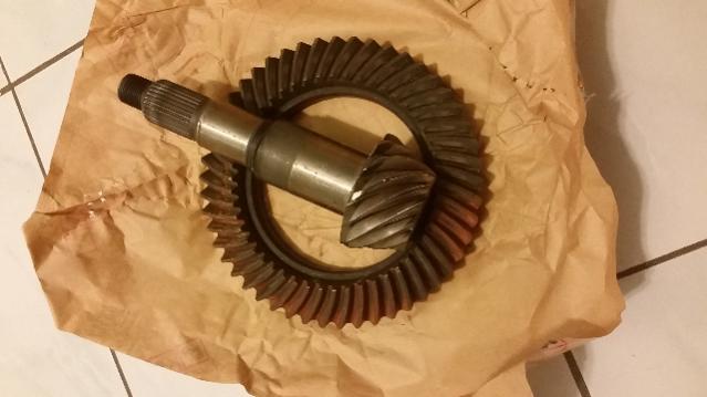

AT or 6MT? Start a thread, chronicle the process and results.
6mt coupe. Should be a direct swap. No other parts necessary besides oem seals and bushings but I'll start a thread when I'm installing the gears. Look at those bad boys waiting to kill some tires in first gear.
