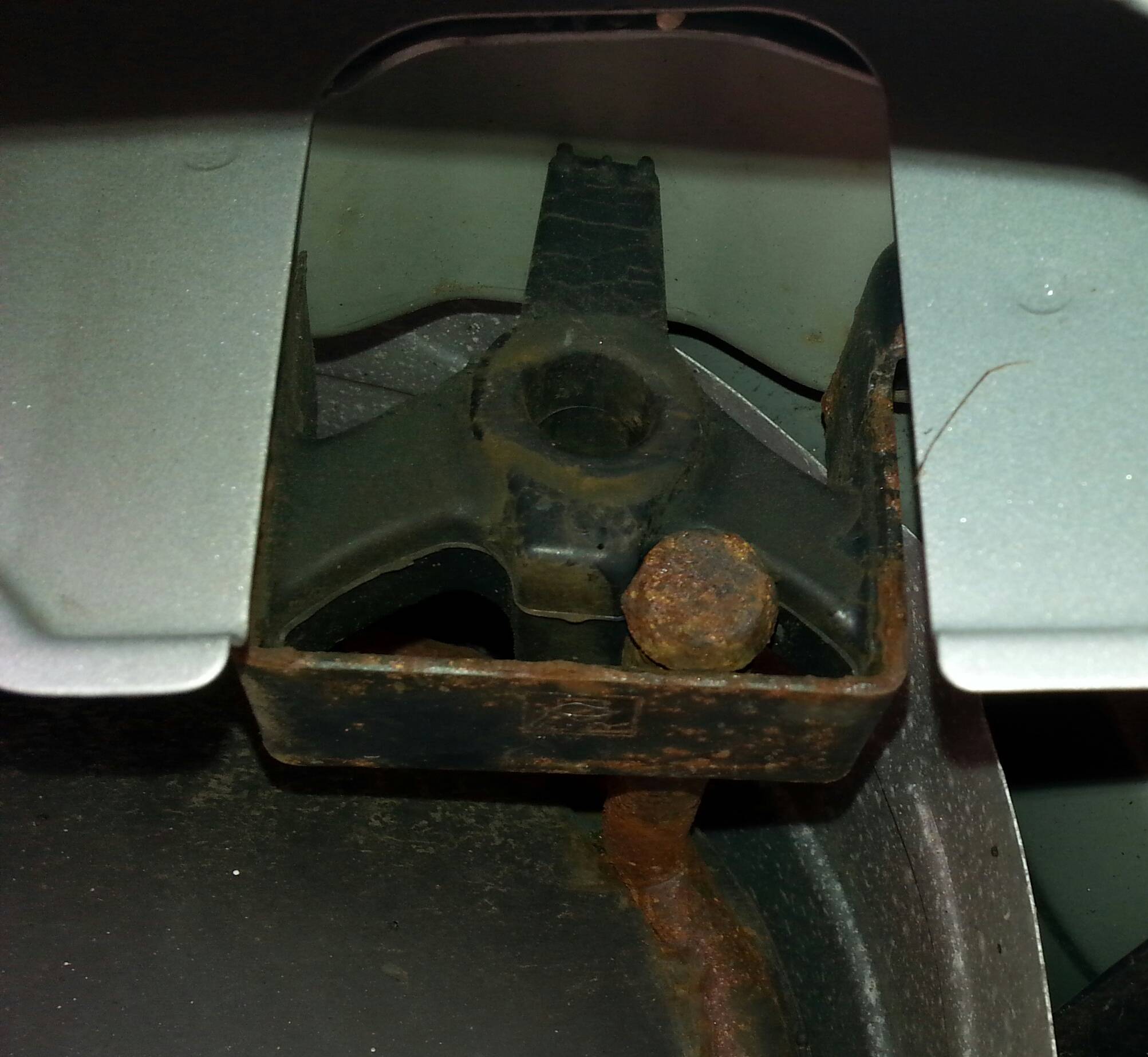

https://www.myg37.com/forums/g37-sedan/262889-stock-muffler-mounting-holes.html#post3843656
I'm hoping this was what I was hearing and now that I fixed it, I hope not to hear that sound anymore.

I haven't heard it since I fixed the muffler mounting (Tuesday). I think it's done. By the weekend, I'll be 100% sure. Other sounds from the rear have also stopped.
