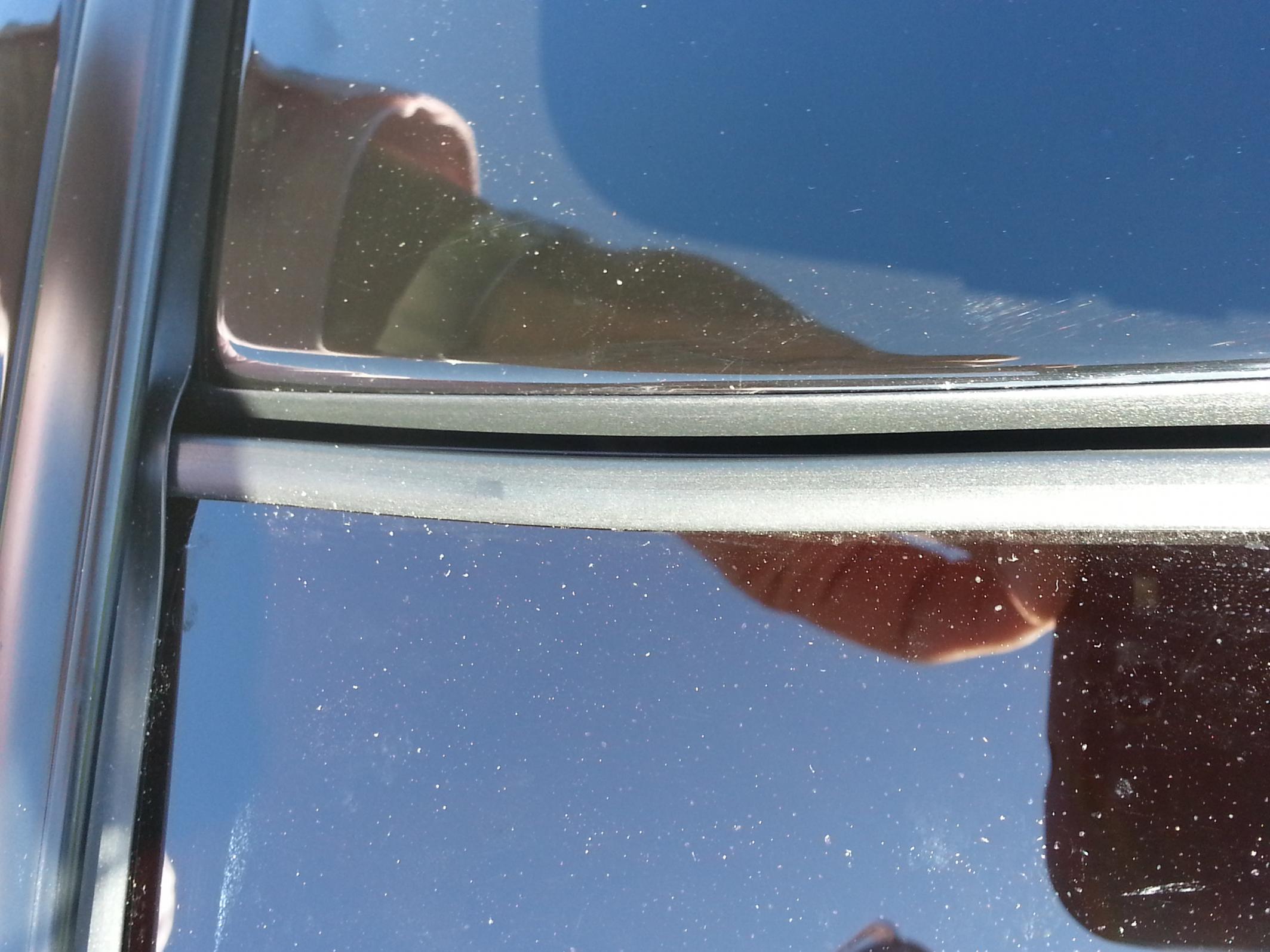

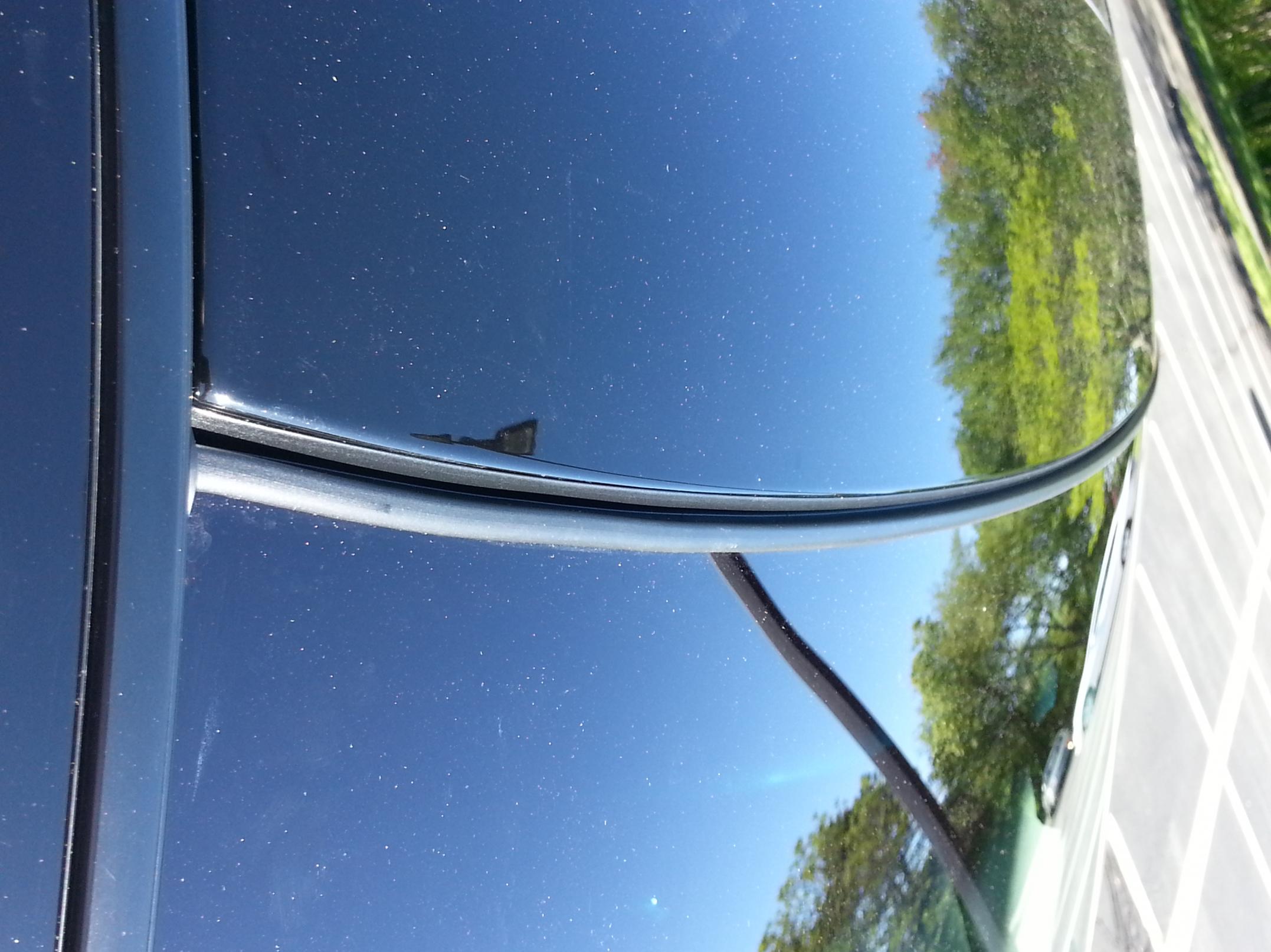

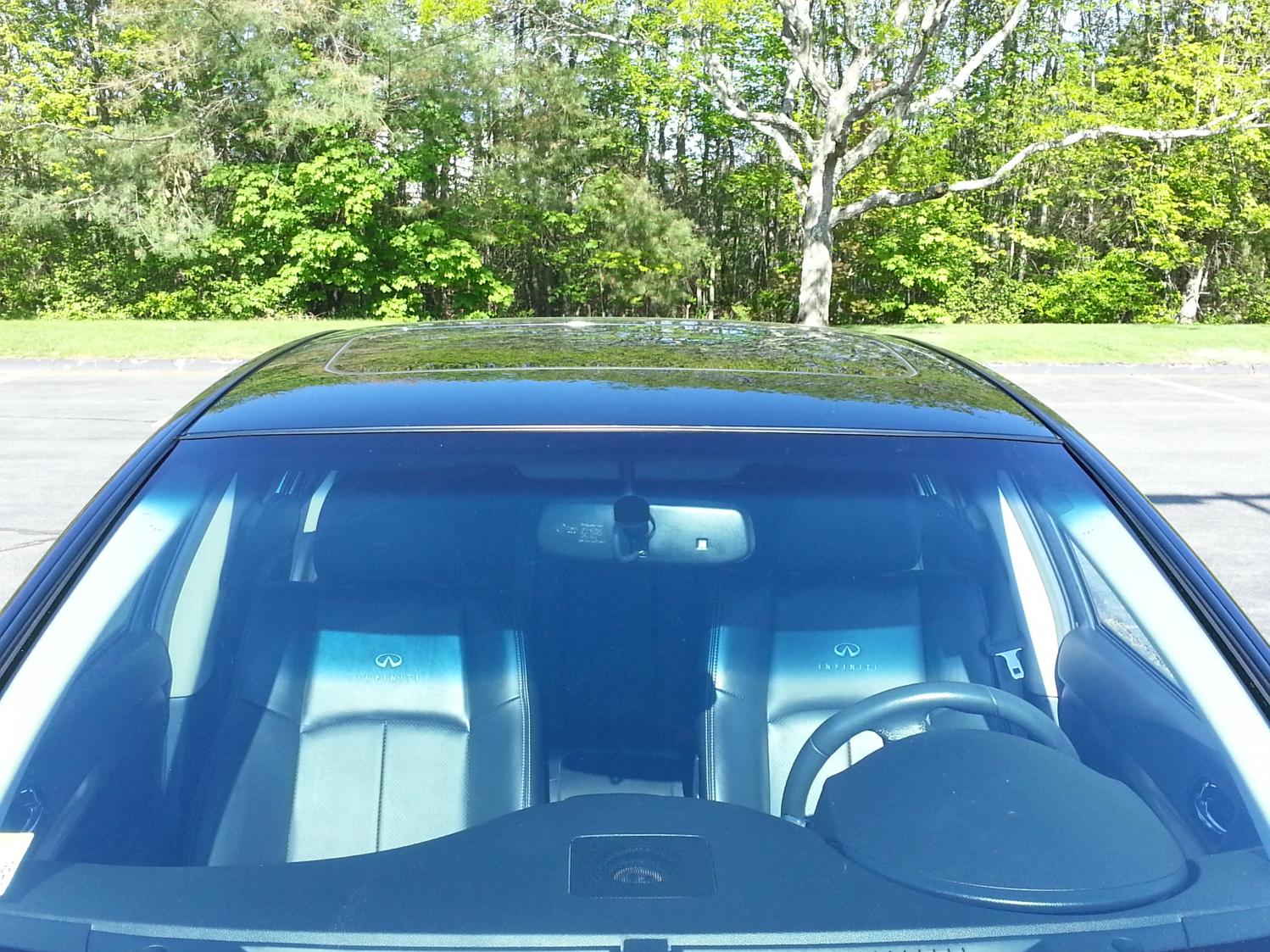

New windshield, does this gasket look odd
Old May 20, 2014 | 09:57 AM
Zack342's Avatar
Zack342
Joined: Aug 2005
Posts: 231
From: Quincy, MA
I am now worried it is going to channel water into the a piller
Attached Thumbnails New windshield, does this gasket look odd-20140520_083139.jpg   New windshield, does this gasket look odd-20140520_083156.jpg   New windshield, does this gasket look odd-20140520_083204.jpg

were's that gap? On the sides or the top? Either way looks wrong??
Are the side gaskets at the windshield gapped also or is that a shadow?

it has a "v" groove. i've been fighting with the insurance about it all morning

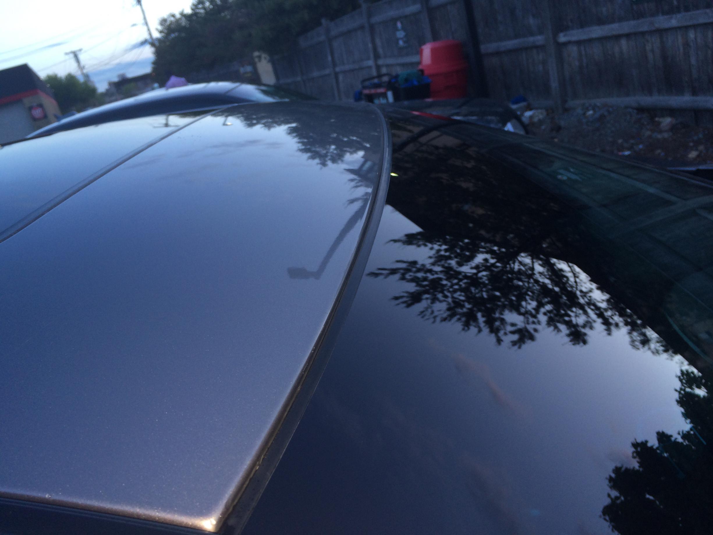

The gap is too wide. I had to get my windshield redone a second time because of this. I had the guy push up against the windshield to close the gap. I'll take pictures for you.
I got mine done at satelite from Saugus, ma.

I've replaced windshield on both a coupe and a sedan. The trim around the new one should look exactly like the one they removed. What you have there ain't right.

I PM'd you back. You should try again to contact the shop who did your windshield. The only way to fix this is to remove the windshield and replace it with a new glass with new adhesive and have them push up hard against it to close the gap. You should explain to them how you're unsatisfied with the work and the glass is not flush with the body. Good companies should be able to replace the glass without any fuss. Also, try to see if you can find other excuses to have the glass replaced. I also added on excuses like "the glass is distorted/wavy" and that it made me feel dizzy while driving, which is hazardous and a safety issue. Can you find any waviness in the glass? It is easy to see by just focusing an object at an angle through the glass and move your head to see distortion.
The glass company could possibly scrape off the old glue on the glass and reapply the windshield but I wouldn't recommend that since the adhesive is very difficult to scrape off.
You should also make sure that the VIN number is visible through the windshield. Sometimes since your gap is too wide, (thus your windshield is sitting lower) the VIN number is partially covered by the windshield.
I'll clarify what safelite did the second time. The technician took off my already new windshield using the "safelite-proprietary" scratch free wire adhesive cutter, and replaced it with another BRAND NEW windshield and reapplied new adhesive after scraping off old adhesive from the car. During the install, as he was placing the glass onto my car, he placed it higher up and also pushed it upwards to make sure the gap wasn't there after he put it on. The urethane adhesive dries pretty quickly so you only have a little bit of time to readjust the windshield before it permanently sets.
Also, can you take a picture of your pillar molding on the side of the windshield? I can't be sure, but it looks like the molding for the pillars isn't on right, like the molding is not sitting flush with the windshield and there is a gap there too.
