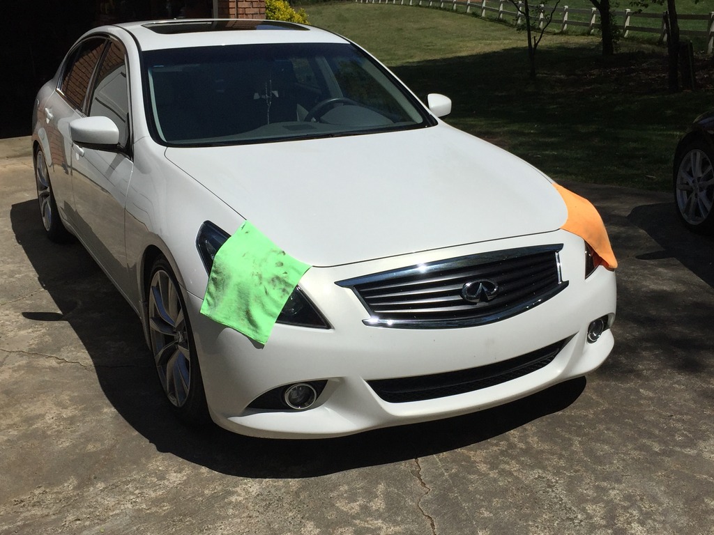

Hey guys, so I know many of you know about the bubbling in the headlights after modding them. I confirmed that it is indeed the sun beaming off of the project lens. I'm going to do this until I decide on what I need to do. I hate over lays but I'm think it can help. Maybe tinting the outside will weaken the sun before it gets to the projector lens. What do you guys think?

I had my car on Ramps yesterday while finishing my exhaust. We'll having the rear a foot higher in the air changed the angle of the lens. So I watched to see what would happen. At the hottest point of the day. There was a beam bouncing off the lens on to the black housing that was so bright that I couldn't even see the black paint underneath it. I covered the sunlight with my hand and here was a perfect bubble in the shape of the glare/beam. It goes past the ribbed part too. I think the factory chrome bounces the reflection off again and dissipates heat. Painting it black just makes it take in all the heat I guess :-/ FML

Perhaps it's as simple as putting something over the lenses if you're forced to park it outside on a hot, sunny summer's day. When I get my lenses painted, I'm definitely going to remember this.
