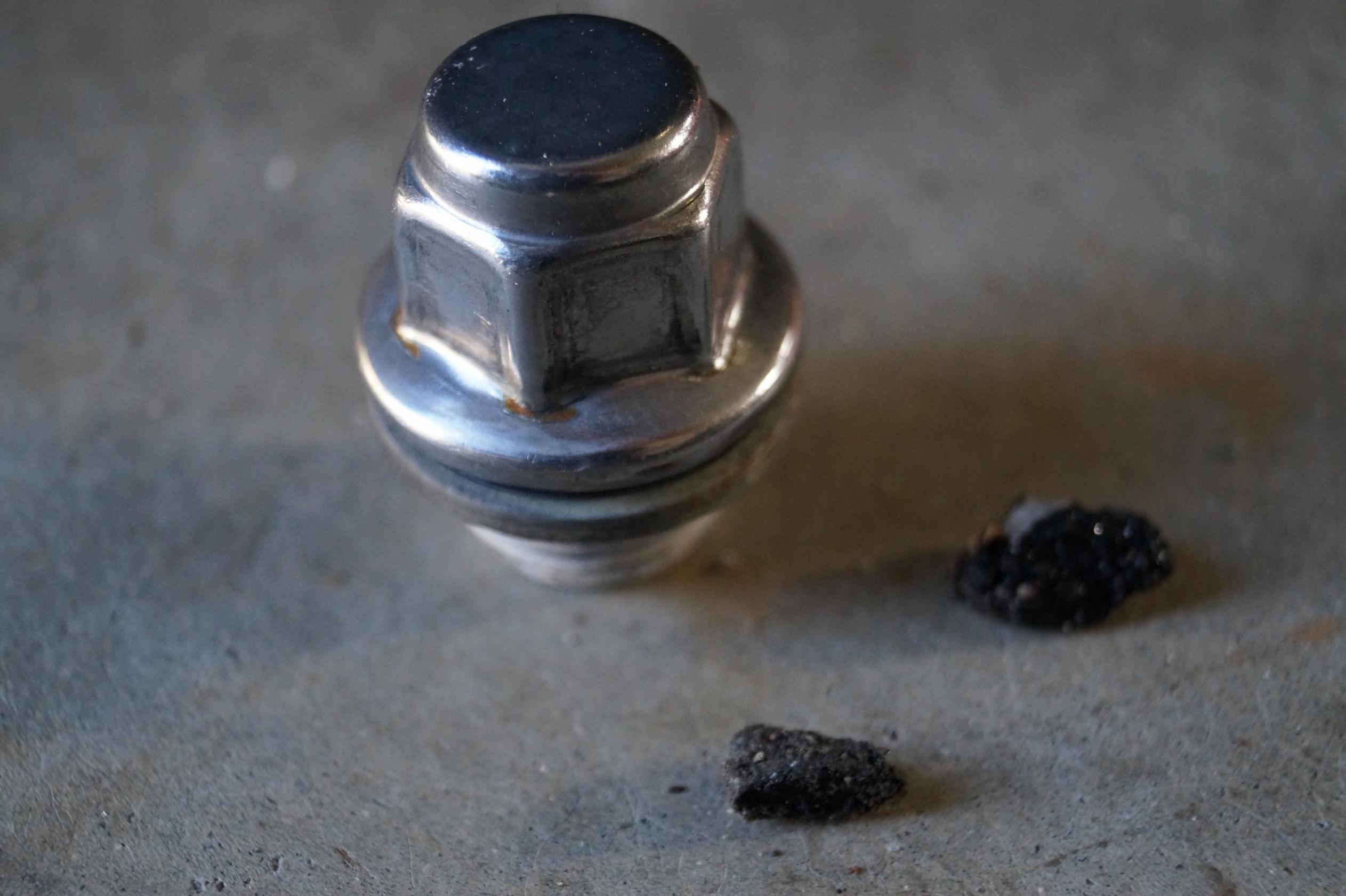

On Friday I noticed my car making a grinding type noise whenever I turned the wheel left. I could only hear the grinding at certain steering wheel angles. Took a look in the parking lot at work, but didn't see anything.
Pulled the wheel yesterday, and found 2 pebbles, lodged in between the lower A arm and the dust shield. It was contacting whenever I turned the wheel. They were still sticky, so I must have picked them up driving through a construction zone. Noise, eliminated
Scary, isn't it? Those dust shields can make a heckuva racket when something's stuck in there.
I bet the situation has made brake shops a lot of free money, too.... so good for you fixing it.
I've been picking those stupid things up lately but they've been getting stuck on the inner barrel of my wheels ugh! hate it because if I don't get them off on time they leave a little stain.
