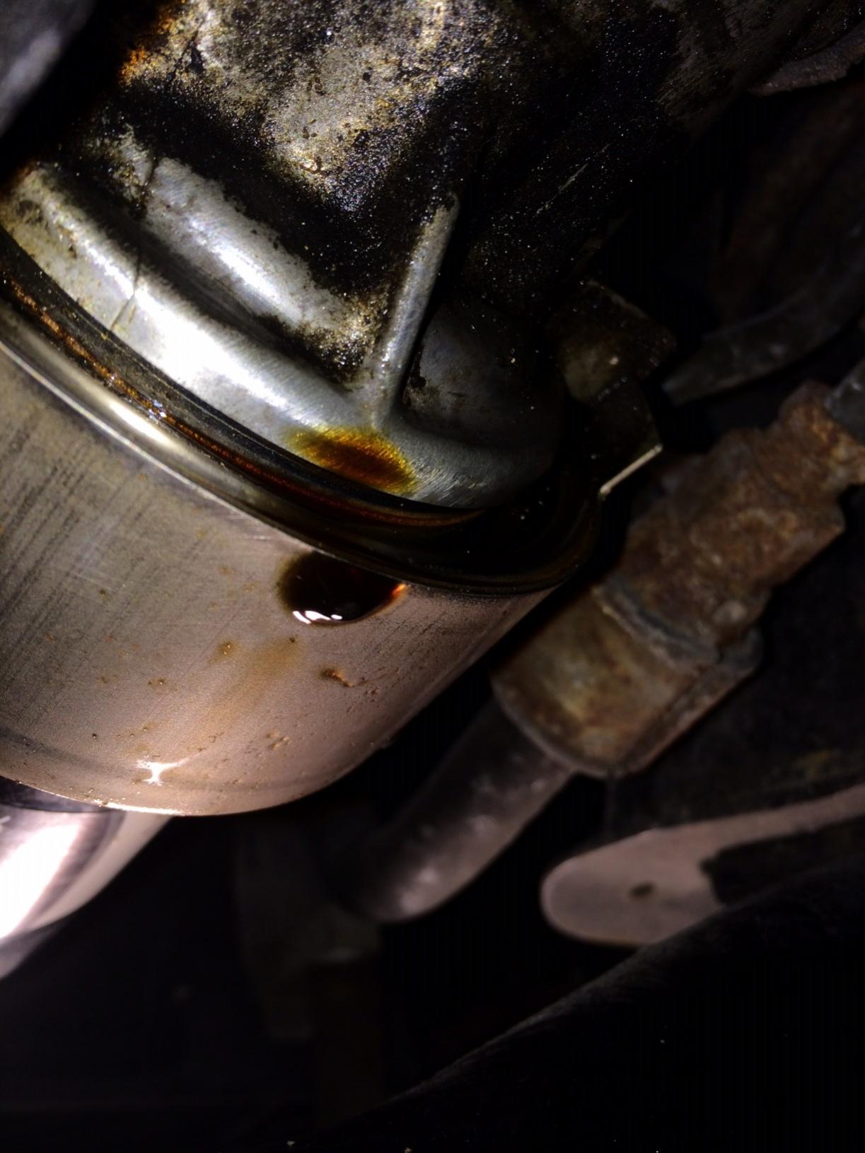

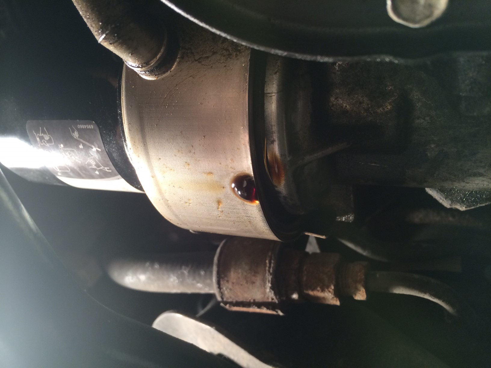

Was wondering if anyone can help me out with an oil leak that i have coming from the area that the oil filter attaches to. My brother drove my car while i was out of the country and hit the concrete slab in a parking area of rite aid and tore the under shield and possibly hit the oil filter. The oil leaks a few drops (3-4) while the car is being started. I lifted the car and tried see what i can do but i couldn't really figure out what to do. It is right behind where the oil filter is screwed into. I attached some pictures if someone had anything similar to this and any advice is appreciated.

Tracing down oil leaks can be difficult, especially when everything is dirty and greasy from the leaking oil blowing back as you drive. You might try spraying it off good in a car wash and then starting it a few times. It looks like it's leaking where the steel filter adapter meets the flange on the aluminum casting but really hard to tell. You probably need to disassemble that joint and try to see if the steel part is deformed at the sealing joint, or if there is other damage present when you open it up. There are no obvious curb scrapes that I can see in the pictures, but the underpan could have prevented that while still allowing distortion of the steel adapter.
The general rule is - with hard impacts, steel bends and distorts, cast aluminum is much less ductile and usually cracks or breaks.
