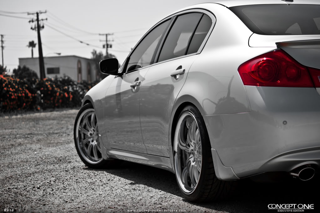

This is a pic of a fellow board members sedan that is pretty flush, just fills the wheel well nicely. Offset is the number that indicates how the wheel will sit in relation to the hub....extended closer to the fender or sunken further in.... Do some reading and look at all the pics to figure out the look you are after. The VMR V170's (not the wheels in the pic above), 8.5" wide with a 35 offset were just a suggestion that would get you new rims ($1000) and tires close to your $1500 budget that would be a square set-up (same all around) that would sit fairly flush with no poking out and no need to run negative camber to fit.....conservative but nice fitment. I went with this set-up after a lot of looking.
Lowering is a personal choice, Swift Springs make a set of lowering springs just for the "X" models, mild drop but it make a big difference in appearance and does help the handling a bit. BTW - Install of springs on the X is super simple. Most people here will encourage you to drop it for the proper look and sometimes to allow more negative camber to tuck a more aggressive width/offset wheel. Still greek?? Just read everything you can and you will get it......or ask.
As far as exhaust, I think mine sounds good as is. It is my daily driver so quiet is good but it does growl when i step on it. Yours may get a little more aggressive with a few miles on it. There are always aftermarket options too.
